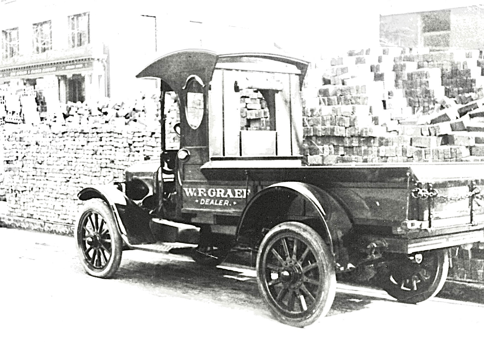

				Hello All, The attached photo is a Model T truck used in a business by my Great Grand Father.  I would like to know more about this vehicle.  Is there any way to tell when it might have been produced? Stock or modified? Conversion kit?  Etc.  Many thanks for any replies.

				It is an early truck, with the 23" rear wheels.  The body is custom/aftermarket, so
it was delivered as a bare chassis to either the customer or a body shop to be outfitted
as you see it here.  Beaded axle housing ends could nail it down tighter, but the under-
-side detail is just not visible.

				Thanks for that info.  That it was outfitted on a bare chassis explains why I did not see any similar photos.  I really like the way it looks as it's so similar to a modern pick-up truck.  By "early" does that mean say before 1920?  What is considered early?  I wish I had more photos ...

				I don't believe it's a Ford - fenders, rear wheels and third member not.

				The truck body looks similar to the body on my 1918 Buick E-4 light delivery truck.  The body for my truck was made by The Palmer Body company.
If you want to look at the truck, let me know.

That truck is almost definitely not a Ford. The fenders are wrong. The wheels are wrong. The front axle is wrong. And the steering wheel is at the wrong angle. There would be a very slim chance it could have been a custom built extended chassis 'Form-a-truck' on a Ford chassis? But that would be a VERY SLIM chance.
There were literally hundreds of small manufacturers of trucks. Many of them catering to local markets and not well documented. That it could be a Buick truck? Very possible, before 1920, Buick built some very nice small and midsize trucks. Not many of them exist today, and they are mostly forgotten today.
