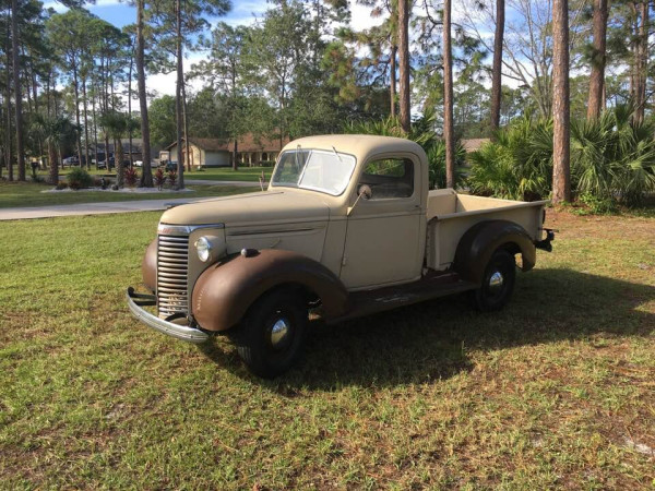

I have a 1940 Chevy truck that I allowed to sit to long and now the clutch is stuck, This happened last year also but it freed up quick just by warming up the truck and driving it with the clutch pedal pushed in. This time it didn't work. Any ideas on how to get to come loose?. Oh, I'm try to swap it off for a 64 to 68 Mustang for my wife if there is any interest.

You might try loosening the transmission to bellhousing bolts a couple of turns, then holding the pedal down and rocking it or hitting the starter. I think some Chevrolets had the bellhousing bolt heads inside the bellhousing, so that may not be easy to do. If you can access the bolts, loosening them a little then applying torque with the pedal held down will usually break a stuck clutch loose. Another trick is to remove the clutch access pan and wet down the clutch assembly with water, then try the pedal down procedure. If you can reach the pressure plate bolts, loosening each one about 2 turns, then doing the pedal down operations might free it. Be sure to re-tighten the pressure plate bolts evenly. Clutches usually stick due to rust. I have an older Kubota 16 HP diesel tractor, and it came with a wooden block for holding the clutch pedal down when the tractor was stored to prevent it sticking.

That often happens with tractors. I would put it in 3rd with the clutch held down and rock it back and forth. If no luck you could try to start it in 3rd with the back wheels off the ground and with clutch depressed jab the brakes until the clutch breaks loose. Use caution on second method because (obviously) if it drops to the ground don't have anything in front of you! Second method could be risky so really plan it well or just skip it and go with tear down.
I would find a way to store it with clutch pedal depressed after you get it disengaged.

So far I have tried just warming up the engine, Driving in circles in the front yard and jerking the throttle. I also tried jacking up a back tire and applying brake pressure but that so far has not worked, I'm soaking with WD40. I'm busy this weekend so next week I'm going to try and start it in gear and pull my modern truck down the road with while my wife gives some light braking. The bolt from the clutch assembly to the plate are easy to get at so I might like you said loosen them a couple of turns also. I'm certain it will free up, Its just stuck a little harder than last year. I keep the clutch blocked down with a 2 x 4 on the steering wheel. Next summer I will keep the pedal blocked down. Its interesting, I drove that truck just two months ago to show it to a guy that had a Mustang, The wife didn't like the car so we drove the truck home. That said we have had a lot rain in the last two months.

Adjusting the clutch linkage to push the pressure plate fingers farther might help, too. (If you try this, re-adjust the linkage to the correct setting, if and when the clutch frees up) Adjust all the free play out of the clutch linkage and then do the driving with the pedal held down procedure again.

We used to free them up by holding the clutch down in low gear parking brake engaged and bumping it with the starter. Then we learned if the truck was going to sit for awhile we made a wooden block to keep the clutch pedal depressed never had a stuck clutch again :D

Is it possible the throw out bearing has failed an is not releasing the pressure plate? If it worked fine 2 months ago and not now , that may be the problem. Les

Failure of the throwout mechanism is a possibility, but it will usually show up by a slack pedal. Once in a while, a problem within the pressure plate can cause drag or failure to disengage. But in this case, it's most likely that moisture has caused the friction disc to bond to the flywheel face.
