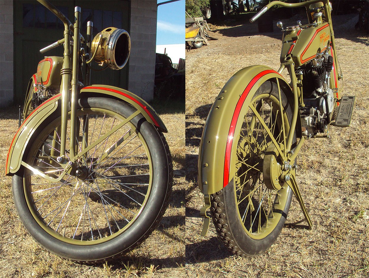

I showed this before and still haven't set down and located the before pics.
My cousin's 29 J-D 1200, hopefully this summer I will get to see it completed and ride it with the sidecar.
I got it to the state it's in shown. I disassembled everything and had powder coating done and he had the sheet metal painted somewheres else.
Engine was supposed to have been rebuilt and not started. We needed ignition parts to fire it up and he felt he could handle it from there.
Cousin Phil. Phil has a 15 touring he is thinking about putting a starter on, since his back is not great. He's getting back with me after I reminded him, "you probably don't have a ring gear" :(

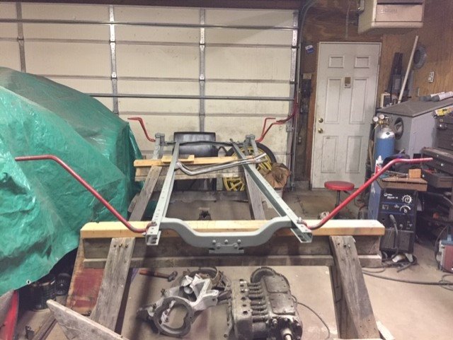

I've been working on this Model S project.
I couldn't find a frame so my friend Jim Kraut and I made one from scratch.
I borrowed one from a new friend and copied it.,

WOW! Thanks for showing us. What a great project.
I am envious.

Wow Herb! That IS great! I have made many parts of cars that I didn't have or couldn't find. Somewhere I have the correct firewall brackets for my '15, I know I do. After spending two hours looking for them (most of the parts I have for that car are separated out from the general hoards), I made a pair. Wish I was better with photography, I should have shared the project. They came out so good that installed, almost nobody would even consider that they were made by a bum like me! Of course it does help that they are pretty well hidden between the firewall and hood former.
I do hope you can get that N completed!

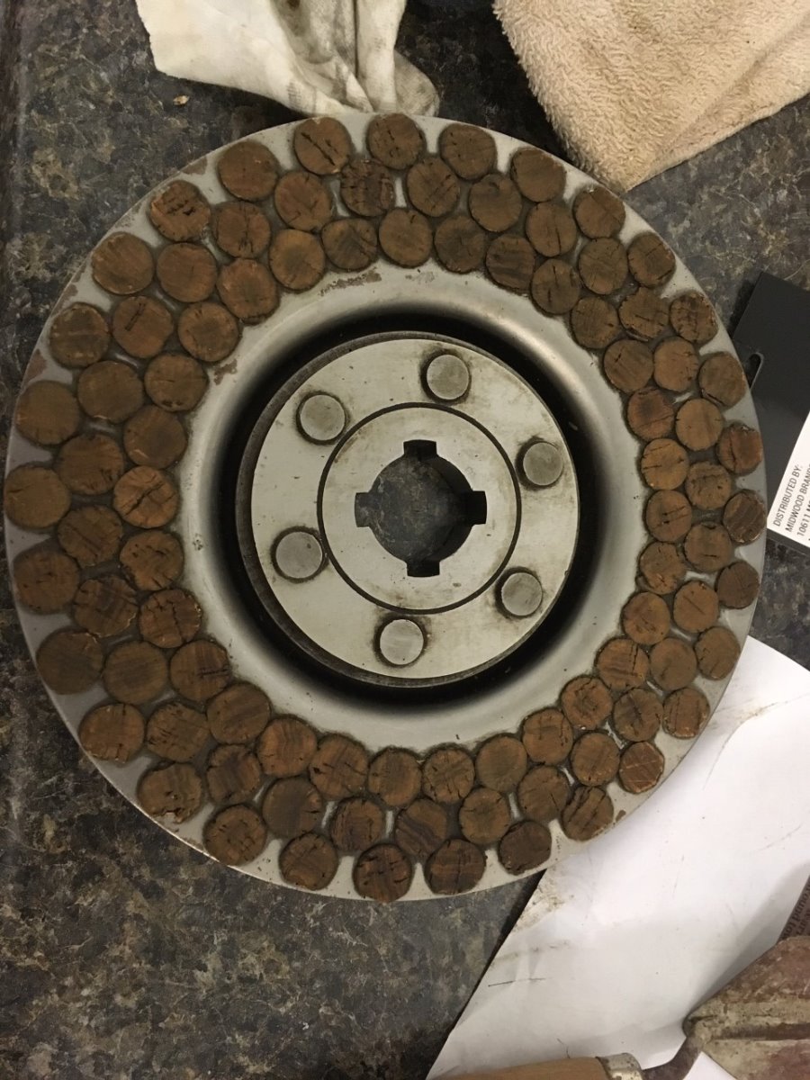

We recently changed the clutch in our museum's 1913 Empire.
It is a wet, cork clutch similar to the ones used by Hudson. Fortunately there are 2 knowledgeable Hudson owners available to give us advice.
This is one museum car that is kept in running condition and does get driven a little.

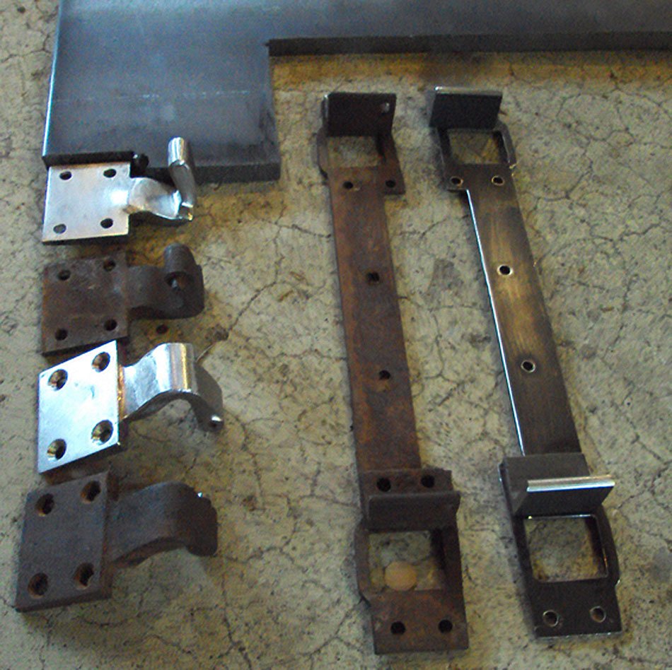

This 1915 Maxwell was missing the left door. To make a new one I built 2 wooden forms. The first one (at right) was used to bend the sheet metal edge over 90°all around. The second was used to form the bead around the door. A bar with a stem welded on formed the bead into the groove between 1/8" flat bars screwed onto the second form. This door has an overlap on three sides that covers the gap between door and doorway. A half oval bar was made to fill the bead. Backing up the sides with wood blocks the lip could be formed with a chisel dull enough not to shear the metal. The half oval bar can then be pried out.

Of course a hinge and latch also had to be made. The hinge is more complicated than a T hinge as it is concealed inside the door post. However it was possible to just copy the original, other side and make a satisfactory one.
Finding the right thickness for the latch plate took some digging. A suitable piece of rusty sheet was final found. The guide is attached with slots like some Model T latches. I found I could make the odd spring by unwinding a coil spring and re shaping it.
As luck will have it a real latch showed up at a swap meet and a hinge was on Ebay. Both several years after the fabrication. No doors yet. The satisfaction of making these things is worthwhile al by itself though.

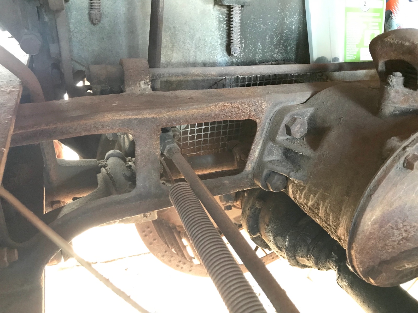

I hate, loathe and despise bleeding brakes on my old truck. It seems a leaking wheel cylinder allowed all the fluid to drain out of the master cylinder. With some vehicles that's not a big problem. You just fill the reservoir and pump the pedal until all the bubbles are out of the line. Not so with this beast. Once the master cylinder runs dry, getting fluid back into it is the job from Hell. I was finally able to get fluid flowing again by applying air pressure to the reservoir with a shop vac. Tomorrow I'll buy a new ground cable and hope that has me ready to get some yard work done.
Re: What have you done on an old non-Model T vehicle.
Posted: Wed Apr 17, 2019 8:07 pm
by Dennis Prince
Steve, on a vehicle that is hard to bleed like that, you can push fluid through the bleeder and fill the system one wheel at a time. Start at the furthest wheel and work your way to the closest. It pushes the air up into and out of the master cylinder. This can be used if you have to mount the wheel cylinder upside down for what ever reason.

Workin on the beast - ‘22 Mack AC.
Need to have it completed by its 100th birthday.
Bulldog Rescue !
In-frame over haul.
Nothing beefier than a chain drive.
Original Bulldog nose.
Boy do I wish there were parts suppliers for AC’s like we have for T’s.

Paul, I'm going to ask my own nagging question: Where does the warm air from the rad go/ get out?
Teens IH trucks, the IH 8-16 4 cylinder tractors were similar and a French car, jeez the name escapes me when I need it most.
I've been working on non vehicles mostly so that's beyond the scope of this site.

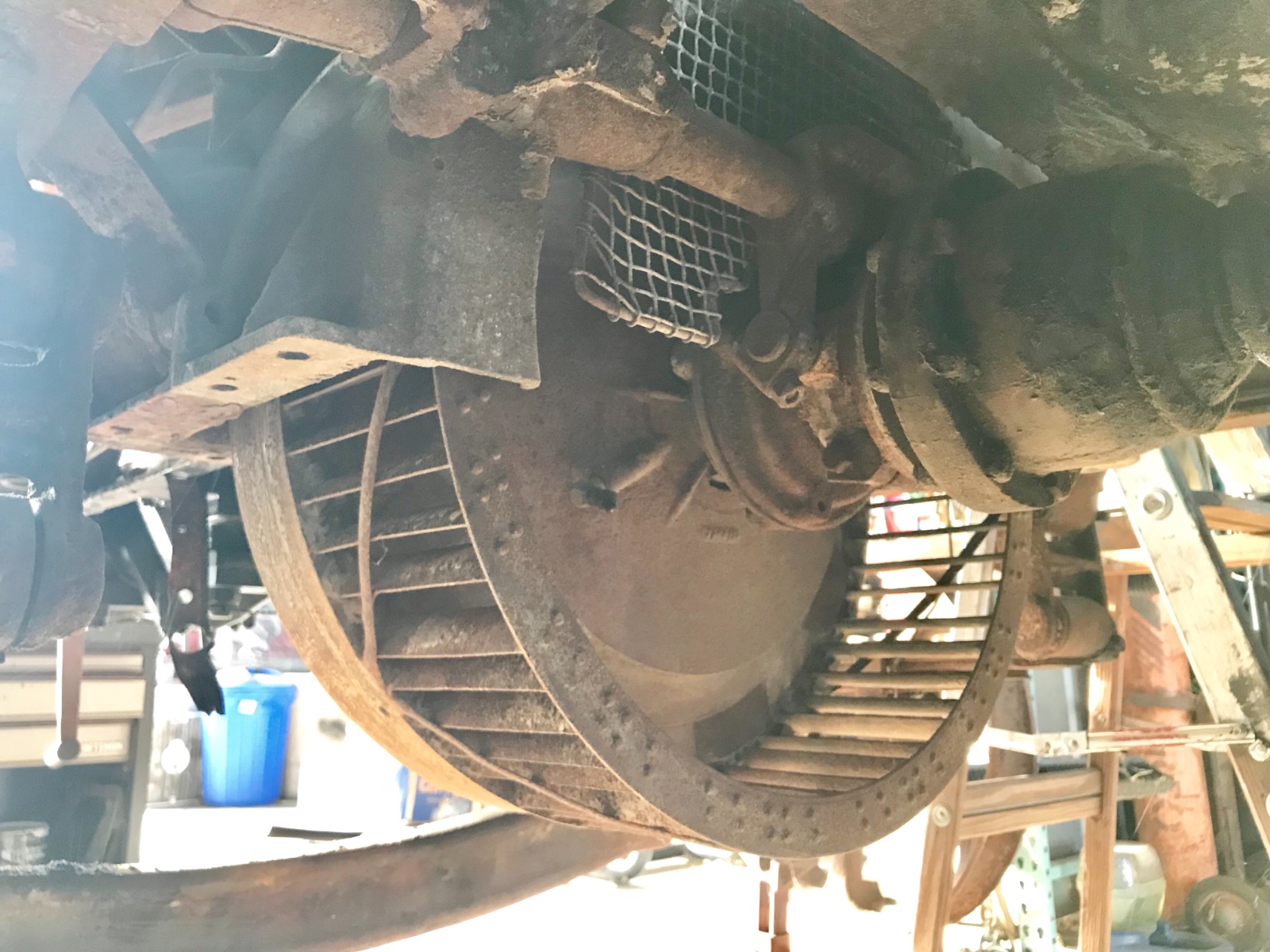

Good question. Some real novel designs on this truck.
The intake air to the radiators comes in from a squirrel cage blower on the rear of the flywheel -
the lower cast aluminum housing is removed here - then the air flow is divided into two as it travels up in the ducting in front of the firewall
and
out each radiator from the sides.

by Duey_C
Thank you very much Paul! That explanation's Gold to me and makes perfect sense now! Very cool! :)
Remember the Off Topic side of this site if you'd be willing to share more as you go or a link for us. :)
I, for one would be very interested. My wife calls it blogging: I call it information sharing of important mechanical topics and your Mack is a vehicle and related to the automobile hobby. :)
Posted: Fri Jul 12, 2019 1:04 pm
by Rich Eagle
The 1907 Buick I posted on the Journeys and Joyrides yesterday had overheated for many years. The original radiator core had been discarded and a new core installed twice trying to solve the problem. Nobody wanted to open up a water pump that wasn't leaking I guess. It was suggested I do so. I found that the drive gear had broken at it's square hole. Not only was the pump not pumping but the gears were not letting any thermosyphon effect through. These gears were made of a light porous material that has very little strength. I believe it was done to be the weak point in the pump and would break before the more expensive parts in the motor would should the water freeze.
I selected to make new gears from bearing bronze and just be careful. Not having a mill I simply scribed out the shapes and drilled and hacksawed them to shape. I checking to make sure they didn't bind. While they are not precisionally perfect they do push water which is noticeable looking in the radiator neck. It cools very well for an old car under 35 MPH.
just more fun along the way.
Posted: Sun Jul 14, 2019 2:09 am
by Duey_C
Rich, may I ask why you didn't guess at straight cut pump gears instead of the "very little strength" bent over style?
Funny what a fella with a crazy mind, a hacksaw and a file can do? Been there, done that myself. NOT with an '07 Buick tho...
Good reminder for everyone. We CAN.

by Rich Eagle
Duey, I just tried to copy what the engineers decided on in 1905. When I try to improve things I lose out. Hacksawing is one thing I think I am getting good at.
Derek, this is a good place for those interests and it broadens our horizons. I don't understand the technology but like the colors.
