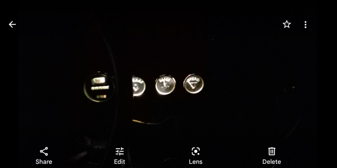

Dash is back in and wired up, the dash lights are fantastic at night.
