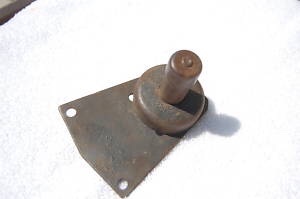

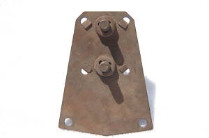

I bought one of those "worthless piece of junk" starter switches and rebuilt it.
viewtopic.php?f=2&t=41725

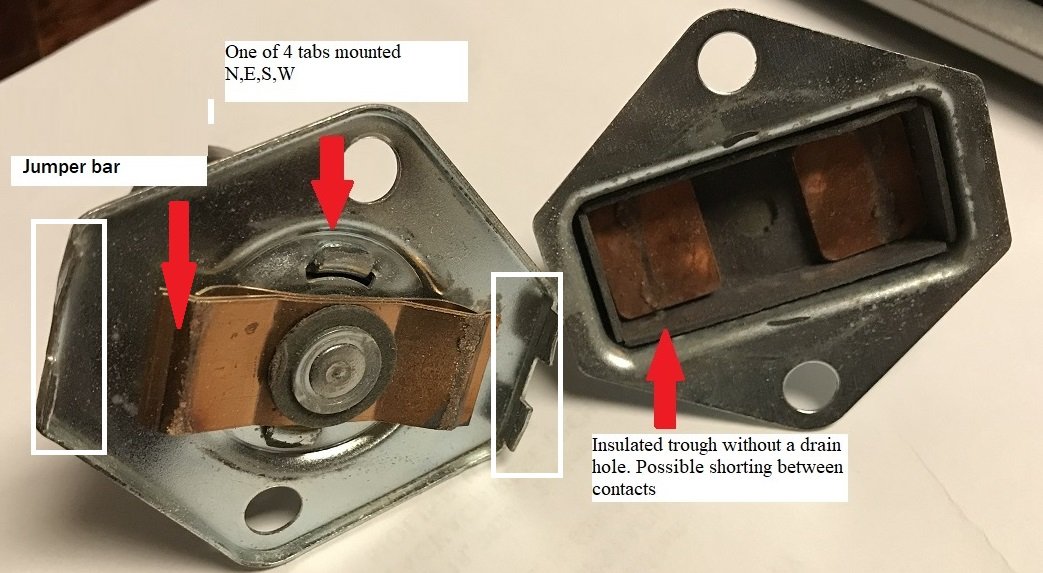

I've posted this in the past about the poor design & material used for SOME of the repro switches. I have sen some changes in design (at the locale Tractor Supply). Better ones have 4 bent tabs holding the plunger tube in position.
The repro starter switches generally fail because of burned out contacts or bent plunger tube. The bent tube can also lead to burned out contacts.
The tube may bend because the top of the plunger tube is too high above the floor board allowing it to rock forward bending the top of the case resulting in only one of the contacts making contact.
As you can see in this switch there are just two bent over tabs securing the plunger tube allowing the tube to bend forward when depressed. A fix could be a spot weld to secure the tube from or perhaps a heavy bead of JB weld ?. You can also see that that the contacts in the bottom portion of the switch are housed in a rubber insulating tub with no provision for drainage - potential short.
Since the plunger only needs to travel a small amount to make contact that plus a little more is all that is needed. The plunder hole in the floor board also should be just enough to keep the tube upright when depressed to avoid the bending.
It would be a good idea too report how the switch failed - contacts, bent tube base or both

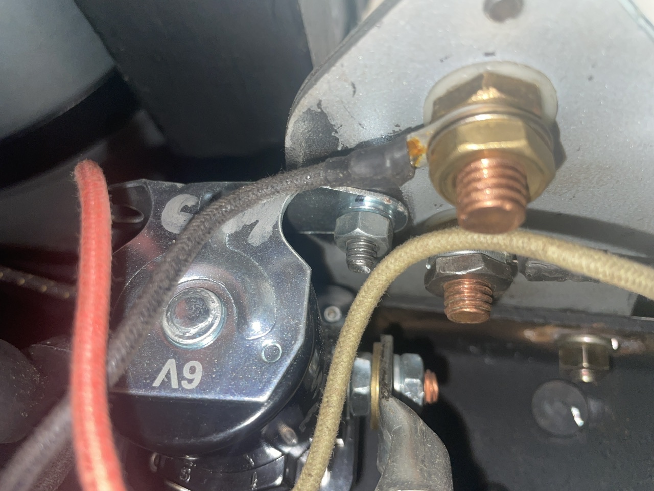

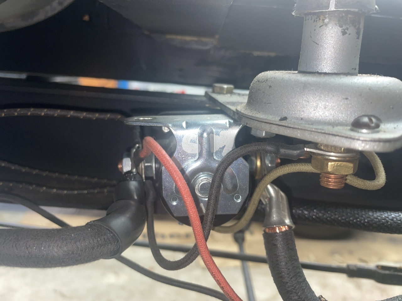

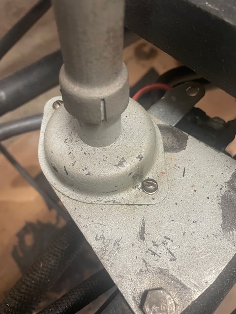

Using a solenoid will take the load off the foot switch.
On this install refurbished an original screw cover T switch, drilled hole under the cover to fasten one arm of the solenoid. That gave the 6v solenoid a good ground to function as the foot switch plate is fastened to the frame anyway, but be sure the bolts to plate and frame are clear of rust or paint for ground return.
The heavy battery and starter cables mount to the solenoid.
Then run little wires to power the solenoid, works great!

Great photo Dan !
