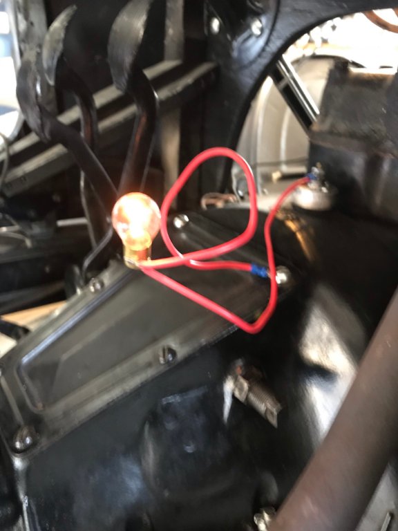

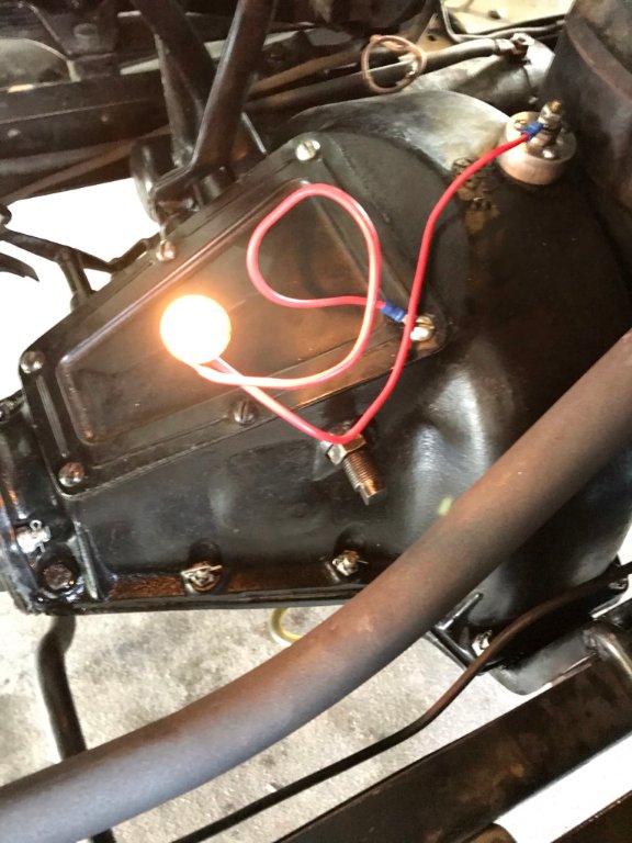

Yesterday I was driving to the grocery store and my mag quit. It backfired a couple of time and then the engine died. I coasted to a stop, turned it to "bat" and it started right up but it just dies if I turn it to "Mag". Testing the ignition switch, it has continuity from the mag post wire to the coil box with the engine off and the switch turned to Mag. I put an 1156 bulb on the mag post and it glows dimly at idle and gets brighter when I speed it up. Unfortunately I don't have an analogue volt meter and the stores are closed for the August Civic Holiday (Canada). Until now the mag always worked without a hitch. Is there a test I can do on the mag coils? Checking resistance through the mag post to ground is essentially 0, I'm assuming there isn't enough resistance in the mag coils to amount to anything, is that correct? Any suggestions would be greatly appreciated.
- Posts: 5167
Re: magneto quit
The mag is producing , as evidenced by your light bulb. It would seem to be a switch issue. Repop switch?? Probe the switch with your tester.

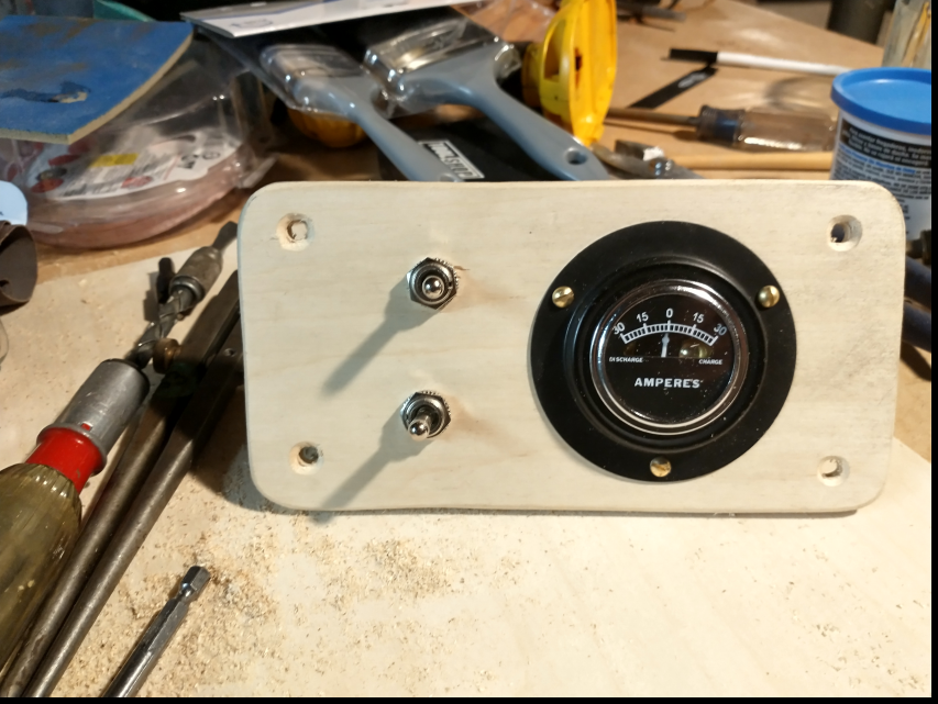

I think I'm winning. I took out the old switch and wired up two On-Off-On switches to replace the ignition and lights. Made a temporary dash plate to hold them and the ammeter. Went for a 3 mile ride and no mag issues. Started running on three cylinders, but that was a loose coil in the coil box. wiggled it a bit and it ran on four again. I had put new wood in the coil box some time ago, but one of these days I'll spring for the modern plastic kit. I'll run it like this for a while to make sure everything is OK and then work on getting a correct switch again. Any way it runs on mag!! Yay!

I'd love to see how you wired that up.JamesD wrote: ↑Sat Aug 07, 2021 4:36 pmI think I'm winning. I took out the old switch and wired up two On-Off-On switches to replace the ignition and lights. Made a temporary dash plate to hold them and the ammeter. Went for a 3 mile ride and no mag issues. Started running on three cylinders, but that was a loose coil in the coil box. wiggled it a bit and it ran on four again. I had put new wood in the coil box some time ago, but one of these days I'll spring for the modern plastic kit. I'll run it like this for a while to make sure everything is OK and then work on getting a correct switch again. Any way it runs on mag!! Yay!

a SPDT center-off switch would replicate the ignition switch function perfectly

There's more going on in the Model T ignition switch assembly than Dim-Off-Bright and Magneto-Off-Battery.Scott_Conger wrote: ↑Sat Aug 07, 2021 8:15 pma SPDT center-off switch would replicate the ignition switch function perfectly
For example, how does the cutout get wired through? Does it require a pigtail be made of the ammeter+ wire for the battery ignition, bright, dim and taillight?

Yes, one SPDT switch for the ignition. Center terminal is the coil box, one side is mag and the other bat. The light switch is functionally the same except it has two sides, so there's a battery wire from the ammeter connection to the center terminal of one switch and and a jumper from there to the other side center terminal. One side of the switch is Dim/bright, and the other side of the switch is connected to the tail light on both terminals. My lights were sketchy with the original switch too, I had to wiggle the switch just so to get the tail lights to come on. Now it all works.

Thanks a ton. I think this is going to be a great stopgap until I get my switch repaired.JamesD wrote: ↑Sat Aug 07, 2021 11:45 pmYes, one SPDT switch for the ignition. Center terminal is the coil box, one side is mag and the other bat. The light switch is functionally the same except it has two sides, so there's a battery wire from the ammeter connection to the center terminal of one switch and and a jumper from there to the other side center terminal. One side of the switch is Dim/bright, and the other side of the switch is connected to the tail light on both terminals. My lights were sketchy with the original switch too, I had to wiggle the switch just so to get the tail lights to come on. Now it all works.
I've got it mostly wired up (except tail light) and I'm having as bit of an issue. Light work better than ever, car actually fired over on mag hand cranking (which surprised me, but then again I never tried before) but I can't get the coils to buzz on battery. Maybe I've got it wired wrong . . .
The switch on the left (ignition) has the coil wire in the center input, mag wire on one side, ammeter+, cutout wire from terminal 1 of the firewall terminal block and jumper to the center terminal of the switch on the right (light switch).
Thoughts?

Got a nifty switch plate going too. Just gotta figure out how to get the battery to fire the coils.
