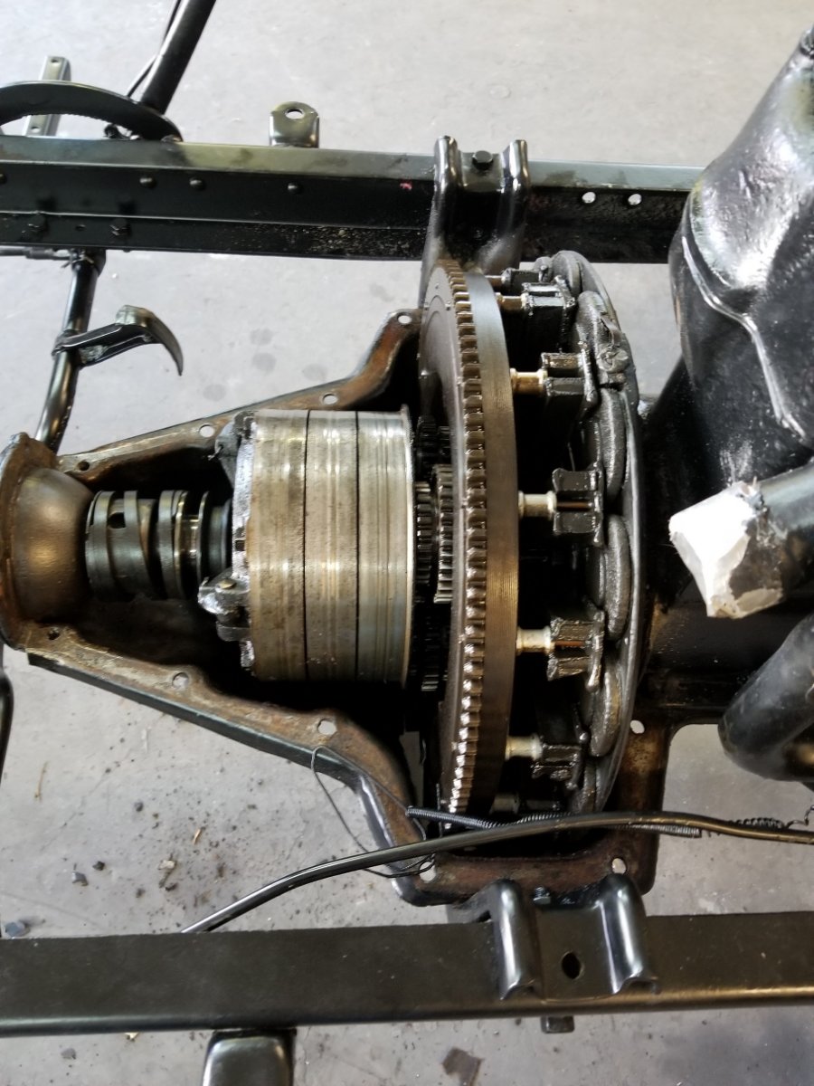

I'm new to Model Ts. This was my Uncle's ('23-'24?) Runabout that I rode in as a kid. The magnets are very weak and need to be recharged. All the material I've read has put me on the road to charging in the vehicle with a battery charger. Two questions. Will a 200 amp battery be sufficient or is a 300 amp needed? With the Hog's Head off, where exactly does the Hot Lead need to be connected? Here is a photo of the '25 engine/trans.

- Posts: 4692
Re: Charging Magneto
Hello and welcome to the Model T world!
I’m kind of like you in that I inherited my Grandfathers 24 Coupe and rode in it when I was a kid.
By the looks of your chassis pic you either cleaned up the engine and chassis or rebuilt the engine.
It looks like the engine still has the original mag ring (not sure).
I don’t know if you had your engine apart to rebuild it but from experience I learned I should have installed a rebuilt mag ring when I first rebuilt the engine years ago.
I also had what seemed a weak mag which turned out to be a short in the original mag ring.
After that experience I completely went through the entire engine, replaced the mag ring and charged the magnets individually when I had the engine apart. Glad I did that! I should have done it the first time.

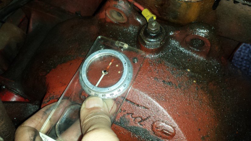

You will need the 36 volt and the amperage that the lead-acid batteries can give.
Then position the flywheel and the magnets right in relation to the coils is important.
Here i did it with a compas. You may imagine how to do it without the hogshead, but you will have the better view of the magnets to make sure they are positioned perfect out of the coils.
I gave it 3 flashes in the top terminal and without the hogshead it is the large blank metallic spot on the top of the coilring.
After the operation, that took 10 minuttes or so I meassured the output: It may not give same performance as individually charged magnets, but it is so easy to do, so it's no worry. Just do it!
