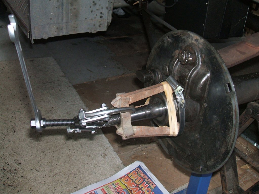

I mentioned the felts earlier because I think I have them in one of my axles. I remember how hard it was to install them, but I put them in dry. I should have soaked them in oil first. My guess is the center of the felt gets worn out real fast and the felts become just a dam to prevent the oil from moving toward the wheels. I do not think very many people use them.
I have never been able to remove the axle housing caps without using a screwdriver or pliers, and end up ruining them. There might be a trick to it, but I do not know it. I switched to the neoprene outer seals and they are great. They come off easily, and go right back on again. Well worth the cost. I was taught to remove my front and rear bearings every spring to clean and regrease them. This way I can inspect them to make sure they are good for another season.
