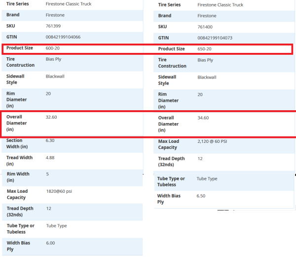

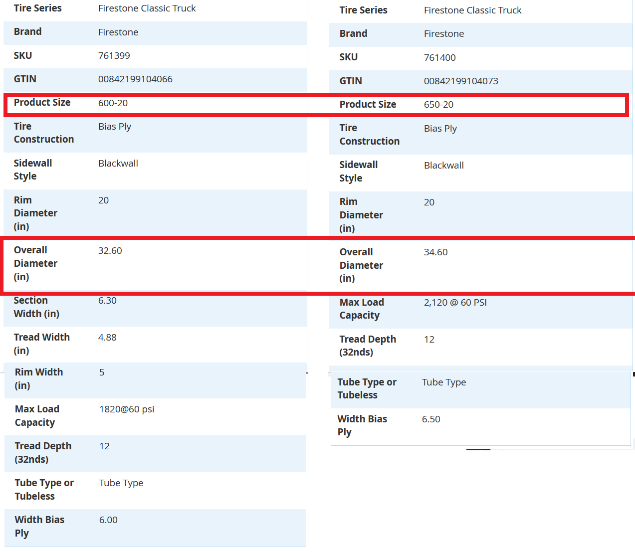

Tire specs from the links you provided above. 2 inch difference in diameter
example: "width" of the tire not the rim.

Post by TXGOAT2 » Fri Oct 06, 2023 4:11 pm
Adding 2" diameter will raise the vehicle about 1" and allow a little higher road speed, maybe 5%. Most trucks sit higher at the back unless loaded. On dual rear wheels, clearance between tires may be an issue with oversize tires.
