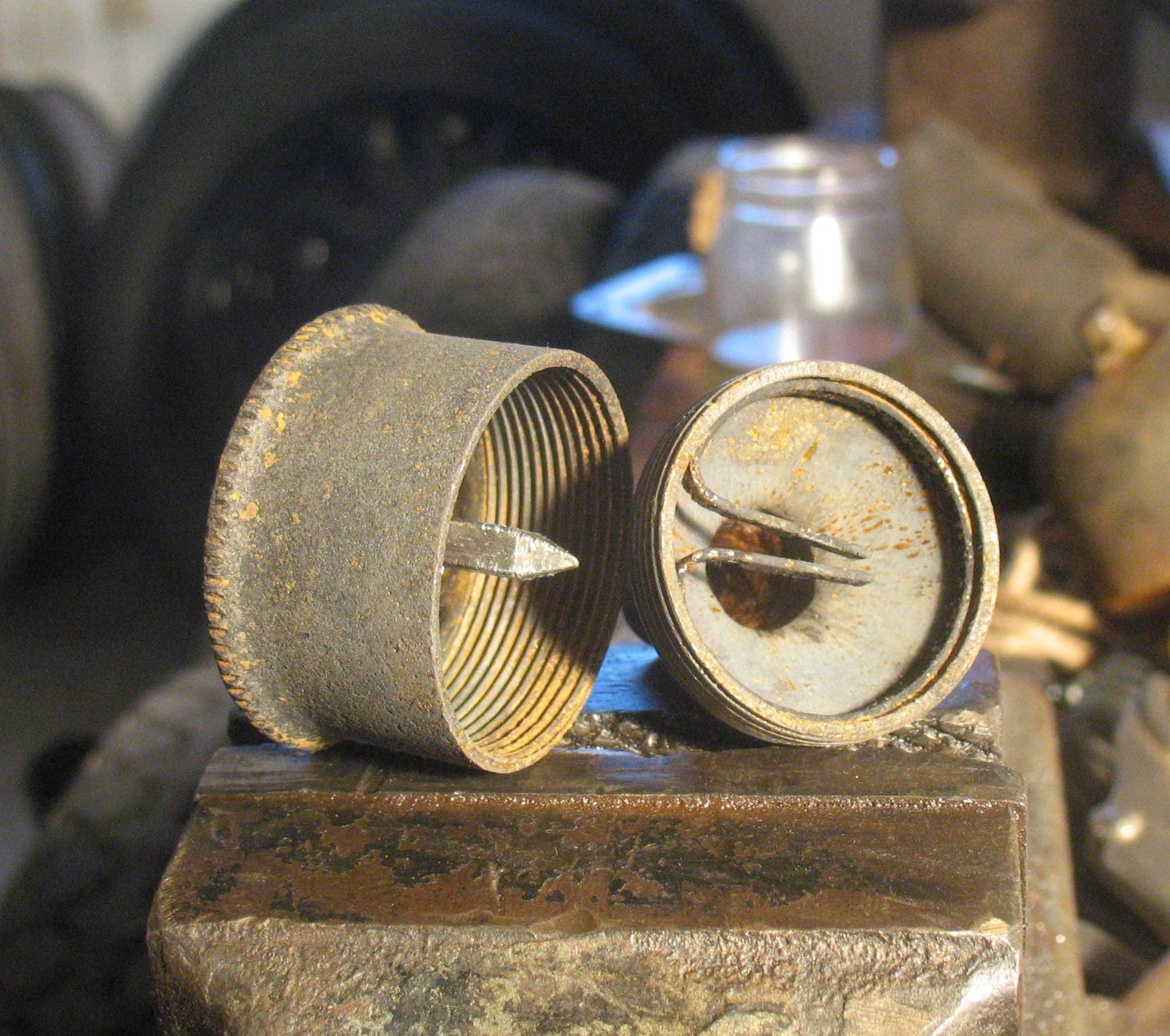

Re: Why does my grease cap on the fan hub keep falling off?
The cup, or its cover? Sometimes there is a small spring which keeps the lid from vibrating loose.

Do you have or did you have a cap/cup like above or an oil cap/cup?Sarikatime wrote: ↑Sat Oct 05, 2024 9:23 amEvery time while driving my grease cap on the fan hub untwists and falls off. No matter how tight I twist it on it is missing after a tour. How can I keep it on ?
Steve, you are completely right. I have some of those grease cups with the pinchers in the middle and spike in the lid but never knew why so I did not use them. I have lost four or five caps because I did not know. Thank you.

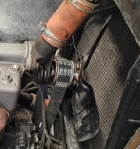

Mine is just a regular right angle grease fitting pointed opposite of rotation. It has held on for the ride.
- Attachments
- IMG_3484.jpeg (66.59 KiB) Viewed 3543 times

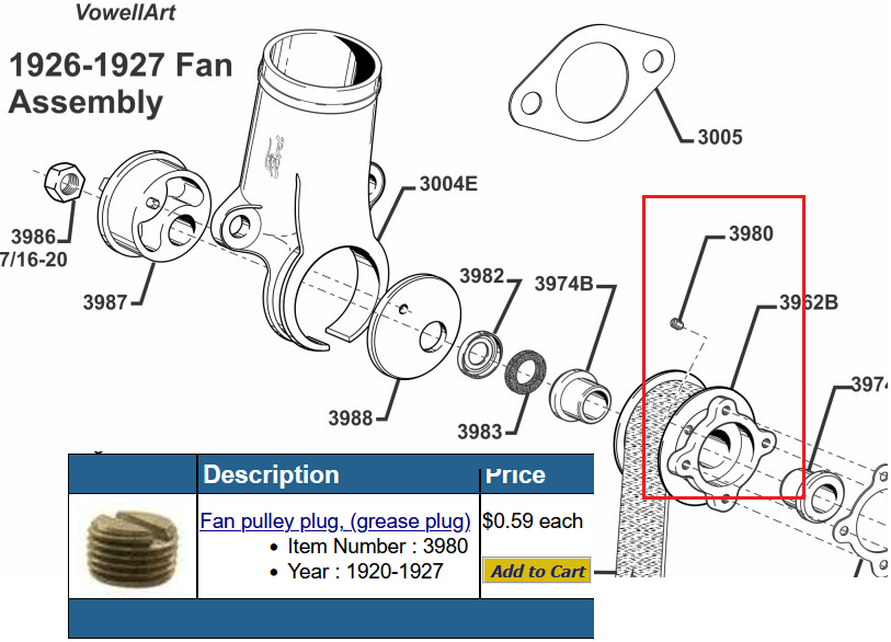

Grease cups & grease fittings (ZERK) are two different animals !
- Posts: 5545
Bit off topic;
Unless you have unshielded bearings in the housing, grease is not a good idea in this location. There should just be a plug in the hole and use heavy oil like 600W or chain bar oil same as what should be used with kingpins.RecklessKelly wrote: ↑Mon Oct 07, 2024 9:02 amMine is just a regular right angle grease fitting pointed opposite of rotation. It has held on for the ride.

- Posts: 6581
This what was intended for stock fan shaft
I had close to 20 proper grease cups but none with the clips on the inside to keep it from untwisting so I bought 3 from eBay. Thanks Steve.
