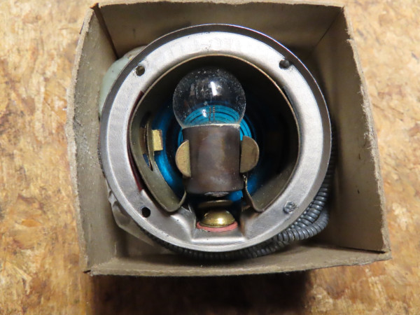

MOTO-LITE was another brand of the same device. I have a NOS one in the original box Here are two photos.

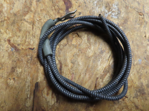

How can I replicate the cord part?…….Do you have any closeups of the metal sheath?

How long is it?…..Were there any installation instructions?

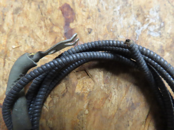

I see it now, 5 feet long. What does the end look like?…..Thank you very much!

a steel braided cable. a fitting to fil the moto lite. No fiting on the other end. I once h ad about 10 of these. None hade any instructions. I assume then you woukld need to install an fiting on the end that goes to you lighting system.
