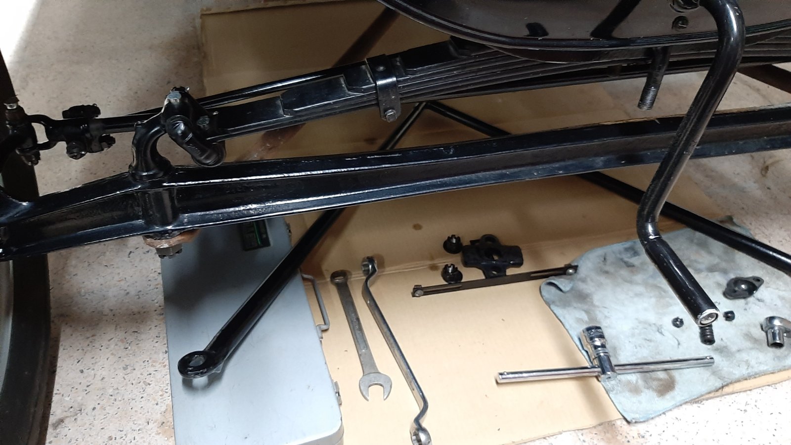

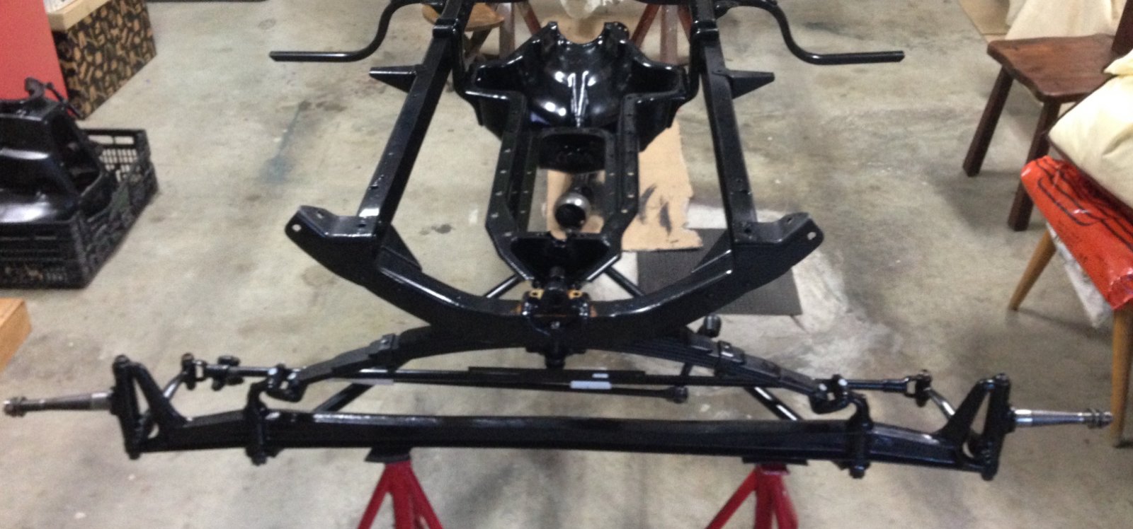

The spindles are tilted rearward at the top.

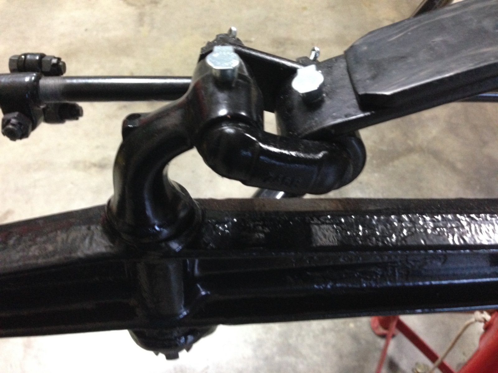

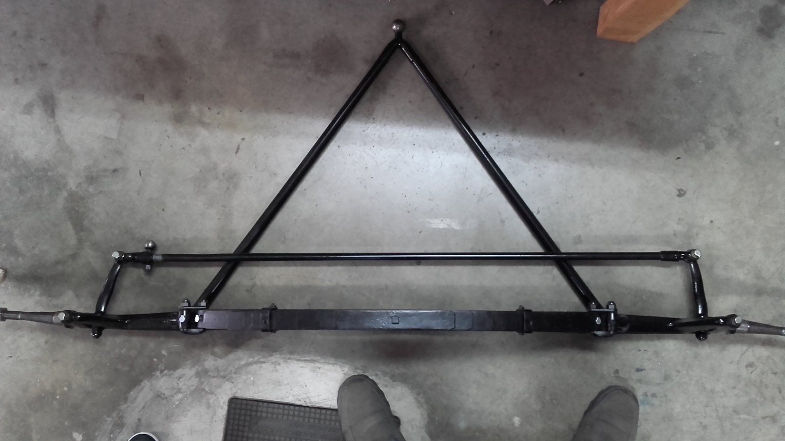

Here are some pictures before the installation.
- Posts: 6613
Re: Wishbone comes up short
Check your current perch setup to the "before" picture you included. It shows the correct perch position with the boss facing the rear

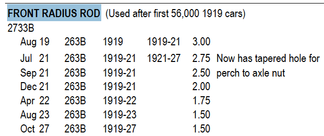

If you replaced the wishbone there are 2 different sizes (early and late) because of the height of the springs, if you have the short one on with a high spring it will drive terrible and be hard to assemble.

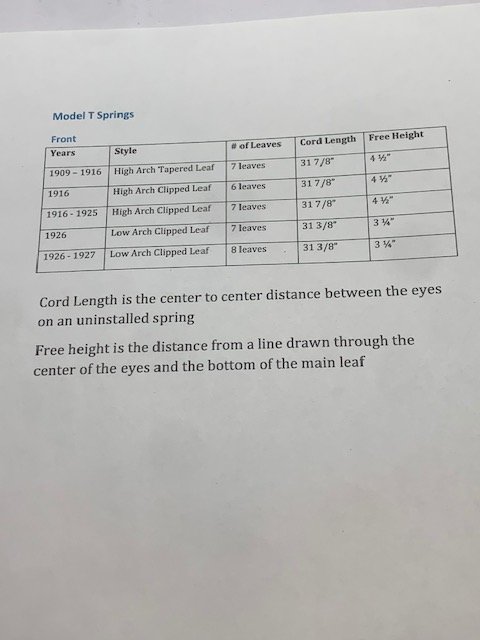

Eric, from your close up picture of the front spring it shows the boss to the rear, as it should be, for both sides. Re-arching the spring would have required taking the spring apart. Make sure that upon reassembly and installation in cross member that you got the head of the spring center bolt to go into the cross member hole properly. The wishbone 1/4 inch off at the engine pan is not all that uncommon, try loosening the spring shackle bars, they could be binding at the spring and spring pearch some. One last thing, I see that you have a 1926-27 frame, the crown of the 1926-27 front spring is lower than the pre 1926 spring. Make sure that your spring wasn’t a pre 1926 that upon re-arching made your ride high to high.

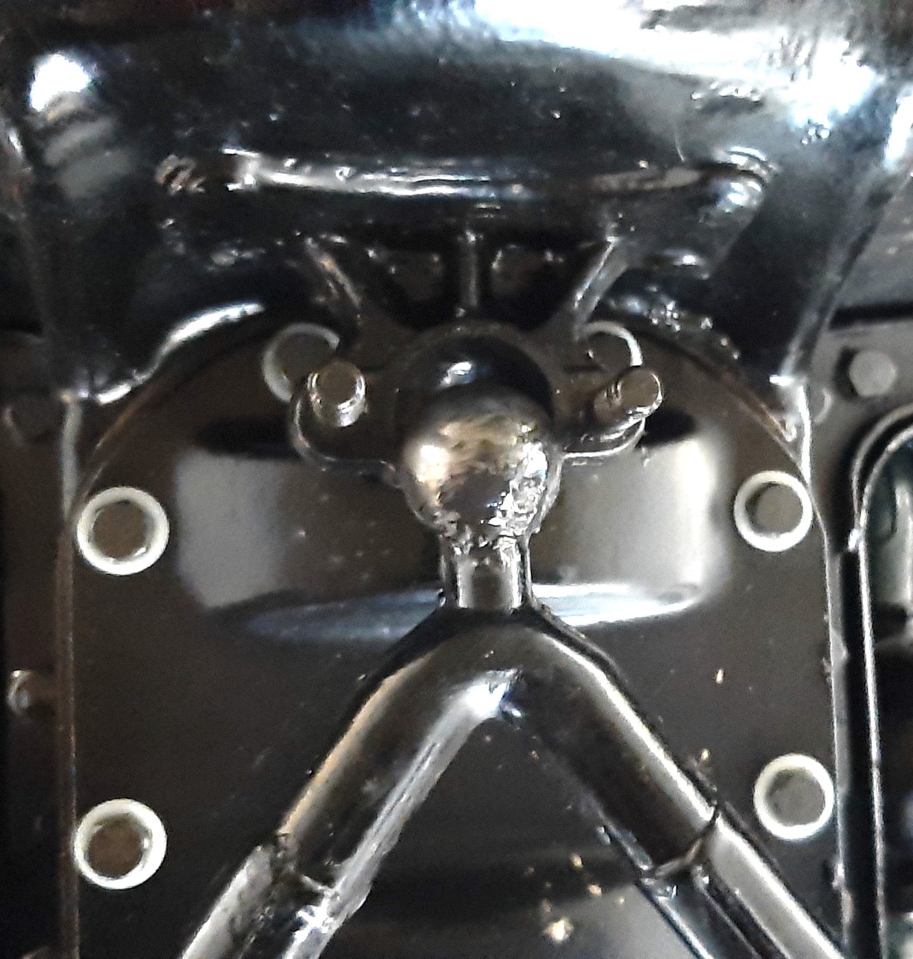

Quite common for the wishbone mount on the pan to be pushed in a bit from a front end hit in the last 100 years. 4 dip pans push in easy. That problem is not obvious from your picture.
Force the ball into the socket & bolt it down. If a long bar isnt enough, use a couple of ratchet tie down straps. After the car is fully assembled check & adjust accordingly. KRW made a long bar for this purpose. I use a 4' pipe wrench just out from the wishbone axle mount. Do it COLD. That bends the wishbone ends. Aint no big deal. Nothing to worry about.

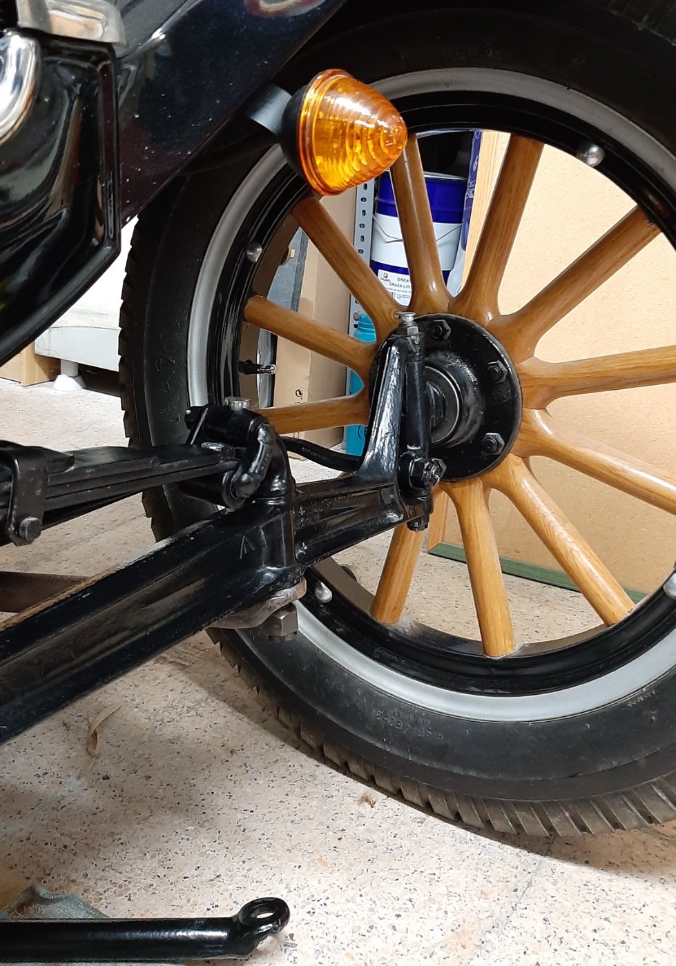

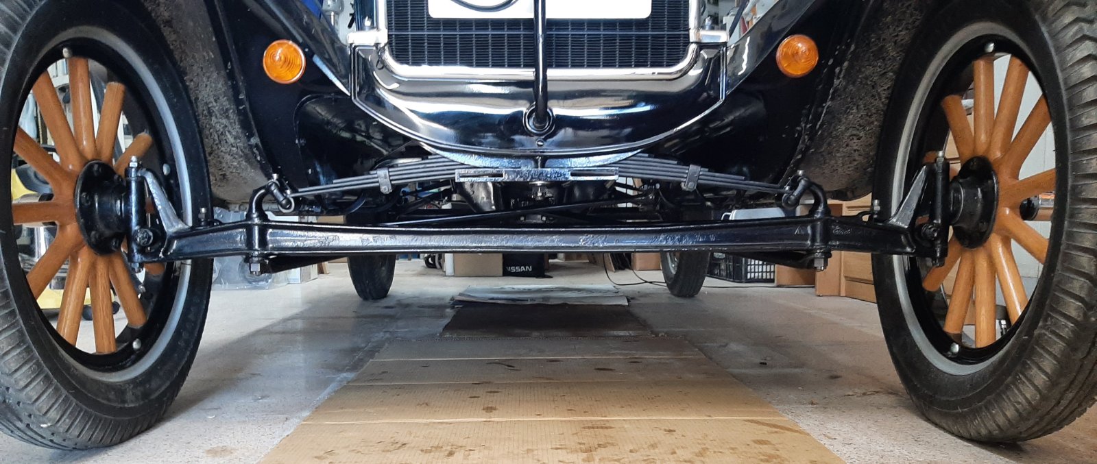

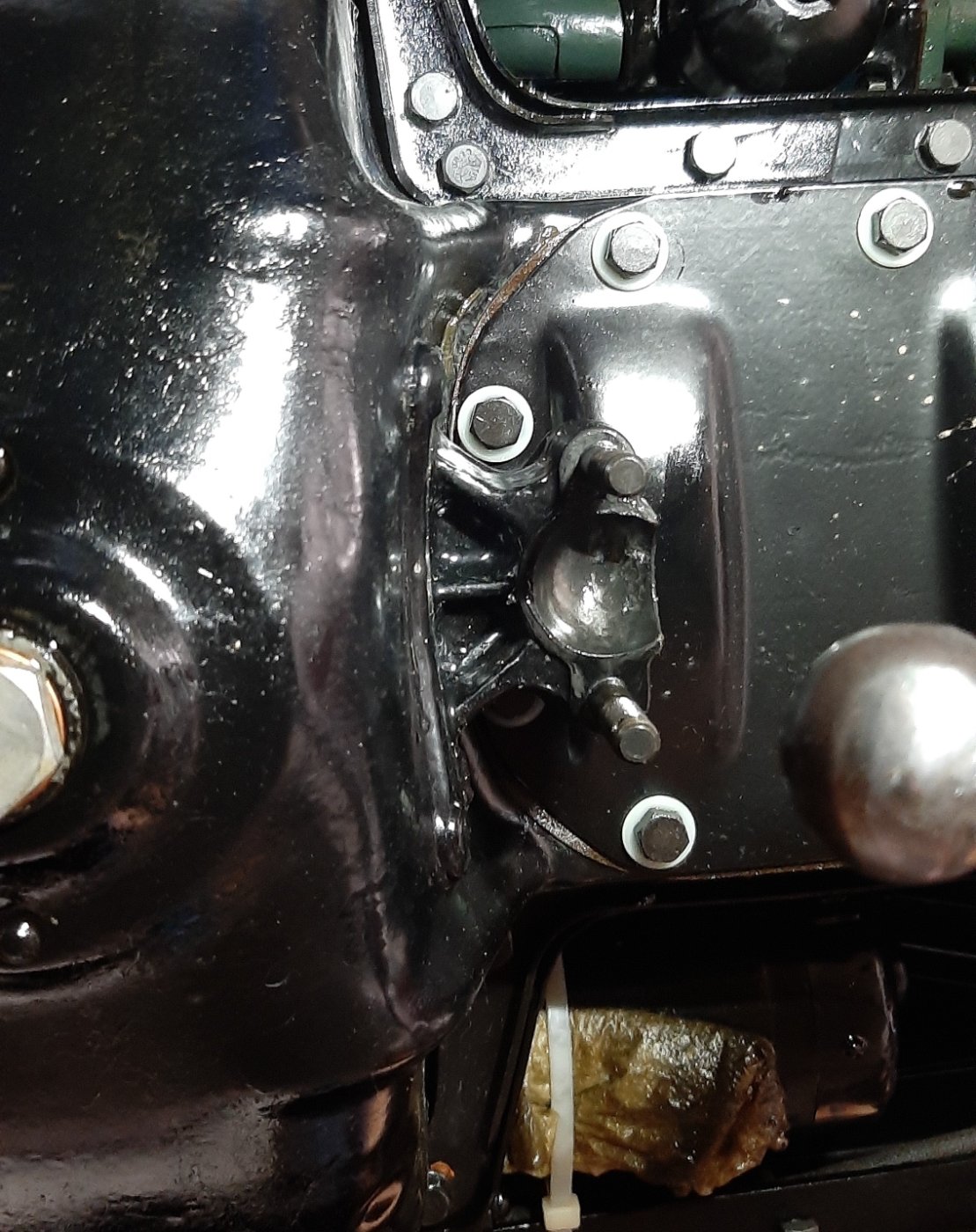

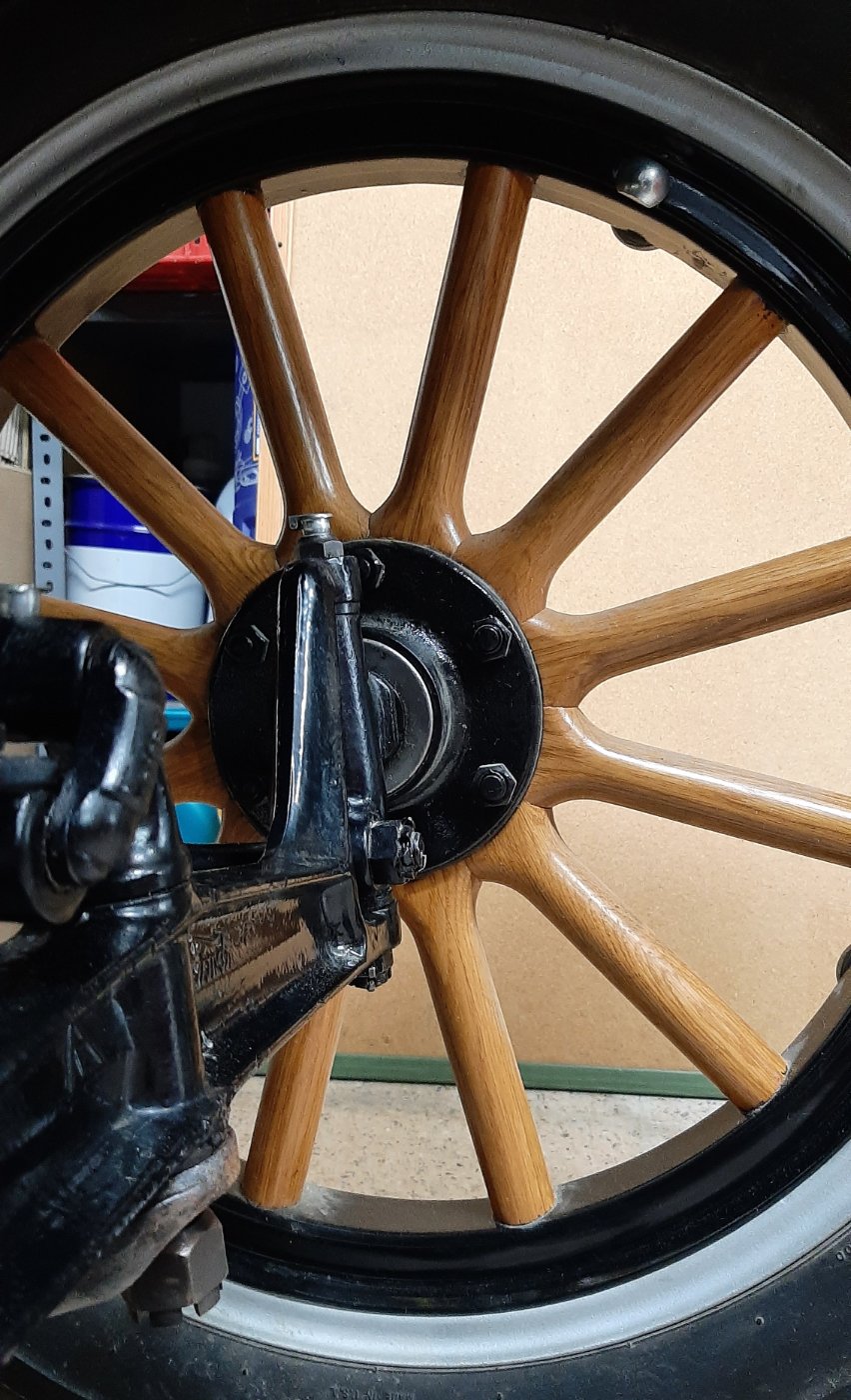

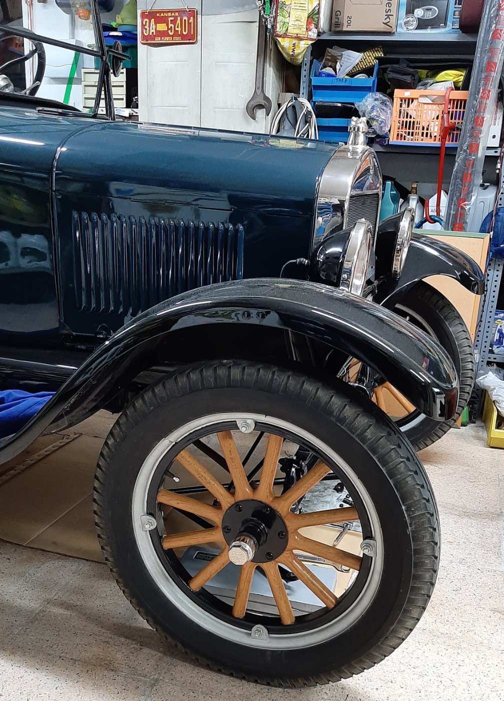

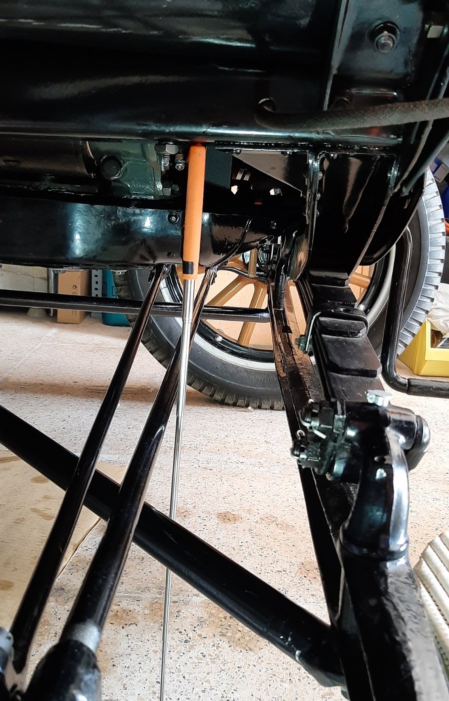

I am posting some more current pics. You will see an old, unpainted wishbone bolted to the front axle for some comparison checking, but it looks pretty much the same in length and angle as my original. I don't remember having to force the axle and wishbone into place, but it's been years now so...
With everything loosened up, my plan is to try to work the spring leaves and axle rearward so the wishbone ball might come closer to fitting into its socket. I'm concerned with putting the socket under a constant strain which is only going to get worse (I think) when the bottom is bent even further forward in order to adjust the spindle inclination. Everything fit fine when I took it apart, the spring arching surely has a lot to do with this. At first I felt like the spring was too high, but the chassis height corresponds to the factory specs.

Your T is looking great in the more recent photos!

If you look back through old discussions on this subject, you will find different lengths. More importantly, there are two different angles of the flat where it fits against the axle. The last one issued was for the "improved, lowered" 26/27 units. Another thing overlooked is whether or not the crankcase socket is punched in from repeated impact. I replace the balls and have found these differences.

It makes sense that the 26-27 models would have a different angle on the front radius rod (wishbone) where it mounts under the spring perches, but I have not seen any reference made about this nor can I find it in the parts catalog. If someone could provide the lengths of the 2 different versions of the radius rod that would be of great help.

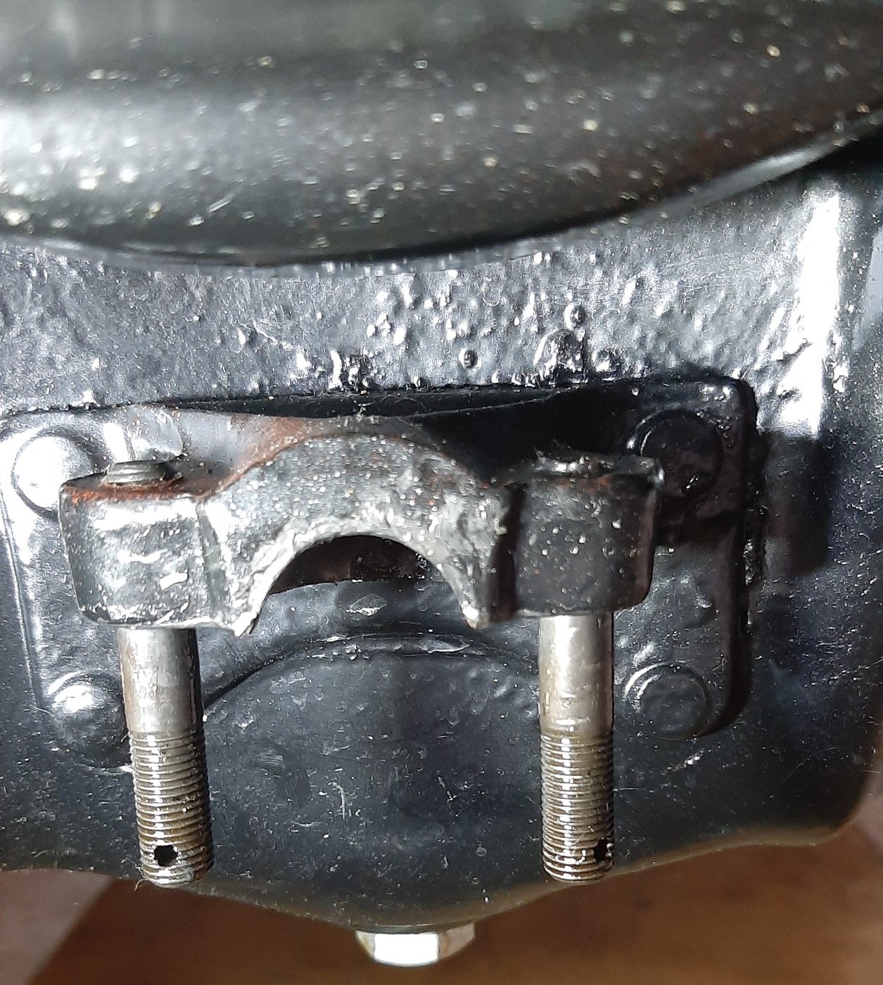

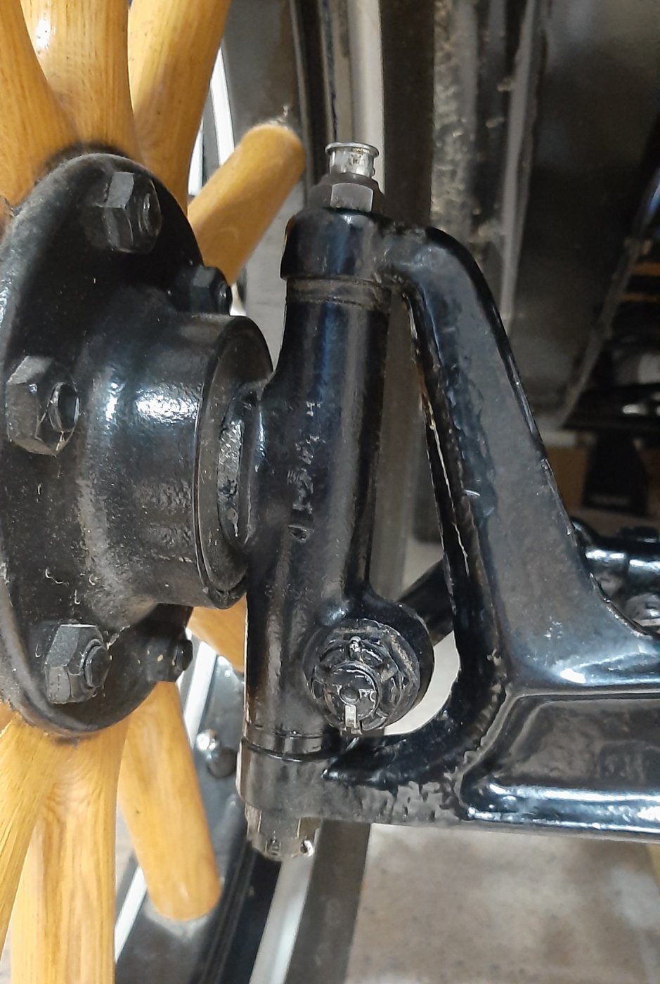

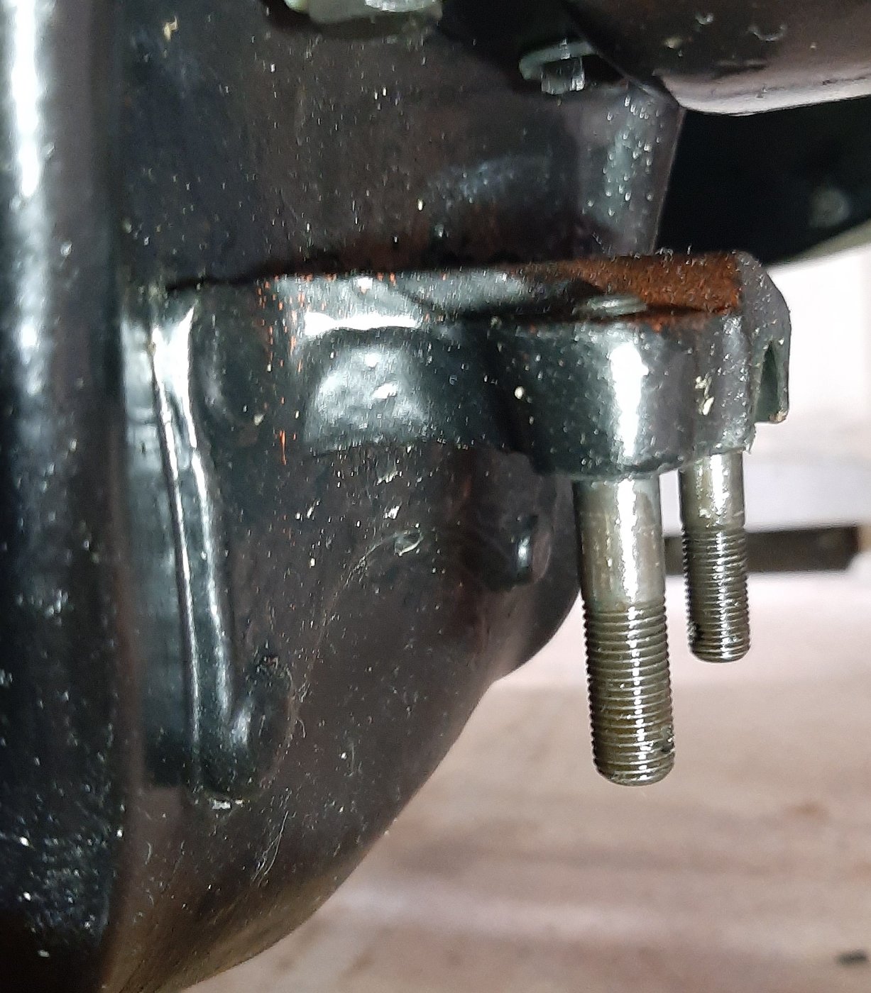

Here are some pics of the ball socket, maybe better trained eyes can see if it is pushed into the crankcase at all.
The starter motor is wearing a diaper until I get the seal on it.

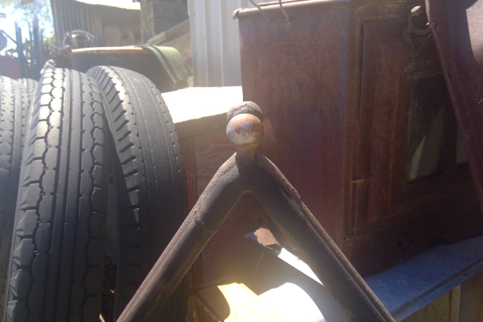

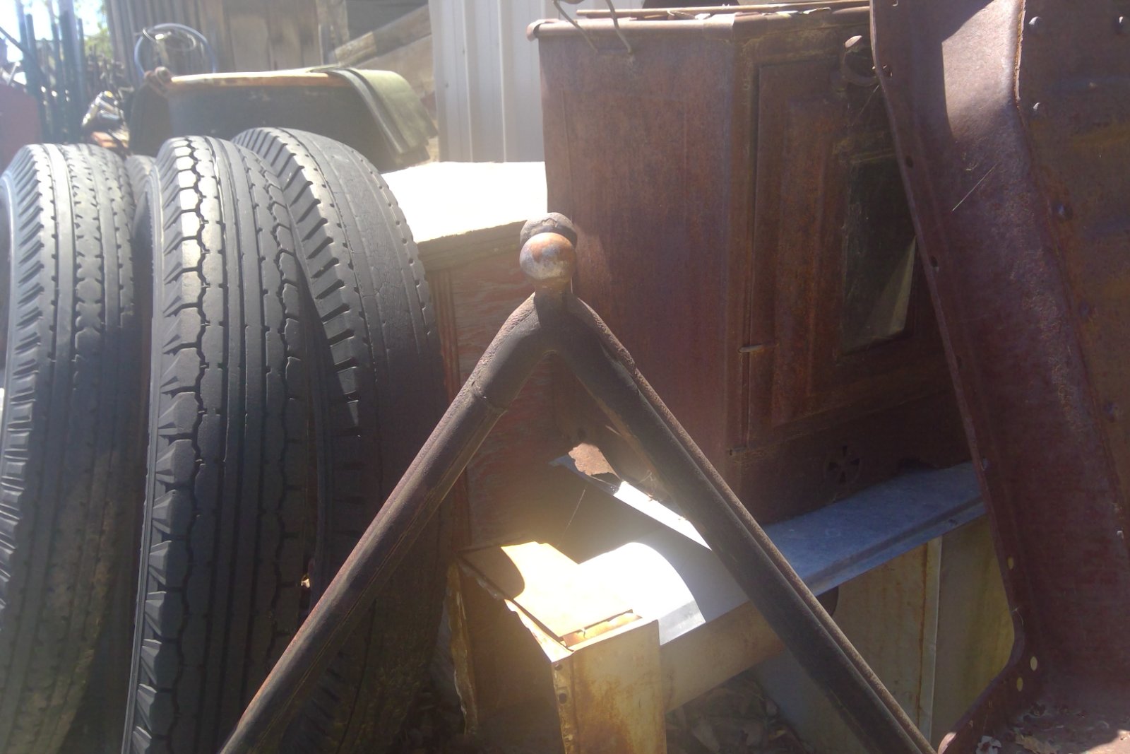

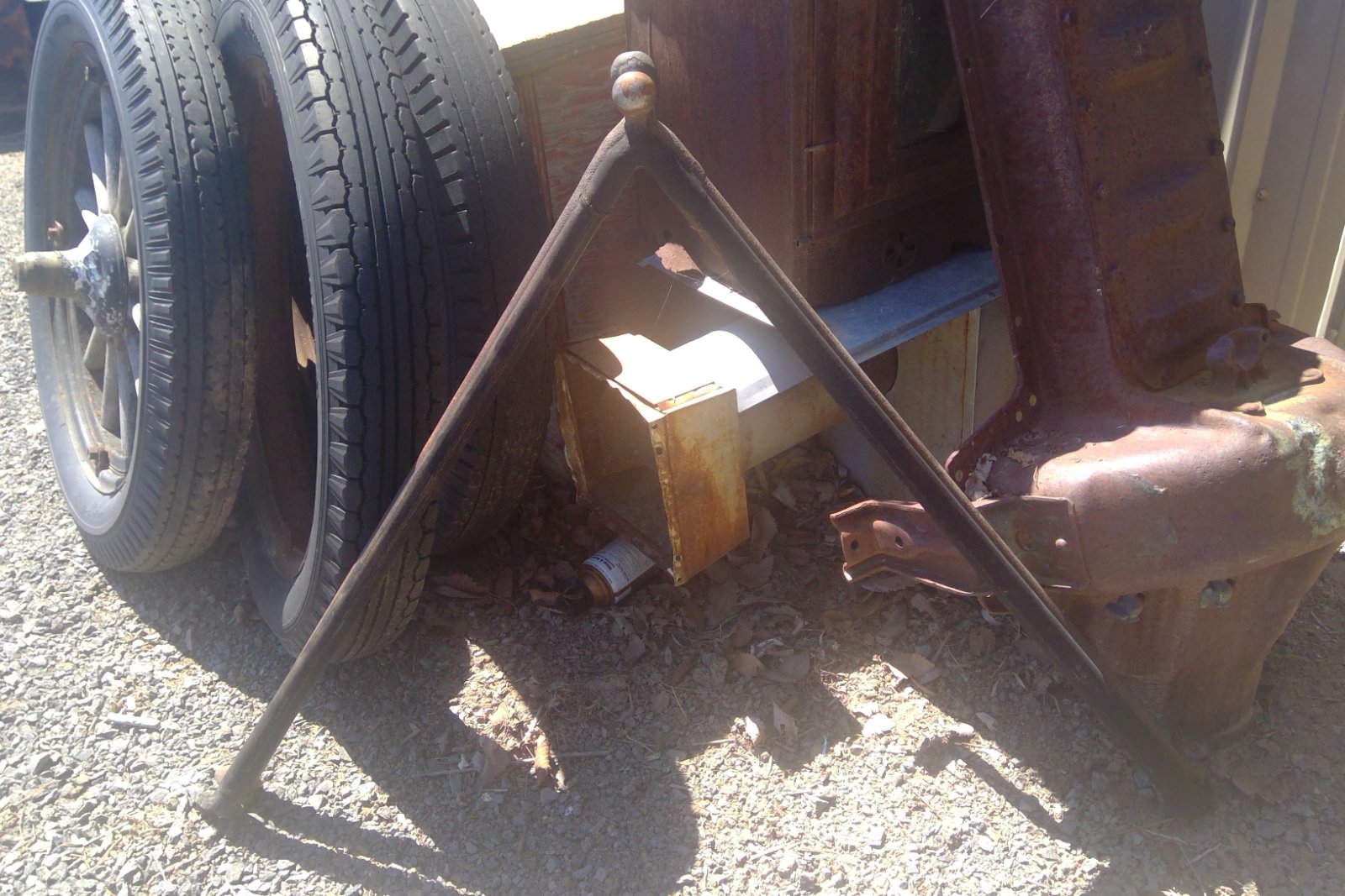

I have included pictures of a short and a longer wishbone, I had the short one on my car and it was hard to install and was dangerous to drive, I compared it to the one that came off of the same car and it is about 3/8" shorter. When I put a longer one on it drove just fine. I don't know what it is off of but it is for sure shorter

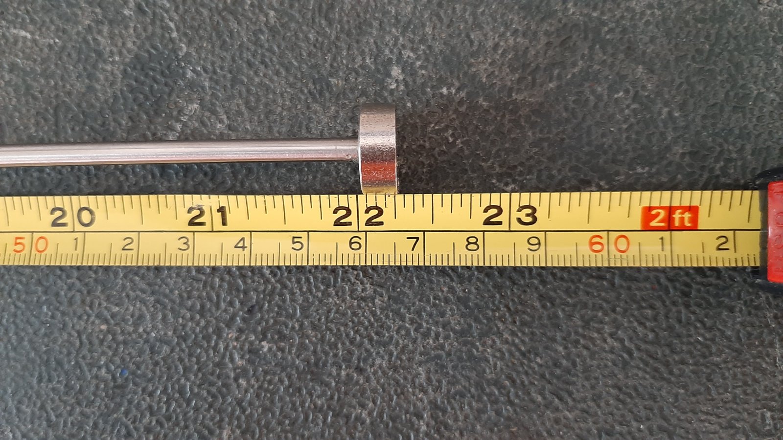

Dennis, my original wishbone on the car measures 27 3/16" at the rear of the ball when placed on the ground as in your pictures.
The other one I have measures 26 15/16", but this one has a bit of a bend on one of the arms, so that may be the reason it's shorter.

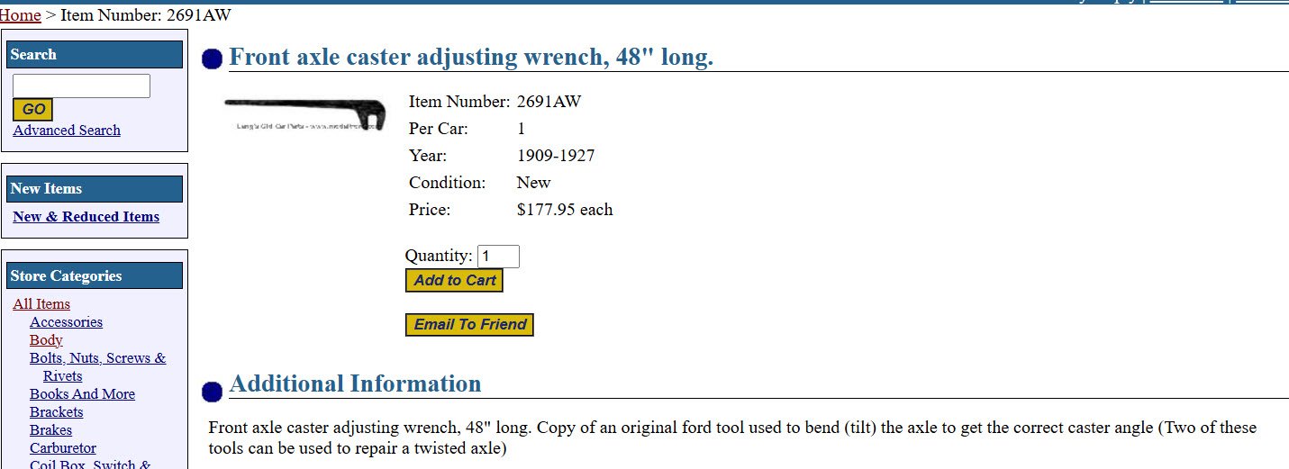

Ford made a tool to adjust caster...
(picture lifted from Lang's Old Car Parts online catalog)
Keep crankin',
Eric
Keep crankin',
Eric

That's a pretty cool tool to have, but it's going to more than double in price to get it to my neighborhood.
For those of you who have used this specific Model T tool, is the 48" handle enough to do the job, or does it need to be extended even longer with a pipe or such? I'm thinking of borrowing a large pipe wrench, but need to know how long of a handle might be necessary.
- Posts: 5310
I add a 4' pipe making the total about 6'.Eric Sole wrote: ↑Fri May 09, 2025 6:39 amThat's a pretty cool tool to have, but it's going to more than double in price to get it to my neighborhood.

I went to Harbor Freight and got 36in pipe wrench put a 3ft pipe on it and that worked great.
Eric Sole
Topic author - Posts: 153
- Joined: Mon Jan 07, 2019 4:25 pm
- First Name: Eric
- Last Name: Sole
- * REQUIRED* Type and Year of Model Ts owned: 1927 Roadster
- Location: Barcelona, Spain
I found a 36 inch wrench online for about 60 bucks, but it's got an aluminum handle. Sounds a little scary, but maybe it'll work for a one-time job.
Has anybody used a pipe wrench with an aluminum handle for this job before?

- Posts: 7345
Eric, The photo shows the ball forward of the socket, but not by much. Was it the same once you had the body on the frame and the fully assembled motor in place? This will add considerable weight to the front spring, making it sit lower. From there it should not take much to set the ball home.
You mention adjusting the steering linkage in the rebuild. If you are talking about the tie rod, its length can be adjusted, but it does not take out any wear. Only spindle new arm bushes and pins can do that, if the eyes at the end of the rod are in order. Then the tie rod is adjusted to get the correct toe-in.
Hope this helps.
Hope this helps.

Just for the record, my car was fully assembled (except for the top) from the start of this post. The component pictures are from the restoration process.
I raised the front wheels off the ground, checked for any play in the steering and found a little knocking noise when turning the steering wheel back and forth. As it turns out, I had fitted the steering rod ball cap ends with the inner concave surfaces painted. The paint had begun to wear through, effectively creating a loose fit at these two points. I cleaned the paint off, regreased and refitted the caps. No more knocking noise, and the steering mechanism moves freely and smoothly left and right.
I had loosened the spring clip in the hopes that things might move rearward and help the wishbone to align with the ball socket. I then referred to the Ford manual for reassembly: Since it says “draw nuts down tightly”, I did just that and found that the nuts went further onto the spring clip than previously. I added a couple of washers to the spring clip nuts to align the cotter keys with the castellated area of the nuts. Maybe I didn’t apply enough pressure during the assembly during the initial reassembly after the restoration or perhaps the spring has flattened out a little since the re-arching.

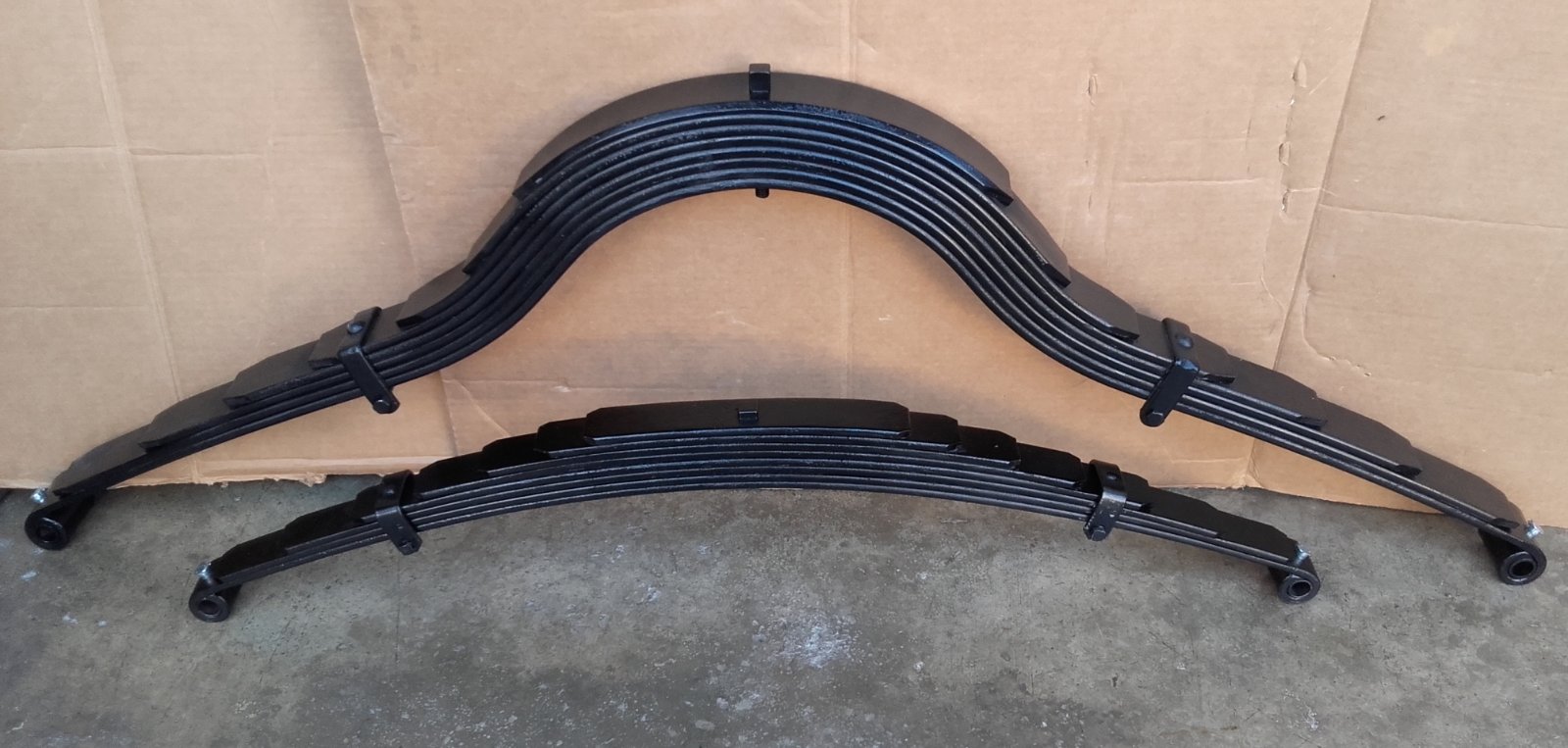

So, on the subject of re-arching the front spring. The car may sit higher than when I left the factory, I can’t be sure because I don’t know the standard height of the 27 Roadster. I used an extendible stick to measure from the floor up to the bottom of the frame, just behind the riveted end piece and in front of the screw holding the hood shelf. You can see the orange handle in the picture. The measurement at this point just after assembly of the car was 22 3/4 inches and now, after driving around a little is 22 ¼ inches, so it has dropped ½ an inch. Maybe it will settle in a little more. If someone has the correct factory frame height specs for the 1927 Roadster, I would appreciate seeing them in order to know if I will need to “un-arch” the front spring.
I also took a measurement at the bottom of the starting crank on my car which is 19 3/4 inches in case somebody might have a properly arched front spring and the chassis height is correct and they want to send me their car's height at this spot, this is an easier place to access since it doesn't require getting underneath the car.
It’s been rainy and I don’t have the top on, so I have yet to take the car out and see if the tightening of the spring clip has fixed some or all of the squirrelyness. I am hopeful for a marked improvement in the handling, even if the caster is only 2 degrees instead of the 5 1/2 degrees cited by Ford. This will be duly dealt with as soon as I can locate a large pipe wrench.
To be continued…
To be continued…

You can expect your T to be squirrely until you get the cant back to 6 degrees.
Removing the paint made the ball joints loose, enough for a knocking noise - they aren't tight enough. Grease has become a temporary buffer/filler. The slop remains.
I wouldnt sweat the spring arch. It is what it is now.

Can’t tell from your pictures, but it that axle a real 26/27 Front axle? I have had more than one person bring me a front axle off their 26 or 27 to fix and the axle is just a pre 26 straight axle.
I don’t know if they came that way but 26 was when Ford went to the lower front axle. Maybe the axle was changed over the years, who knows. Just asking. Dan

The front axle has been on this car since at least 1965. I think they are interchangeable for all model years.
The spindles are 26-27 style, so the axle stub is dropped 1 1/2" instead of being placed in the center of the spindle like the previous models were. That's what gives the later cars that sporty, lowered chassis look

Thats part of it. Also the spring has much less arch. The front spring looks near flat straight.
- Posts: 4512
Yes. As I mentioned, and as John has mentioned, the 26/27 spring is much flatter and the arch is more in the axle beam than the spring. I measured the distance from bottom edge of the front crossmember to the top of the axle on my '26 Fordor. It's roughly 2-1/4". The same dimension on my '25 Touring is about 3-1/4".speedytinc wrote: ↑Sun May 11, 2025 3:47 pmThats part of it. Also the spring has much less arch. The front spring looks near flat straight.
Have you double checked your toe-in measurement?

Ken Buhler
- Posts: 562
- Joined: Mon Jan 21, 2019 4:14 pm
- First Name: Ken
- Last Name: Buhler
- * REQUIRED* Type and Year of Model Ts owned: 1927 Roadster 1927 Coupe
- Location: Kelowna B.C.
- Board Member Since: 2012
Maybe this will help.
Work honestly
Stay true to your word
Get the job done right

Is that Ford info? I have the Encyclopedia, but never found this kind of information. Fantastic data to work with.
Thanks very much Ken.

Removed the front spring and took measurements against the values on Ken's table:
The width between center of eyes is spot on.
The height is 8mm / 0.315 inches higher.
Since the car has already settled 0.50 inches since I started driving it (less than 50 miles), I'm counting on the spring settling into its proper height all by itself.
Again, thanks very much for the information Ken.
