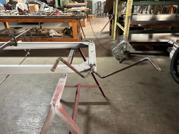

Made new brake release rod after straightening hand brake lever.-

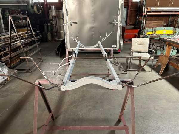

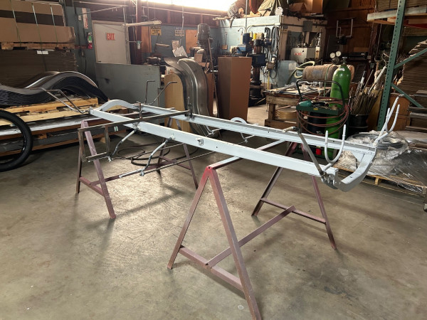

This keeps the top of the frame rails from flexing out or in. Now if I can just get the r/b truss rods I can start to mount the fenders and aprons. Then I can build the rest of the butterfly irons upward arms.
I got the bushing on the lower d/s. THE WORST JOB of this whole build. Fitting the U joint is simple. Put the axle back in the vice, split the halves, fit the pinion to the ring, removed the d/s. Siliconed the halves and bolted together leaving 4 front finger tight. Put the axle on the floor, siliconed the spool at the front and rear. Then dropped d/s over studs while guiding radius rods at top. Tighten everything up and wa-la . It is too heavy for me to lift so it will have to sit till Monday and the kids can put it back on the table.

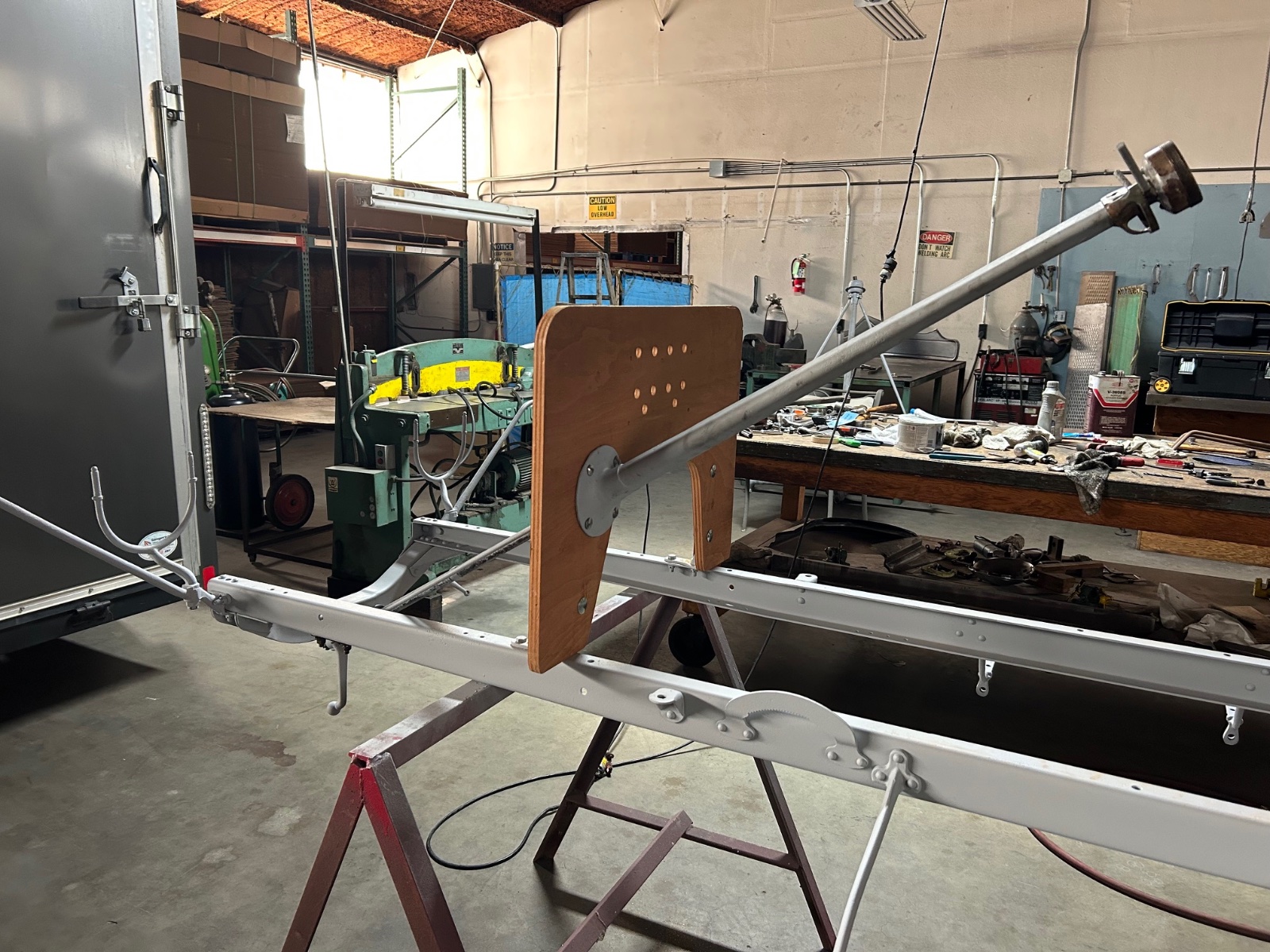

With the firewall in place I thought I might as well fit the steering gear in place. Center shaft was tight last 2” into housing, so I figured I got solder into the gear head opening. I’ll have to ream it when it comes back apart. Lower steering to frame bracket is another Tom Manochi piece. Fit beautiful.His parts are so nice.
Topic author - Posts: 3616
- First Name: Tom
- Last Name: Rootlieb
Re: New project.
You really get a sense of how long the Torpedo column is when you step back and realize it’s length is more than half the length of the frame.

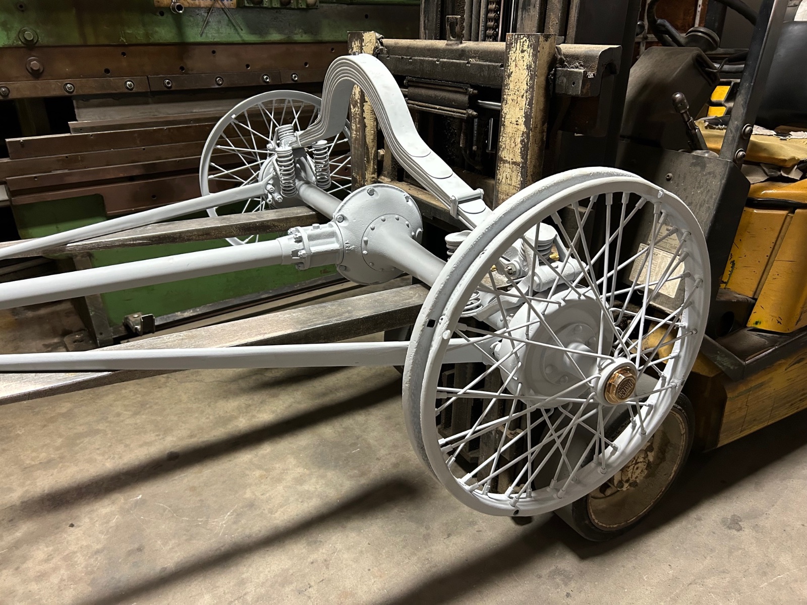

I have always liked the extra cushion you get from Float-A-Fords on the rear of a light bodied T, so I put them on this one.
- First Name: Tom
Re: New project.

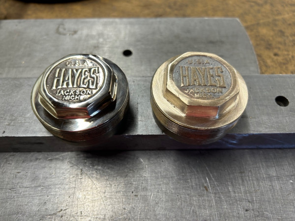

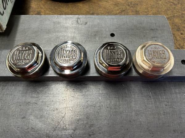

I picked up a set of Hayes Wire wheels from a fellow member on this forum. He was helping a widow sell surplus parts her husband had leftover. He said they looked pretty good, but didn’t really know anything about them. They looked to be in storage a long time. When I cleaned them I discovered they had been respoked and trued. They also came with a set of repo cast hubcaps, so I debured and polished them.

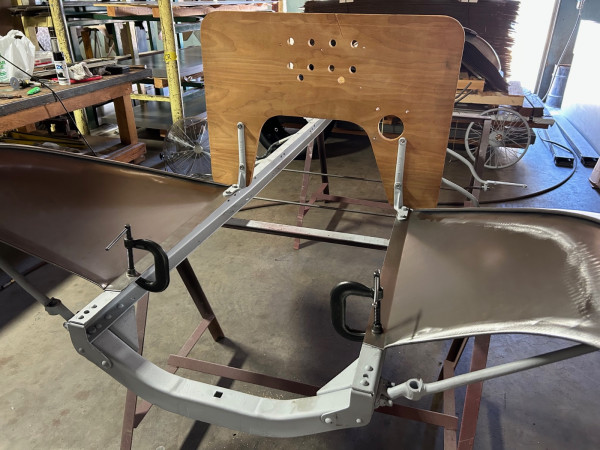

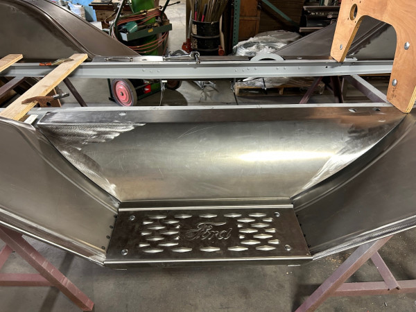

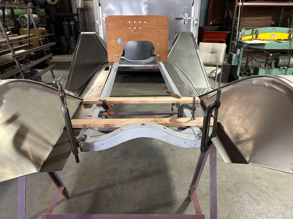

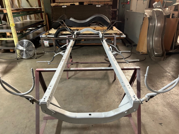

So finally starting to fit sheetmetal. Discovered the left frame rail was a 1/4” ahead of the right one, so we placed the frame catty-wampus between a 100 ton press brake and a forklift and with a few nudges we were back in square. The firewall has to be square or nothing fits.I will have to go back and check the running board brackets as well. But starting at the front, everything looks good.
- First Name: Tom
Re: New project.

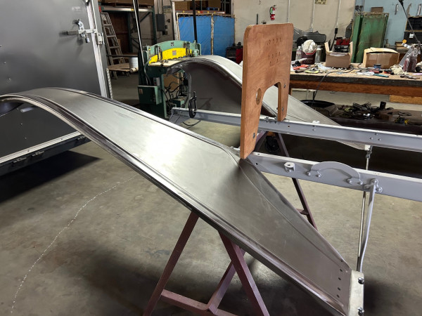

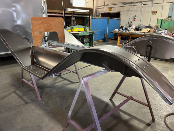

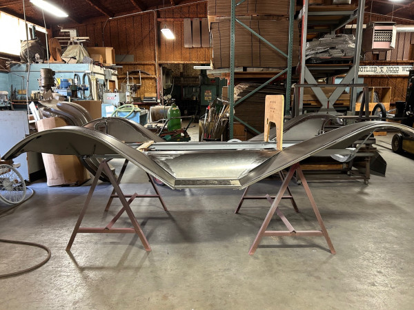

Then prop a rear fender into position. Then cut the running board blocks and drill them.
- First Name: Tom
Re: New project.

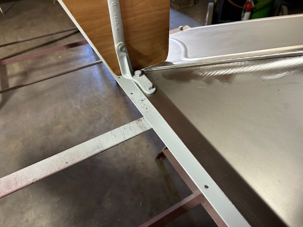

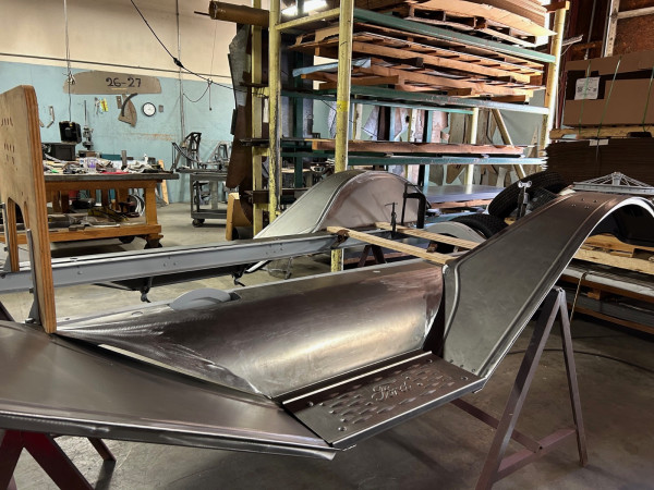

With both rear fenders propped up and pre drilled for the running boards, you can put the running boards in position sandwiching the apron tail between the fender tab and the woodblock. They will come off and on half a dozen times for reshaping before they will sit fairly good.
- First Name: Tom

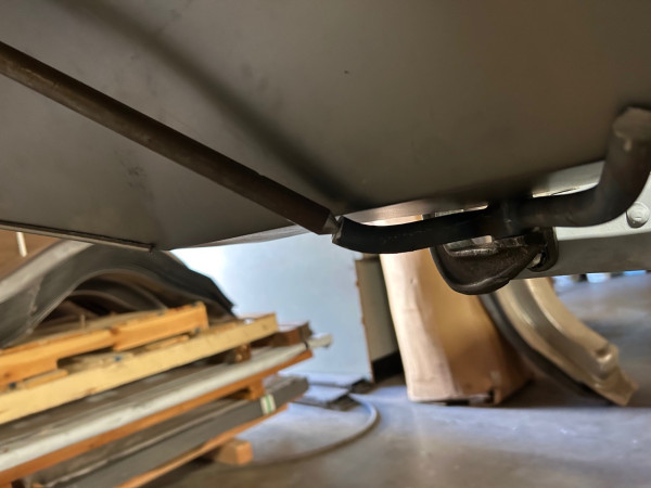

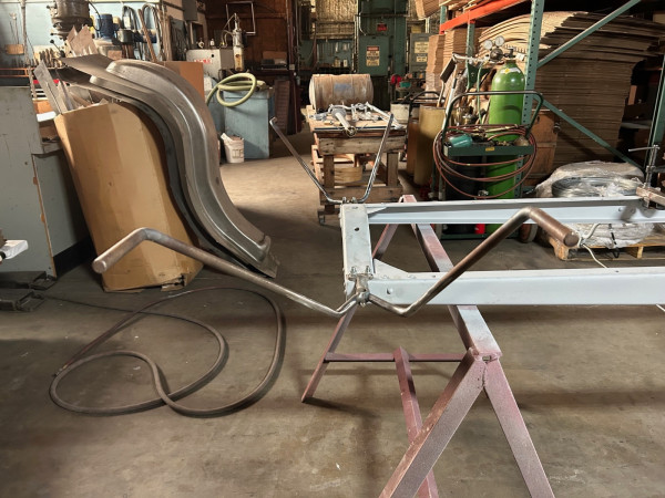

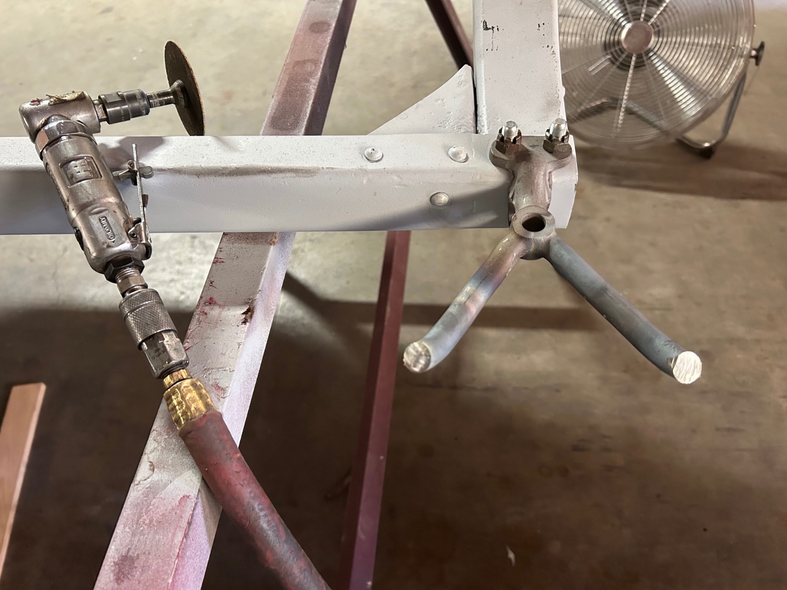

The last hurtle to getting the sheetmetal on the chassis is the rear fender irons. You can see the casting inside the rear fender well. Now we need to make the upper section of the iron that fits into the fender bracket and welds onto the casting at the other end. You need to have the fender exactly where you want it to stay so the the iron doesn’t pull it out of shape. Once these are made I will go back over all the brackets and fine tune by relieving stress and double checking alignment.
- First Name: Tom
Re: New project.

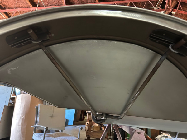

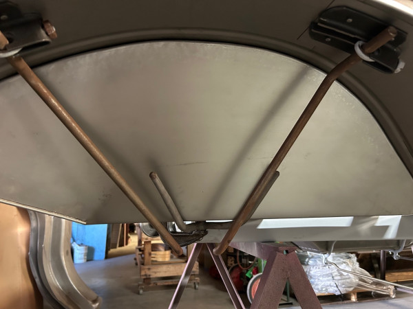

So I made the top arm extension pieces for the butterfly irons and bolted them into the fenders to see how they would mate up with the casting arms. I had to heat the casting arms and bend them down as they were rubbing against the skirt.
Next I cut off the casting arms where they turn upward with a cut off wheel.
Then reassemble everything, mark the extension to cut it off and grind it to a point.
Tac everything in place and carefully disassemble everything again. Off to the table to weld everything, then grind and buff the joints. Bolt the bracket on the frame and heat the end sections to be level and square and matched side to side. Mount the fenders again to see how they look. Usually takes some pulling, heating and relieving stress to get thing right.-

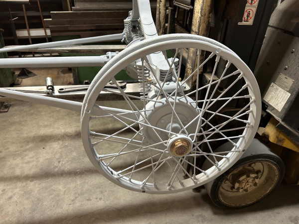

It took all day to do this. It’s 105 so I had to take some water breaks, but the good thing it’s done. I’m getting closer to finishing the first step in this build.
Should be on wheels in a day or two.-
