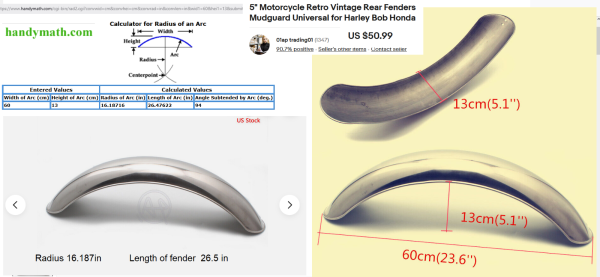

- Posts: 6380
Re: Ranch Doodlebug Build
Where did you get the cycle fenders & what are the dimensions? Been looking to get some
Topic author - Posts: 4371
- Last Name: Chaffin
- Location: Lake Elsinore
I made them. About a 24" radius. Modified early fender brackets front and rear and attached with threaded rivits.
