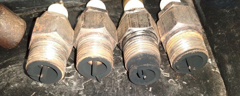

I planned on doing a compression test and pulled the plugs: I found carbon fouled plugs, gapped to .025"
The Manual says 30/1000" or 1/32" (.03125")
Champion X says .025"
Somehow the lean-rich mixture was set to 6 turns open.
The compression gauge itself, does not hold pressure any more. So I plan on replacing it. My understanding is that opening the gap will help reduce carbon fouling and that I should gap the plugs to how they work on my T. I set the mixture to 3 turns open and changed the spark plug gap to .031", then reassembled everything that was undone. I probably won't be able to test it again until Thursday night.

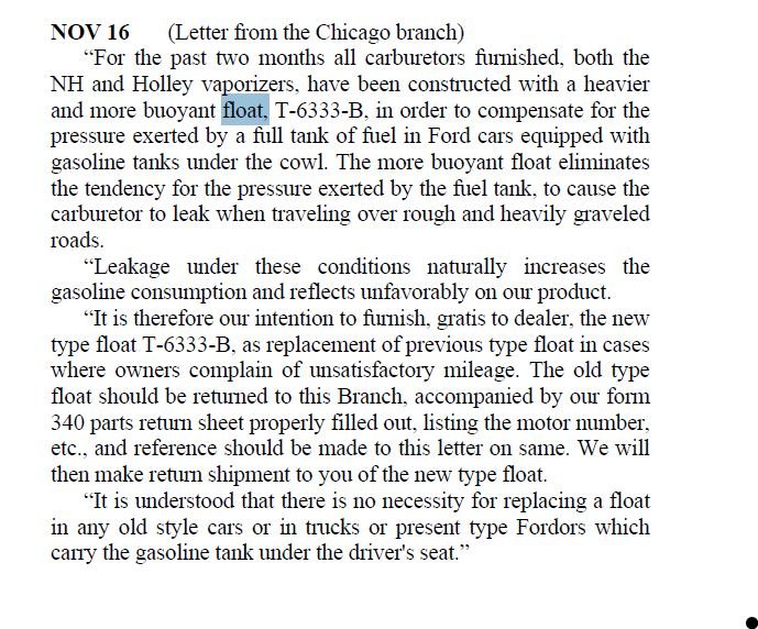

Your float is not applying sufficient pressure to close the float valve. There may be dirt in the float valve keeping it open, the float may be binding on the side of the bowl or the tab on the float may not be shaped well enough to lift the float valve's needle high enough to shut off the fuel flow.
You don't have "extra pressure" in the cowl tank, but you do have "sufficient pressure", and it isn't enough to overwhelm a carb if the carb is clean and working properly
- Posts: 5248
Re: Factory *spark gap* Low vs. High head
Improved T NH carbs had a larger than normal float to work with the extra head pressure.
Maybe a contributing factor, although a lot of improved T's out there are running satisfactorily with the earlier float.
- Posts: 6793
the larger float came about to solve rich running on rough roads. I think our driving environments are such that the smaller float suffices fine in most circumstances. Most people don't know/care/need the thicker float, but when it is needed, it is needed. I suspect that the Oregon folks who do a lot of off-roading in "T"s either have, or could use the extra large float, for instance.
Additionally, the improperly designed float valves sold by most vendors have such a tiny through-hole that this naturally reduces the effective head pressure gained by cowl mounted tanks and thereby naturally reduces the need for the extra buoyancy the larger float gives. This is primarily why most folks with Improved Fords don't see a need for the thicker floats...they are already suffering from restricted fuel flow in the first place.

The several "larger" floats I've ever recovered were from Vaporizer carburetors - never removed one from an NH.

Cleaned out the sediment bowl - found a little debris.
Cleaned out the carb bowl - found a little debris.
Does not have the larger T-6333-B.
Float needle seems to be almost buried above the surface.
Tang on float was not making contact with needle anymore.
Vern (Vieux Carre)

In case someone missed it, the carburetor has a "NH" tag on it yet there is what appears to be a "G" steel needle. I checked my email receipts from years ago and packing lists. All I see if stuff purchased for "NH" but I don't even see that part number listed in my records anywhere. So, I think it must have come with the Holly, and that is why it was sold to begin with. Maybe I'm wrong, that this is the correct part but I certainly knew next to nothing back then. Anyway, I ordered the 6210 and 6212 this morning, and gaskets.
Vern (Vieux Carre)

Changed the oil, not so much for fear being washed by gas, but for soot. Amazing how dark the oil was only after five miles and this was after a complete tear down. We had to rebuild another engine this year from soot blowing out the tailpipe, into the oil in only 100 miles (different Ford). Filled it with 3-3/4 quarts and nothing came out the top petcock. After a while, put in the last cup and then it dripped out. The bottom plug did not fit any wrench and the closest thing was a 23mm. So, I ground it down to 7/8".
Vern (Vieux Carre)
- Posts: 8637
The oil should stay clean looking for a good many miles in a clean, tight engine that is running as it should. Plugs should not need regular cleaning, if any cleaning at all. If you are fouling plugs in normal use using modern gasoline and oil, you have an issue, either with the hardware or the operating procedure.
