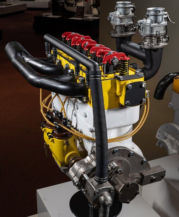

Here is one on a Model A engine with a Morton and Brett OHV conversion.0

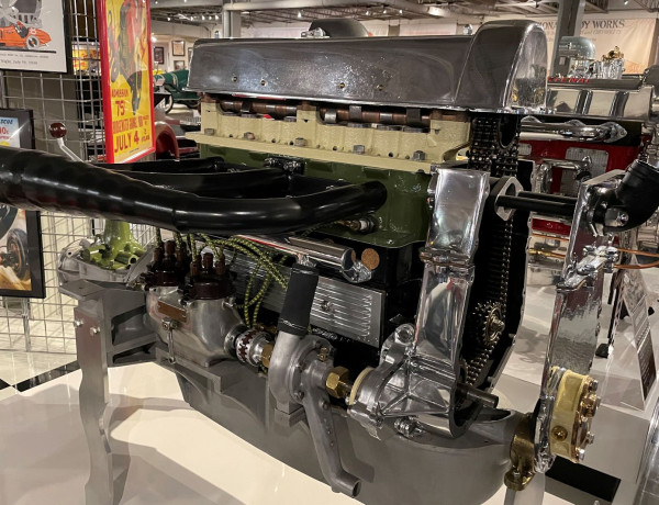

Here is one on a SOC Fronty.

I have a Delco dual distributor unit that looks like the one on the Fronty SOC. Mine is for 6 cylinder engines but I am told it is a relatively easy job to convert it to a 4 cylinder unit by changing the cams and adopting older Jeep distributor caps. It's in storage so no photos readily available.

I have a SOC Fronty like this and plan to use one of those distributors. One question I have is the gearing of the side drive. The gears I have run the side drive at engine speed. There is a normal crank and cam gear and then the side drive gear takes it back to engine speed, Were these run with a wasted spark?

Run on crank speed. No wasted spark.

Larry- these Delco distributors are designed to run at crank speed. There are 2:1 reduction gear sets in the unit to run both rotors and the point cam at camshaft speed. Hope this clarifies your concern.
