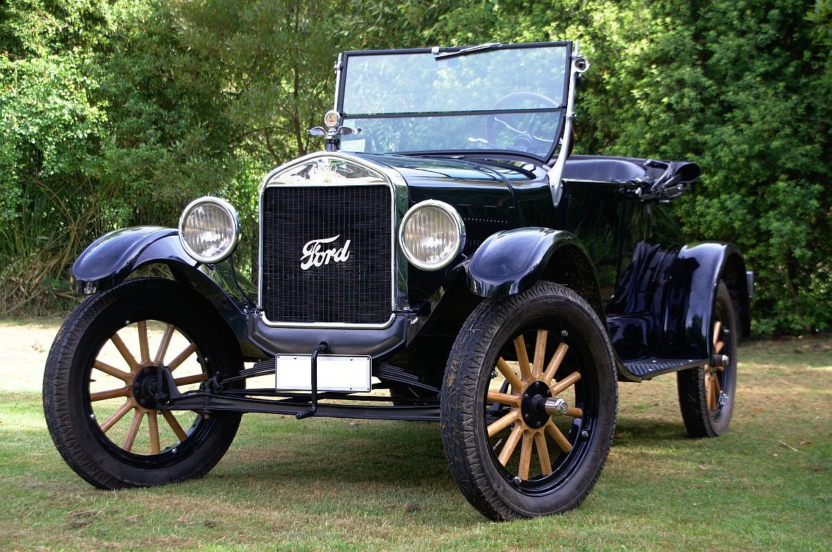

				Not wanting to hijack Scott C's thread on his 26-27 Roadster, but it prompted me to ask something I've wondered about for a while.
I have '26 (well, maybe it's a '26) 'New Beauty' runabout. It was imported into this country from Douglas County, GA, somewhere between 2011-2013.
Having looked it up I see the motor was manufactured somewhere in March/April 1925. Unfortunately I'm unable to find any chassis number to assist with dating the car itself, but from the info in Scott's thread I take it to be an early one because it doesn't have the headlamp cross bar etc.
While I'm aware that in the intervening 94 or so years the motor, and even chassis, could have been changed out I'd still like to know as much about the origin of the vehicle as possible. I'd asked previously to no avail but just in case there's anyone in or around Douglas County that could perhaps make a couple of enquiries for me I'd really appreciate hearing from you. Being many thousands of miles distant makes things a bit difficult - I do have the name of the previous US owner if that helps.
Anyway, back to where I was heading; if this is a '1926', what could be the earliest possible actual date of manufacture? Is there any way it could have had the present motor in it from new?

				Your photo shows a 1926-27 Improved model.  I can see the 26-27 style fenders and windshield frame in the photo.  The Improved models start August 1925. Your engine date will be an "early" 1926 model. There was no serial numbers on the frames till Dec 12, 1925. There are several details that are unique to the "early" models.
Some of the early details are, headlights with no bar, aluminum step plates, small holes on inside of doors. Aluminum grommet on side curtain rod hole in top of door,  4 small rivets in firewall for gas tank pad.  These are just some of the early details.
If you want to post some more photos, I can let you know what to take photos of.

Easy way to tell if your motor was original to the Improved Car that came out Aug 1925 is to look at the rear of your engine block.
There should be two threaded bosses that hold the hogs head bolts of the Improved Car transmission. If your block doesn’t have those bosses, that engine block had been changed at sometime, can’t be original to an Improved Car.

				A question - Are the brighy plated windshield posts accurate? I don't remember seeing those on a later Model T.

				Luke, It would appear that your car does not have the later front spindles, I've heard that the very early improved cars came that way. In the picture the gray one is the improved lowered one.  Jim

				If your car is a pretty much correct early production improved car it won’t be a surprise to have a few items from the previous year (25) on it.  Ford would use up earlier production parts to not be wasteful.  I think a 26 T would have a few earlier year parts for up to 2-3 months or earlier and then be a “complete 26”.   My opinion of course but it’s not uncommon for a T to be dated into the next year if it wasent sold before the new arrival cars showed up.  It would be quite possible for the next years date to be on the title and start the confusion of what year it actually is.

				given the stalk headlights, which were an early '26 feature, you may ultimately find that the windshield stantions are completely unique. They were changed for the '26 year (in late '25) and then were quickly abandoned for even heavier versions which carried through the '26 year and on through '27.
If you compare yours to another improved car and find that the base of your stantions where attached to the body, appears slightly different though stylistically similar, that is the reason.

Dan &  Larry, I'll attach a couple of photos below, from your information it seems to me that the motor may not be original as it doesn't appear to have the boss, also it doesn't have the wider brake band so I guess it means the trans is not likely to be original either?
Donnie, I'm happy to post any more photo's you think may assist. It does have aluminium kick plates, but I suspect they're repro or NOS (too good). I'm not sure about the tank rivets, size of holes (what constitutes 'small'?), and there's no aluminium grommet on the door - I assume that'd be immediately obvious?
Jim, here's a closeup of the RHS spindle. Guess you're right.
John C & Scott, I'm not certain that the windscreen stanchions are original. They appear to me to be in remarkable condition, not sure if anyone produces repro items but it's possible they could be new. Unfortunately there's no other U.S. produced model here that I'm aware of - they're generally all Canadian, being RHD, so not sure if I can compare directly?
On the plus side it does have the later/larger rear drums, but otherwise it may well be as John K describes; Ford was probably ratting around the spare parts bin and using up whatever was at hand - or it's had a good ol' mix 'n match of bits over the years. In any event from Donnie's info it seems likely to be pre-Dec '25 'cos I've never found a chassis number.
In case it helps it was also listed as a 1925 in the U.S., but I assume that was based on the engine number and nothing else - perhaps someone could enlighten me as to what GA requirements would be on this? It's registered here as a 1926 simply because everyone said that was more correct, but if in fact it was manufactured in '25 I'd have preferred to use that date. Probably too late to change now anyway, and I don't suppose it really matters.

Stanchions are made reproduction, but not in the early 26 style as photo shows.
GA is a non-title state so owner registered the body style, not the engine. Very common to have different year motors in T’s.  Assume yours has the wide clutch and brake pedals, they could have been placed by him in a pre-26 trans to look like Improved Car
Early 26 has these grommets if zinc around the curtain rod holed on the upper door frame.
