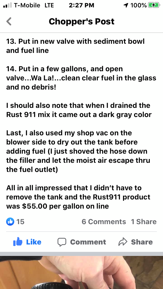

by FreighTer Jim
This guy had great results with this product.
These instructions are for a Model A but the procedure about how to flush the tank should be the same.
I am not sure if you can use the mentioned product more than once.
FJ
