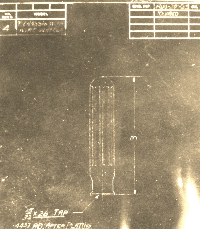

Ford originally used the longer length 777 style stems[as noted by others, the 777 stems are smaller diameter than reproductions today, original dust cap threaded right on] Ford did changed the length of the dust cap for the wire wheel cars that were fitted with tubes using the 'T.R.3' stem in the adv. below.
Longer 3" dust cap used for only wire wheel T's, because the stem stood taller in the thin wire wheel rim:
