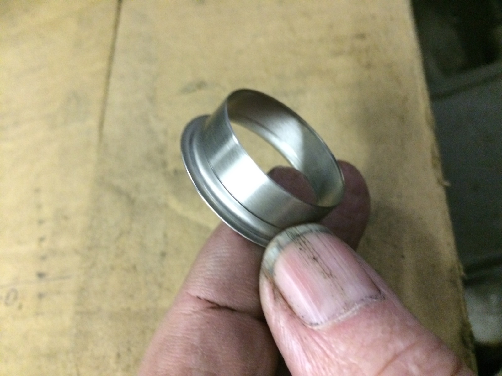

Another option to consider is to install a “SpeediSleeve” where the packing runs.
I’ve built up the worn area with “plastic metal”
and turned it down to size. Then drive on the Speedi sleeve (Timken # 99118). Now you have a surface that is BETTER than new and totally invisible outside!

if it is pitted and want a permanent, functional repair, you want this: https://www.modeltford.com/item/3012SL.aspx
Re: Crankshaft Seals
Posted: Sun Feb 16, 2020 11:42 pm
by AZTerry
Hello Bill,
Speedi-Sleeve is the way to go, and that is what Scott's link to Lang's appears to be. I have used them for this and several other applications and there is no substitute. I do not have one handy otherwise I would give you the part number. Measure the size of the crank seal surface and look up Speedi-Sleeve and determine what part number you need. Then search for that part number on the internet, nothing against Lang's but you may be able to find it for half of what Lang's (or any parts house) is asking (I usually do).
If the surface is badly worn, I build the surface up with JB Weld then use a file to dress it down to correct size before installing the sleeve using unworn adjacent surfaces as a guide.

So, to use the speedi sleeve does the crank need to be turned down so the OD of the shaft is correct once applied?
Posted: Mon Feb 17, 2020 1:38 pm
by modeltbarn
Sleeve if the crank is worn. I used a little loctite to hold it in place. Sorry, I don't recall the specific loctite I used... it wasn't thread lock, it was for holding items that were supposed to be a press tight fit but weren't. Take a look at their website, you'll find a few options, many are available on Amazon. Once the sleeve is in place you run it as-is, you don't turn it down.

Thanks Les for that part number,
https://www.oreillyauto.com/detail/b/na ... 18/2552594
I can stop in and get the store to order me 1.I like talking to the gal in there anyhow.
For this price,I would rather go ahead and use the speedy sleeve.I used 1 of a different size on the right rear axle of my 66F100 that would just not stop dripping rear end oil on the brakes.Fixed the problem!

Just ordered a 99118 speedi-sleeve from Rockauto with tax and shipped to my door for $22,69 (with discount code 129534791118895320). Thanks for the info!

Posted: Thu Feb 27, 2020 4:39 pm
by tdump
Question. The lip on the speedy sleeve,considering the crank seal is not all the way back against the gear on the crankshaft,the lip of the speedy sleeve would need to be removed once it was on the crank shaft because the seal runs a 1/4 inch or a tad more ahead of the gear right?

I thought I would bump this because of the question about the lip of the speedy sleeve.
The seal is out from the gear a bit and I don't understand what to do about the lip on it.
Posted: Mon Mar 02, 2020 7:35 pm
by tdump
Bumpty again OK I was sent a Email from a nice fellow that explained the lip gets broken off after install. So that clears up the muddy water for me.Thanks folks the help I do get here.Without help from folks and affordable parts when needed,I couldn't enjoy this hobby.
