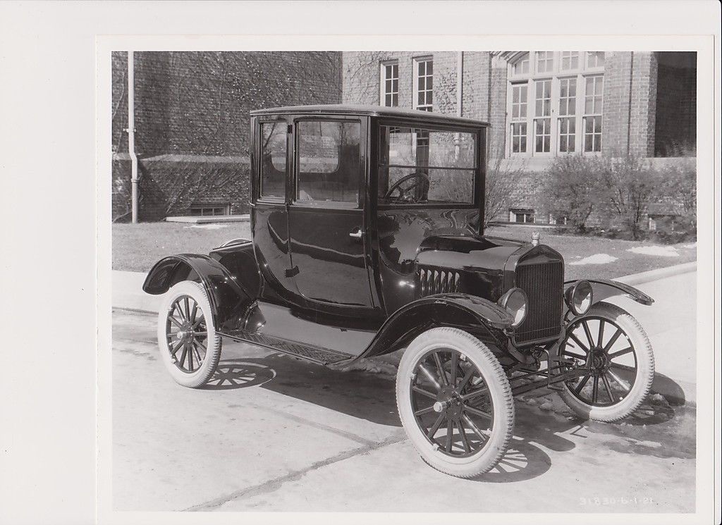

According to Parts book, listing also by B. McCalley in the C-D encylo....
The T-9066X Channel, rubber, is listed for only the closed cars. The open cars '15-'22 didn't use a rubber channel. The closed cars got it assuming for the cloth upholstery. Open cars were more open to the elements :D
With the 'new' slant windshield open cars, '23-'25, that T-9066X was then used, as the upper windshield could fold out and away, so the channel was used.
The Improved car got same, but a tad longer, part T-40324X rubber channel.
1922 with vertical style windshield.
