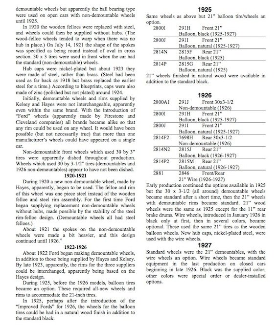

Posted: Tue Feb 18, 2020 9:54 pm
by Steve Jelf
A word of caution on the rims: eventually they were all made interchangeable, but this was not always the case. I can't tell from the pictures whether your rims are Hayes, Kelsey, Firestone, or Ford, but you may need to get a spare rim of the same make to fit your wheels. Another factor to consider is that the wheels on your car may not necessarily be the right ones for 1923. Over the course of 90+ years many of these cars have have acquired the "wrong" wheels. I would determine what the other rims are, and find a spare rim to match. This is not as difficult as it may seem, especially if your other rims are Hayes. Those are most common, and not hard to find.
