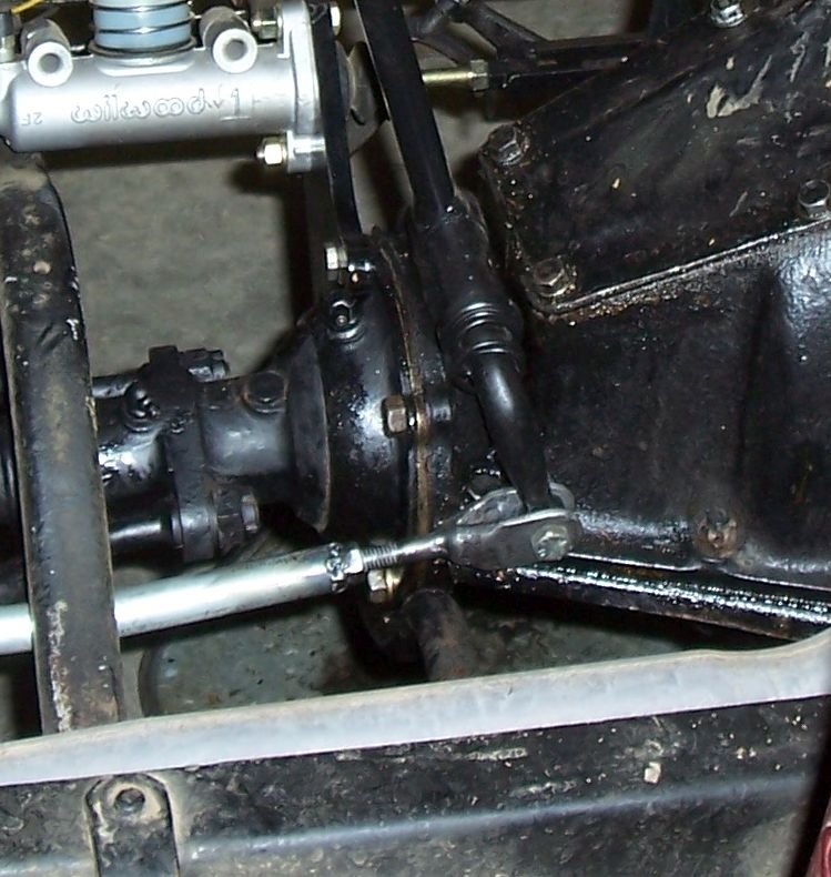

The factory part is a two piece hollow tube, somewhat like electrical tubing. The two pieces shipped easy. They were held together with a solid insert at the junction and riveted. Ends of each tube with yoke and hole to allow insertion of a clevis pin.
Shift tube support .JPG (49.16 KiB) Viewed 3321 times
Langs makes this part out of tubing, with a solid peg for riveting together the 60" long rod, the yoke ends are placed 90 degrees to each other. Could be made different ways with tubing so that you can add the bends to clear driveshaft or other parts of the chassis like the battery carrier. You do have to cut to right length or if wished, add some kind of turnbuckle as you noted. Length is determined by setting the shifter up for its high throw, at the edge of the dash or where you wish, and the shift lock in high (toward rear of car) .
