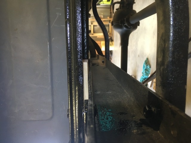

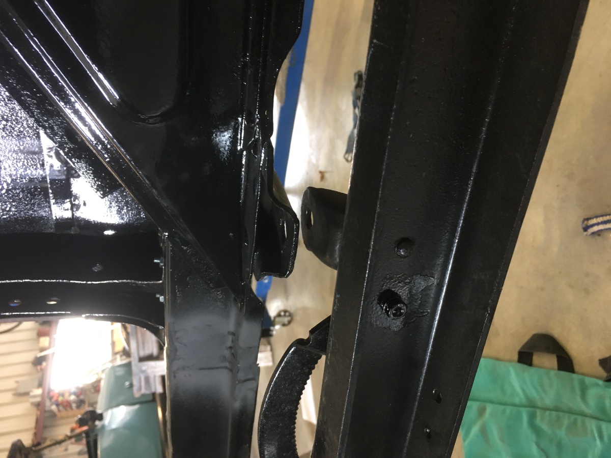

Asking this question again in this same thread, hopefully folks will read down to here. Here’s a few picts of the new body blocks under the body subframe, showing how high the body frame sits above the chassis. Should these blocks be sanded down to close this gap? Should the blocks actually be sitting on the chassis as well as the chassis mounting ears? I guess it shouldn’t sit down far enough to have the body frame member touching the running board bracket, so the block should hold it up proud of that?

Sometimes sanding down your blocks causes other problems such as the hood/firewall/radiator etc not fitting correctly. Instead use plastic horse shims that are used in commercial doors. You can buy them at the major box retailers. Will make things align better anyway, you can adjust where need be for perfect body alignment.
Hope this Helps,
Hank

Just wondering if there was a “too high” point for body to be above the chassis because of block thickness....
