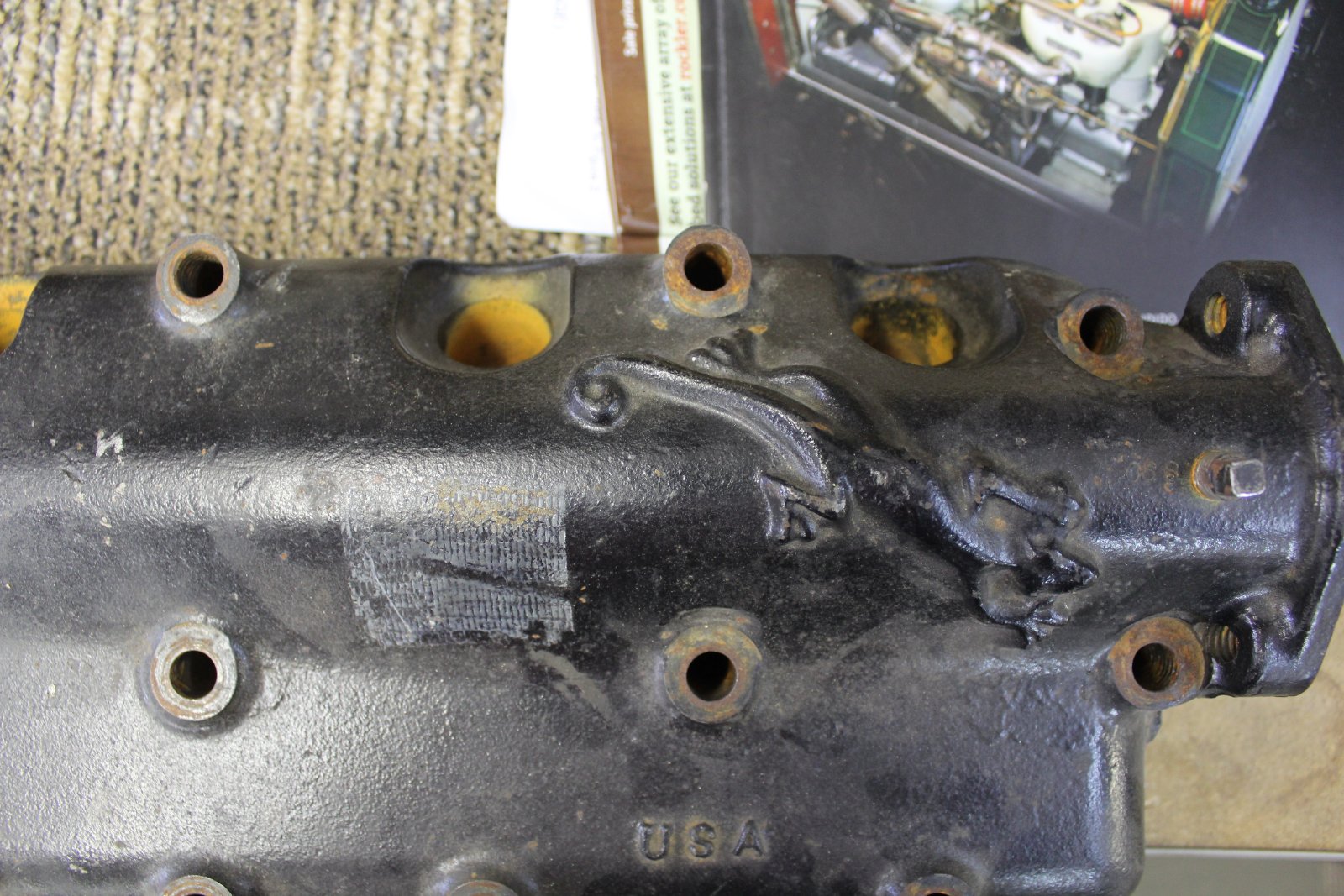

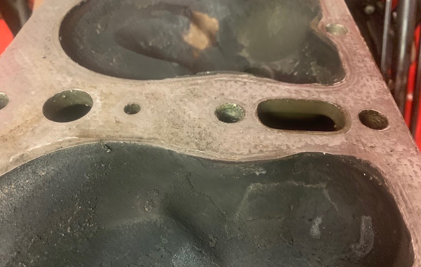

I would like to hear others' experience with and/or opinions around milling an aluminum Z-head to increase compression.
By my estimation, there is currently some 0.150" space between the pistons and the cylinder head "horseshoe" squish area. This is including the head gasket (photos below)
There looks to be ample meat in the head casting to mill, say 0.050 — 0.075 off the head.
The engine is a 1924 block with aluminum pistons, SBC valves, Stipe 280 cam, Simmons SuperPower carb and enhanced splash oiling, coupled to a period cast-iron Warford, in a medium-weight speedster.

My experience with Z head was some of the pistons caused interference, needed to grind away some alum at the lip inside the Z head. The Z combustion chamber is ‘as cast’, and each chamber is slightly different. Shaving the head may cause issues.
Changed out the Z and installed a Prus head, really significant change in performance and smoother running. The Prus head has CNC machined combustion chambers, all are identical. My preferred hi—compression head now.
