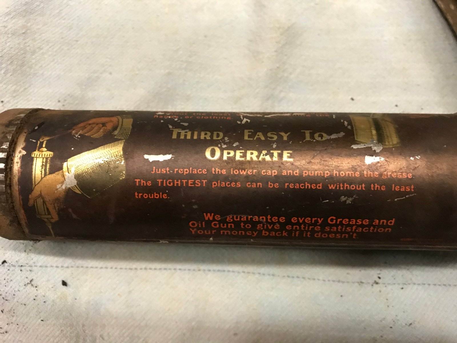

Slightly OT and not Ford, but in case anyone wondered about greasing in white cuffs...
