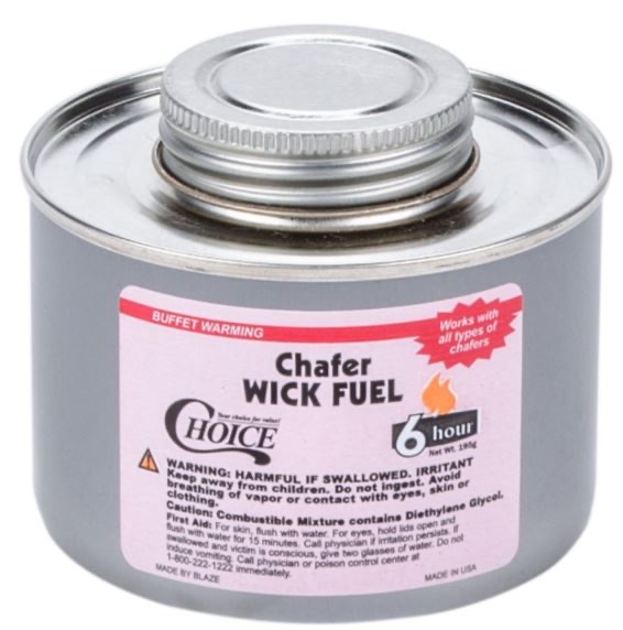

I seem to remember Sterno /Chafer lids being the correct size?

Sterno now comes in a can with a press-in lid, but that Chafer looks like it might work.

I took a Boyco lid when I went to town today, so I could compare lids on various products. Oatey PVC stuff is a no-go. Their lids are all too big or too small. The same goes for all the thinners and paint removers I saw. At the hardware store, the only place in town that I know of with chafing fuel, all the cans have press-in lids. All the B&S gas tank lids I have tried were also wrong.

I was at a Dollar Tree store last week and they had charging dish fuel in a screw top can. No idea if it will fit, but it was a Dollar.
