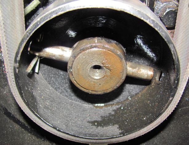

For showing too that the clock face look of your crank pulley pin works, you can see it rests at the proper spot.
Hint: If you use Dan M.'s alum flanged split pulley, the slit is right dead center of the horizontal crank pulley pin.
You may see my black ink marker spot on the slit and the timing cover parting line, I marked black ink on that too. When they were lined up, the timing tool showed exactly TDC! So you can see where another ink mark on the pulley is made at the correct 15 degrees ATDC.

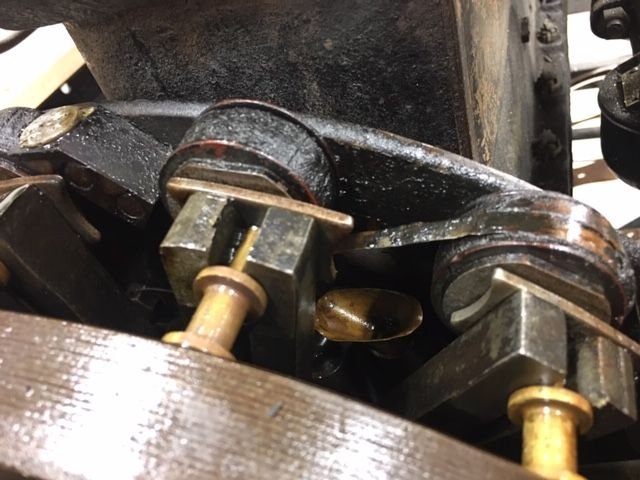

I did the 15.5 degrees ATDC. I opened up the engine top and here bellow pictures showing at 15.5 degrees ATDC at valves and the first piston. Please let me know if that make sense or I'm the left field? I want to learn .
Re: Timing degrees after top dead center ??
Posted: Thu Apr 16, 2020 11:52 am
by CudaMan
Look right to me, well done!
Now make sure that the timing lever on the steering column is fully up, and adjust the timing rod length (by bending as required) so that the end slips into the timer arm without disturbing its position.
Then, have a helper move the timing lever through its full range and verify that the timing rod doesn't touch and short out any of the timer terminals.
Also make sure that the timer terminals don't brush up and short out against the two nearest front oil pan bolts. Most folks install those front pan bolts opposite from the rest so that the nuts face down towards the ground and the heads point up. This gives a little more clearance for the timer terminals to pass by without hitting those bolts.
Once you have things set the way you want them, install your fan and belt and make sure that the belt doesn't rub on the timer. If it does, it will eventually wear a groove in the timer. To fix it, try different length belts until everything clears. :)

Technically, the .093 varies with connecting rod clearances but not much. The .093 dimension is for a stock 4" stroke and 7" connecting rod length. Changing either of those will change the amount of piston travel ATDC. When a crank is rotated 15.5 degrees ATDC the rod journal travels down .0727". That pulls the rod big end down by that amount and also rotates the rod 4.38 degrees from vertical. The piston can only move down and rod rotation adds .0204" to total piston travel. Add those to get .093".
I made an offset tip for a dial indicator that looks like the tool in Dan's post. I used that to find 15.5 degrees.
