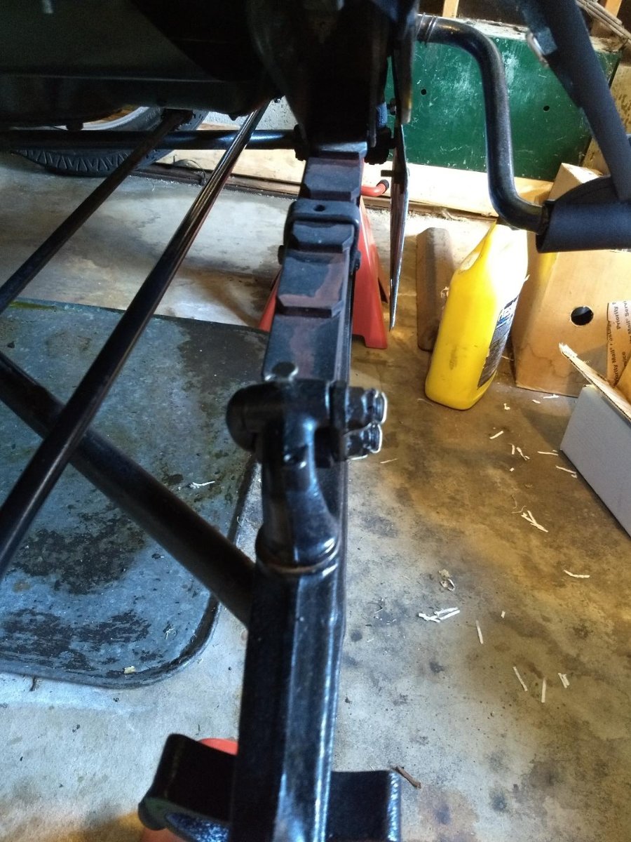

- Posts: 4381
Re: Front spring perches
Well, I have seen an axle or two, in other people's cars, with both perches being for one side. So I know it can be done. The spring is the weakest flex point in the assembly so would be twisted to accommodate the perch which would be held crooked (being angled wrong) by the axle and aided by the wishbone that is supposed to help set and hold the caster angle.
And that is what it looks like you have in the photo.
Yes, you should get that perch replaced if you can. Hopefully, if he put the perch in himself, it may be loose enough to come out easily. If the perch was a tight fit, and been in there long enough, they can be so stuck that it takes a good press and a big torch to get them out. If that is the case? You would be better off to get another good axle with two proper perches in it. They still aren't too difficult to find. You maybe should also replace at least the main leaf in the spring.
Even though it may drive and handle okay that way? It is putting a lot of pressure twisting the spring that way. It could cause the spring 's main leaf to crack and/or break without much warning. That could result in a sudden loss of control that if it happened at the wrong time could have very bad results.
Be aware, that model T steering geometry is simple, and usually adjusts and handles well as long as everything is in good condition and properly adjusted. You should check and double check all pieces and adjustments after you replace the perch or the entire axle. Make sure all bushings are good, and no excessive (even minor) play in any joints. However, occasionally, a mis-mix of parts can result in a front end that measures fine, but works lousy. It doesn't happen often, but can. And usually shows up after changing a bunch of stuff. (Often, it is caused by a slightly different camber forged into the spindles.) Not common, just be aware and watch for it after making changes to fix the perch.

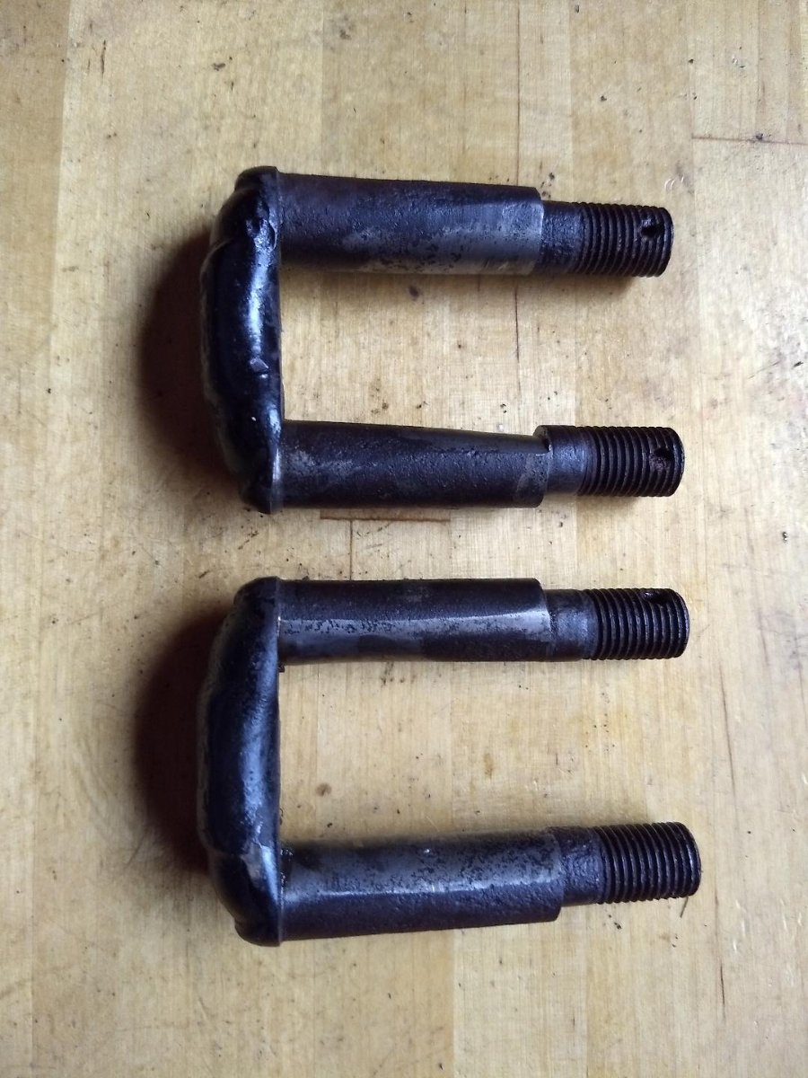

This is what my spring shackles look like. The unusual wear was probably caused by having the wrong perch on one side. I snapped off the offending perch trying to get the nut off.

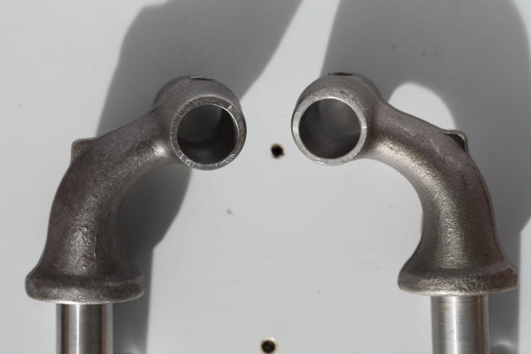

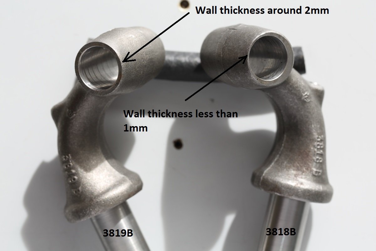

The perches have part numbers on them. The odd numbered perch is left. 3818 right and 3819 is left.

My 24 Tudor had two left perches on it when I got it. I drove it for a year or two before someone noticed the problem and pointed it out to me.
With the two left perches it had a noticable shimmy after going over speed humps.
If you get a new perch it is a good idea to check it as some of the new ones are not machined very well.

I think the duplicating manufacturers found a warn perch and then made them that way.
