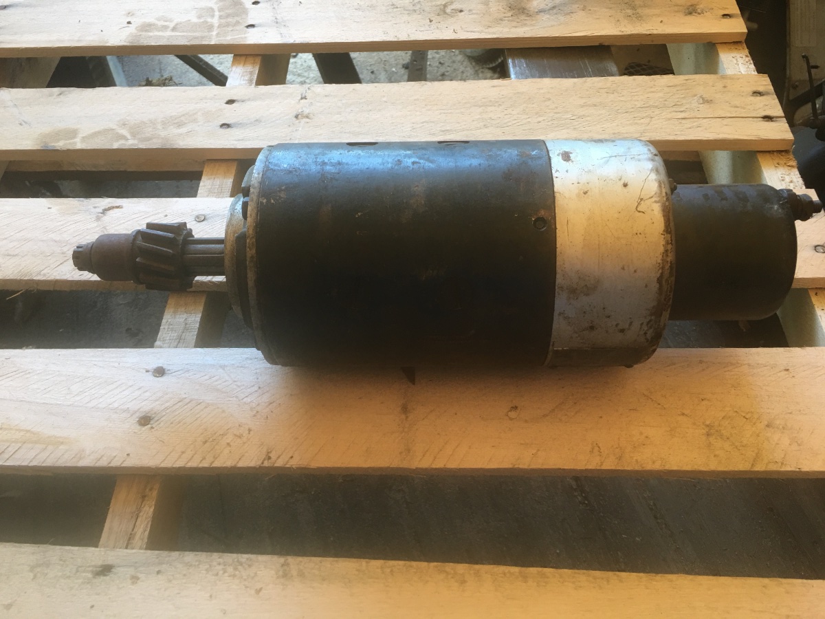

Unknown starter
Posted: Sun Apr 19, 2020 12:33 pm
by Randall strickland

Tried to do a Google search came up nada! Lots of electric motor starter relays however! ;)

Does it have mounting holes in the gear end of the motor or?
Re: Unknown starter
Posted: Sun Apr 19, 2020 6:01 pm
yes ,mounting holes in gear end

Randall,
Look for an engine with a helical cut ring gear on the flywheel and you will be getting close. ....N.

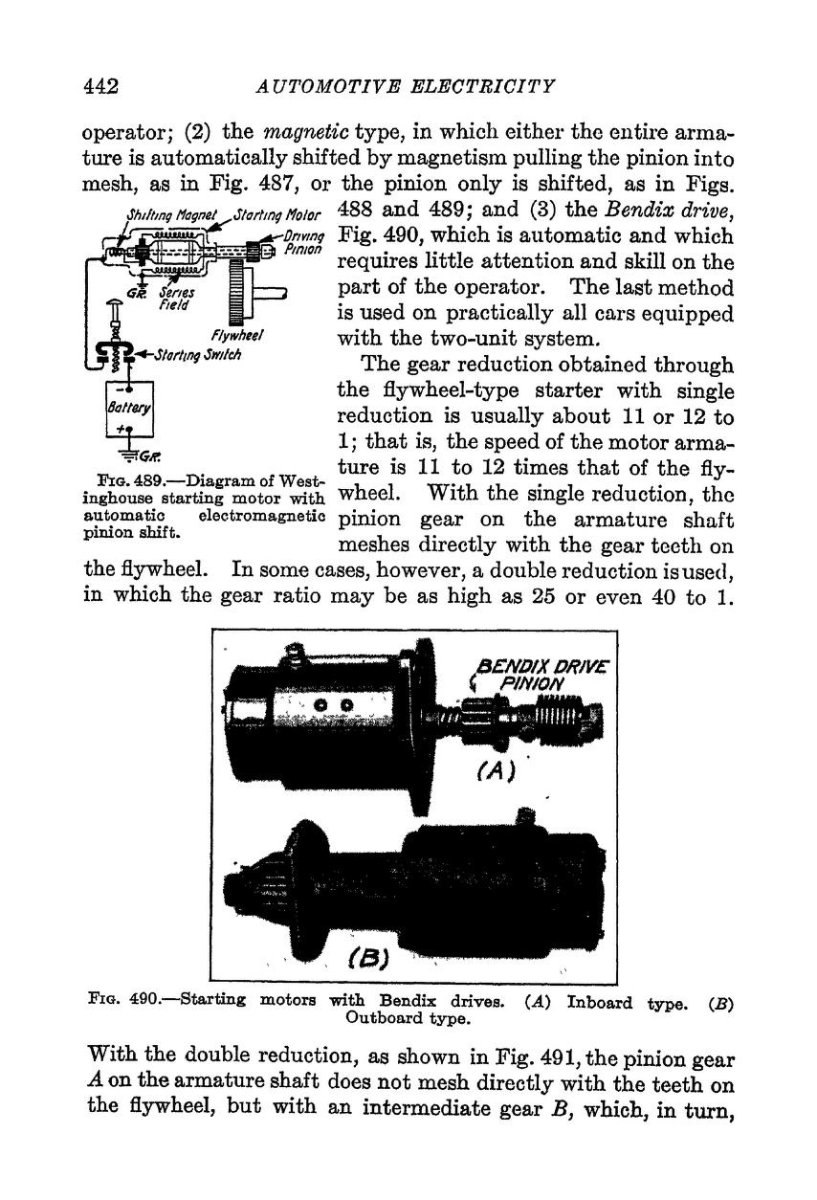

Figures 488 & 489 below show some information on the Westinghouse system, from Automotive Electricity 1925.
https://archive.org/details/in.ernet.dl ... stinghouse

Re: Unknown starter
Posted: Mon Apr 20, 2020 11:55 am
by DanTreace
That Westinghouse starter motor is from the mid 20's, they had earlier magnetic pinion shift starting motors in the 'teens, one from 1913 is a much larger square housing, and separate magnetic shift box.
