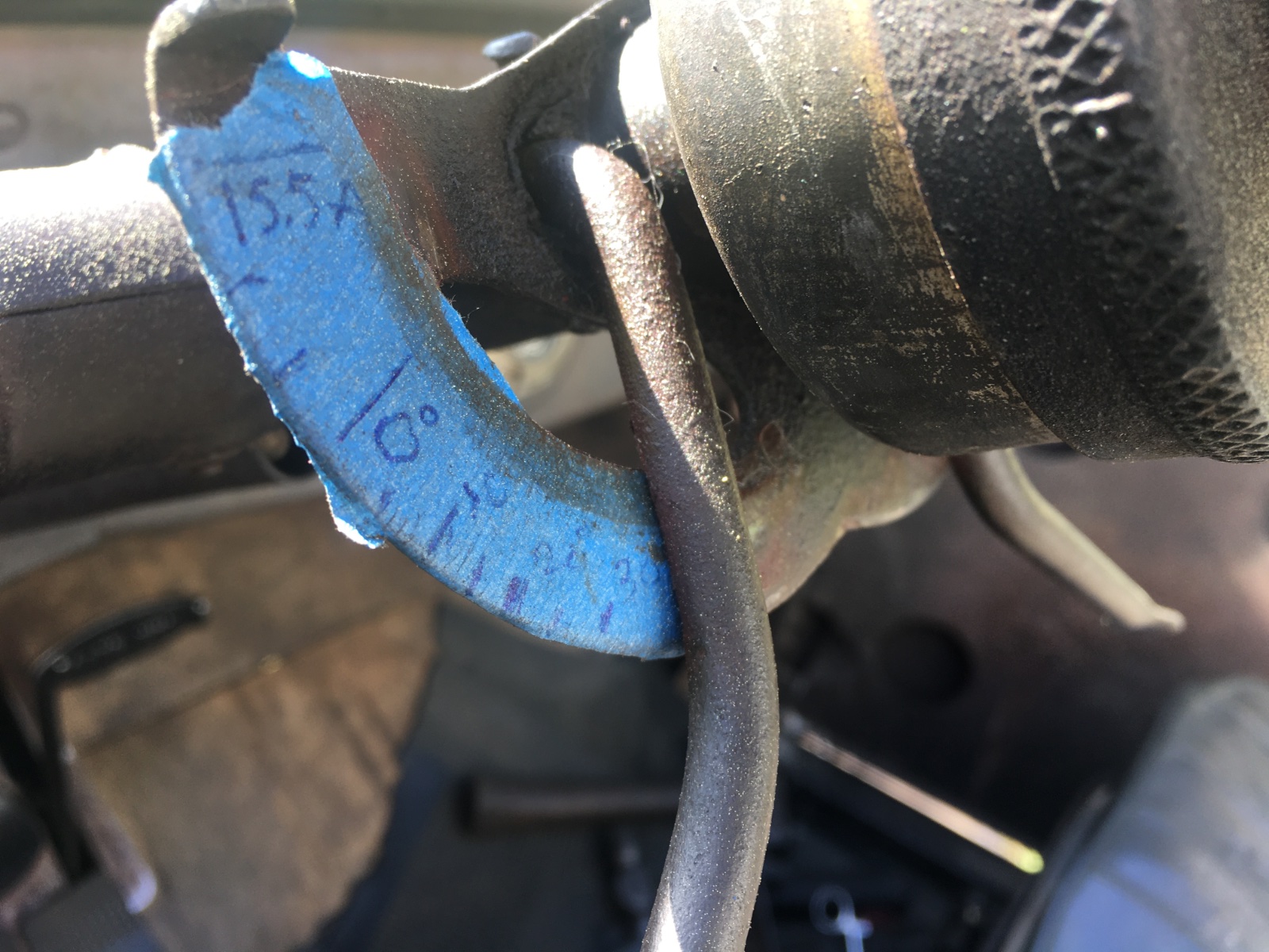

Another thing I am now doing which is great fun:
After setting my timer I pulled the painters tape off of my quadrant and put fresh tape there. Then I cut a strip of paper to wrap around the pulley, marking TDC and degrees around the pulley.
Next I transferred the marks to the quadrant tape. Set the reading at the pulley, advance until buzz and mark. Done!
Now I have 15 degrees ATC (full retard) marked, TDC marked and degrees Up to 30 degrees of advance marked.
This allows me to know where it is safe to set spark for cranking (it cannot kick back if it retarded to any setting before zero degrees, TDC) and what advance works best. It makes understanding your car easier. I may even see if I can identify the exact position for the three settings you get from mag output.
Tape marked with degrees after TDC (retard) and degrees before TDC ( advance)
Paper strip makes temporary degree wheel
Mario, a straw and 3:30 will get you close enough to get the job done. It will always be a bit more precise (well a bit less sloppy) to use a pulley marked at TDC. Just do it the way you like!
