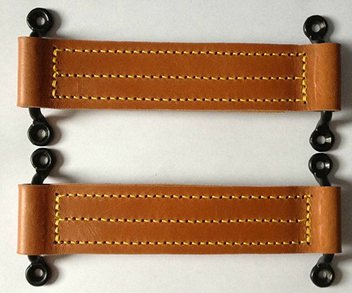

Would a 1917 Touring have had door check straps? If one is not careful it is easy to smack the doors on either the edge of the fenders (rear) or sidelamp (front).
Re: Door Check Straps
Posted: Tue Apr 28, 2020 5:42 pm
by DJPeterson
Yes a 17 would have check straps with the footman loops as shown. Material as I recall would be from leftover upholstery scraps.

PS: if you want to "dress up" your car with leather door checks, you don't need to use footman loops. Instead, you fasten the leather strap over the panels and use nickel-plated oval head screws with nickel plated finishing washers, similar to what was done with 1913 and 1914 Fords.
https://www.modeltford.com/item/3876LSN.aspx
