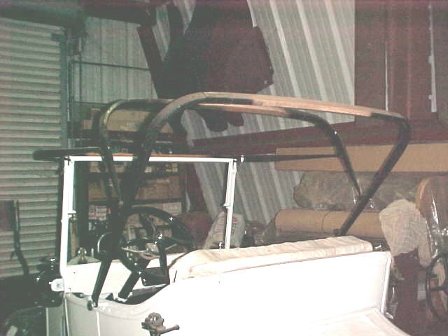

Brought to life after 50 years. The photos are how I found it almost 2 years ago and how it sits today. My uncle parked this in 1972 and it started for the first time since being parked today. So much pride. My first T. Changed the "new" oil and found a few bits. Don't think it is anything to be over concerned about.
[image][/image]
[image][/image]
[image][/image]

I'm sure you are already aware that the front top bow should be repositioned from the low pivot hole on the rear bow to the higher pivot hole on the middle bow. But if someone new to 1923-1925 roadsters is looking at the photos it could be helpful to them. The front bow should be in the lower hole on the rear top bow when the top is down so the front bow didn't stick out a lot further back when the top was down. But the front bow shuold be moved to the middle bow when the top is up to make it easier to enter & exit as well as for clearance for tall people etc. The photo below captured from Phil Mino's (R.I.P.) website show that clearly:

I got the car back from the friend who did the body work with it set up like you see in the photo. I did the mechanical work and took to family upholstery guy. Obviously, none of us knew what we were doing when it came to the top. Wow, do I feel stupid. This is totally on me as I should have caught it when coming from the body shop. So the obvious question is, "When I correct the error, will the top still fit?"

Still a great looking T! Industry was still learning about mass production and of course for that matter many other manufactures were looking at Ford and how he was successfully mass producing so many cars. It would be several more years before mass production started making parts so they would only fit the correct way and not several different ways. The Model T has several parts that will fit in more than one way. A few of the ones that happen often are:
The rear axle can be reassembled with the ring gear (crown gear for the Commonwealth folks) on either side of the pinion. You can even set the clearance within specs. But one way you have 2 forward speeds and one reverse and on the other side you have two speeds backwards and one really slow speed forward.
The spring perches can be installed different ways - especially if you have several to choose from you can have 2 lefts or 2 rights etc as well as installing the left and right one incorrectly. (And if you have accessory shocks/springs such as Hasslers you swap the spring perches and install them 180 degrees form normal to hook up the Hasslers. When the spring perches are installed correctly they set a positive caster for the front axle and that greatly helps the car track straight when going forward (don't back up fast -- it is negative caster and unstable going backwards). The incorrect way gives the front axle negative camber and when going forward the front wheels want to go full left or full right. Sort of like the front wheels on a shopping cart.
The front axle spindles can be installed on either side of the front axle -- they will fit and look OK to most folks. When installed correctly the threaded outer bearing (or outer cone for the earlier ball bearings) wants to loosen as the car goes forward. The washer and nut prevent it from becoming loose. But when installed incorrectly the threaded front outer bearing (or outer cone for the earlier ball bearings) tends to tighten as the car moves forward. That can lock that front wheel and or split the hub. And again if you have multiple parts (in this case spindels) to choose from you can have one side correct and the other incorrect.
So don't feel bad about the top installation. I love what John Maxwell says, "Sometimes we win -- sometimes we learn."
I suspect -- but I do not know for sure -- that if your current top was installed with the bow in the wrong pivot point, that it will need some additional material added. There is an easy way to check that. Disconnect the top from the front windshield. Get someone to help you put the front bow in the proper pivot point on the middle bow. Lower the front bow down (don't use a lot of force -- or you will rip the top material etc. If it fits -- great. If not -- many of us leave the top down and no one will notice. And if you want to put the top up -- to provide shade etc. it still works the way it is -- just duck your head when you get in and out of the car. And put that on the fix later list. You can also take it back to your family upholstery shop and have them fix it.

You have quite a few errors with your top and upholstery. Do some in depth studying and you will figure it out. I hope you can re-position the top covering so you can get it to fit. Look at lots of factory photos to begin with!
