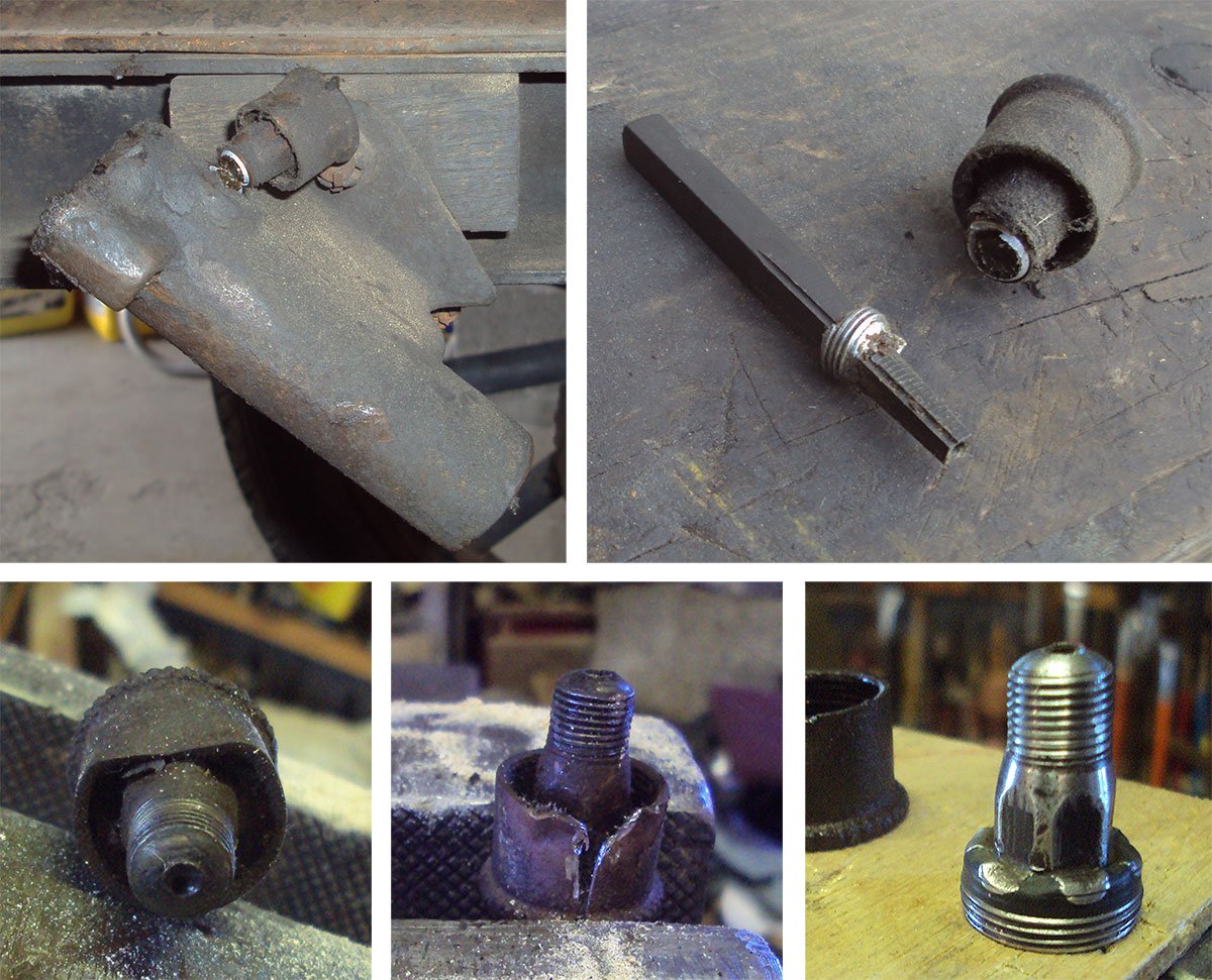

I have had trouble getting the hogshead in without tearing up the rear gasket. I cut this out of sheet to protect the gasket and help slide the hogshead past the ball cap. It worked well.
Leaving the steering bracket in place seemed like a good idea but the suspended motor got away from me and wiped out the grease cup. Oops! Looking for a spare I found this one with a damaged cup. It seemed only right to salvage the lower part and use the good cup on it. It was one of the old type with a seal.
Fortunately the cup fit the housing. I say that remembering my old friend, the late "Fireball Erickson", who insisted there were two sizes of that 3/4" thread, a large and a small. :lol: I couldn't convince him that 3/4 was 3/4.

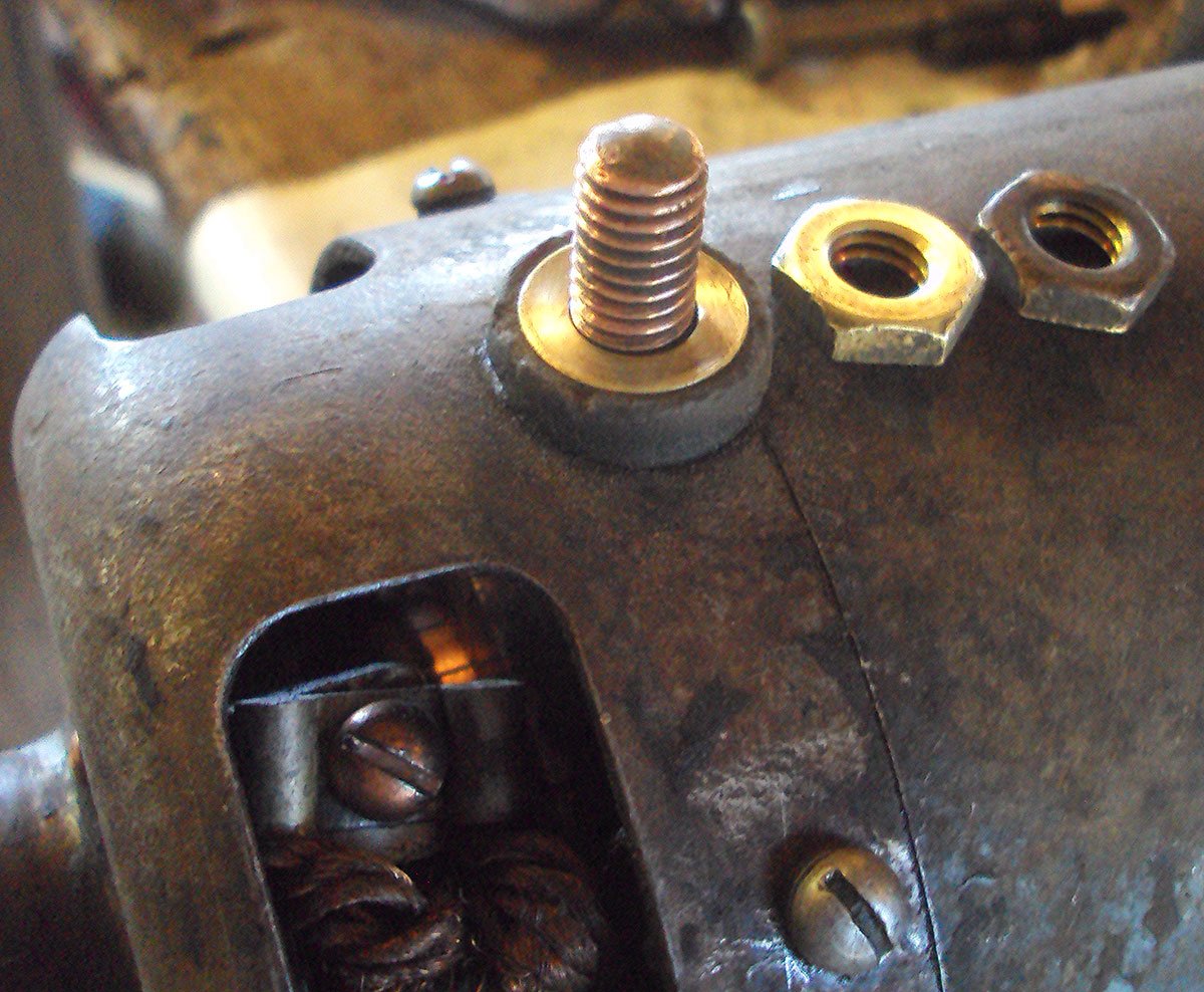

Maybe too insignificant to mention, but I will, are the starter and generator cover screws. Mine was buggered up as many are. I have zinc and nickle plated ones that would work but look out of place on this car. I decided it was worth the time to repair the slot. Metal isn't missing but pushed out of place. It isn't difficult to pound it back and file a bit to get a slot that works right. I have saved many original screws this way for what it's worth.
Also, I noticed one was coarse thread and one was fine thread. Is there anyone out there who knows or cares what is really right?

I could have had it back on the road but I'm taking time to clean things better and improve some areas. I have been cleaning all the electrical connections without disturbing the old tattered look outside such as the starter terminal. My plug wires look shabby but there is good continuity so I just clean the connector centers.
We talk about choices. The bolt and stud at left were my first quick fix to hold the wishbone cap. I hadn't planned on driving the car that much so it seemed OK. A better choice now would be to use my original studs (center). I like to have original parts if practical. But as I won't be seeing them and one hole was stripped and tapped deeper I made two new studs to go there. The old studs have grooves worn by the cap and tired old threads but they are great patterns.
Each part becomes a decision of what is safe, authentic or visual pleasing. You have to make up what is right or wrong or just what you like as you go along.
This unplanned renewal has been a great exercise and should give the Coupe several more years of enjoyable service. Maybe we should tear all the cars down every few years just for fun and safety. :lol:
