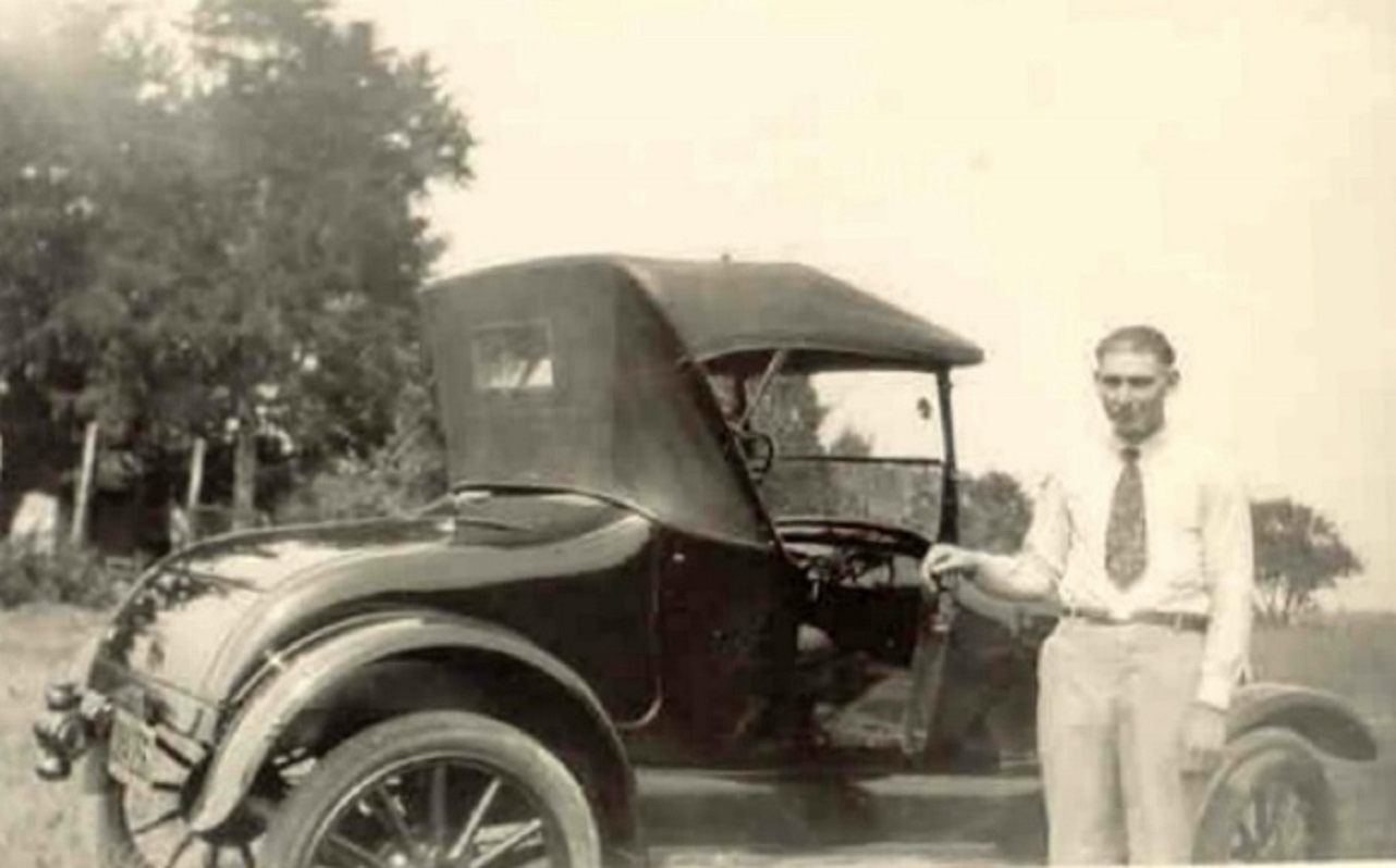

Appears the 706,408 open cars sold in model year 1926 were starter equipped and came standard with 30x3 1/2" clincher tires, as 21" split rim balloon were extra cost, but perhaps many went for the bigger nicer riding tires. Seems no record of what tire equipment supplied, so we won't know.
According to Bruce's research, only about 3,000 open cars were non-starter in 1926, and later in the calendar year these were special order only.
The non-starter got 30x3" tires in front, and 30x3 1/2" tires in rear, on non-demountable wheels, those spoke wheels had steel felloe.
No rim carrier, and kerosene tail lamp, magneto headlamps.
So this runabout was a rare bird then as now.
