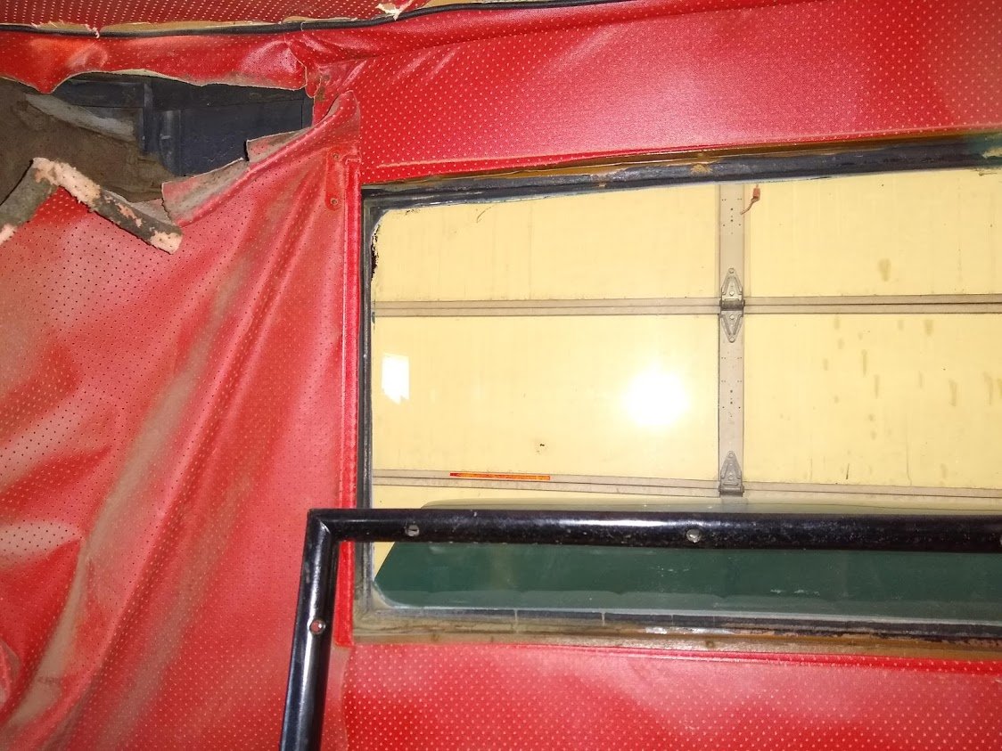

				I just took the trim off the quarter glass on my 27 coupe. The glass is held in a rubber channel, and the metal garnish holds it in place. But the trim fits over the garnish, so you install the glass before the trim.
I might remove the trim around the back glass next, if so I'll share some pictures of it.
				Re: Closed Car Rear and Side Window Installation
				Posted: Sun May 31, 2020 3:37 pm
				by Squirrel
				I removed the garnish for the back glass.
I hope these pictures help. This car has been redone at some time (red vinyl is not original?) but it appears the trim was installed as the original had been.

Thank you everyone for the pics! I now understand it to be:
The rubber seal is installed on the glass, the glass/rubber assembly is installed in the cavity in the body, and then the garnish molding is installed and screwed in to hold everything in position for the side quarter glass.
On the rear window, the glass/rubber assembly is put in place, the upholstery trim is installed, and the garnish molding is then installed to trim out the upholstery material, and also hold the window assembly in place.
