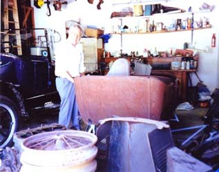

I've been playing with 1928 and newer cars a long time. A week ago, I heard about an older fellow that was having to move away, and needed to sell his T. I ended up buying it. For the past week, I've been tinkering with it, and getting a lot of helpful info from old posts on this forum. Here is a picture of the car, taken yesterday.
As you can see, it's a decent looking car, but the only things on it that have been actually fixed lately, are fresh paint, new tires, radiator, and replated shell. The rest seems to mostly be 1970s amateur restoration, and enough minor repairs to just keep it going, sort of.
The list of things to fix is pretty long...including the cracked head, very loose steering, non working magento and starter, top, and inside trim. I was able to get it started and driving. I have 4 acres in the country here in southeast Arizona that I can drive around on.
