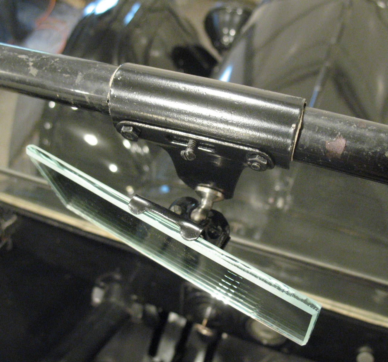

On the touring I have an old windshield mirror, also from a bunch of auction plunder.
I think new glass for it was $2 or $3. I made the clamp from a piece of electrical conduit, again with an inner tube pad to save the paint. No holes needed.
