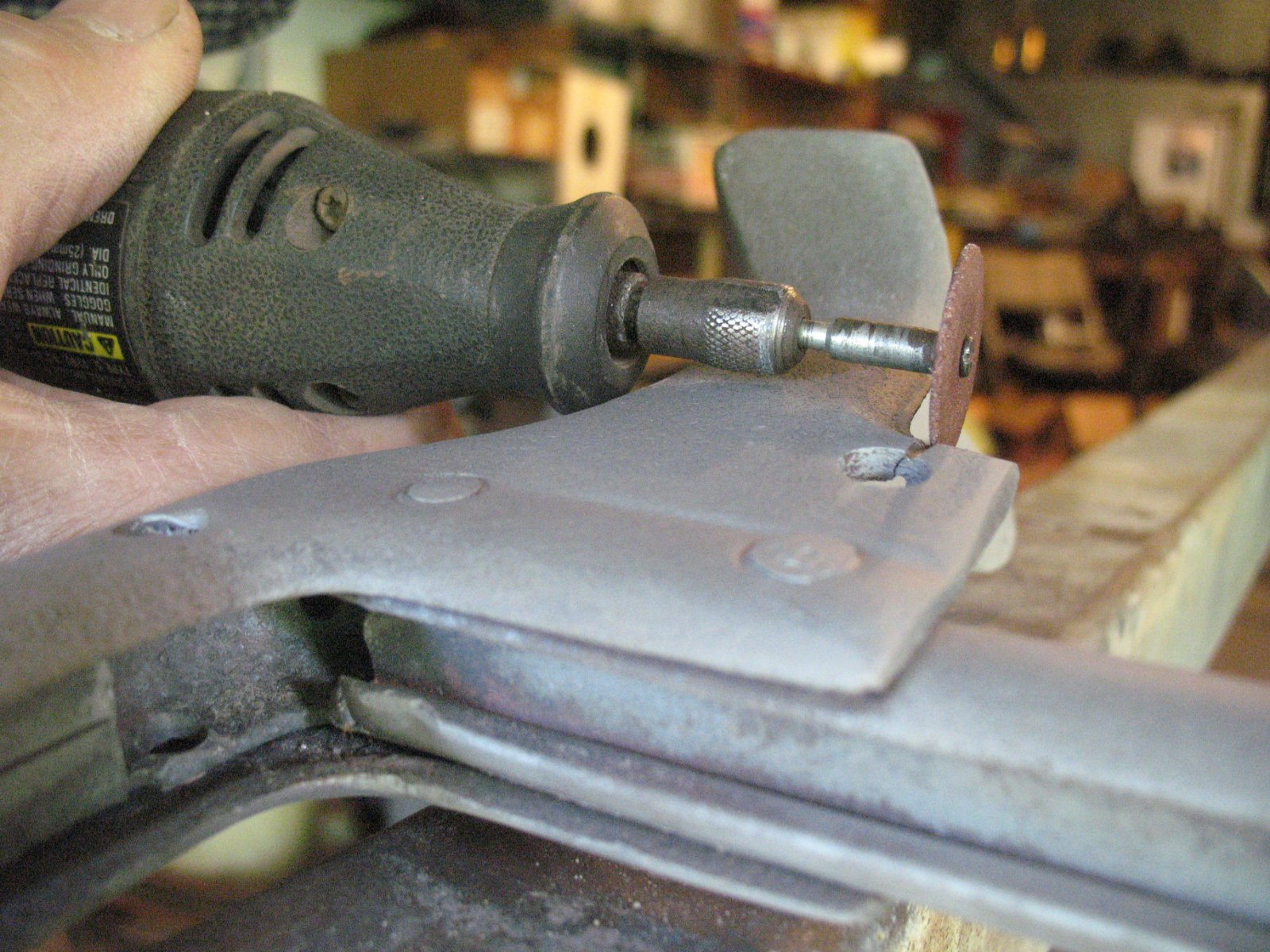

I never posted any T work in May because I didn't do much. Busy with other stuff. Now I'm back in the game, fixing Lizzie's broken windshield. I replaced the broken upright with a piece cut from a junk frame. Did a couple of manifolds while I was at it.
Blasting in the cool of the morning.
Uh-oh... That's not good.
Digging out the crack for filling.
Crack filled.

I've spent most of June on other chores, but just did this bit of Model T work. The patient for this treatment was the pan from my 1923 touring.
Before doing the actual job I had to adjust a frame to the correct 211/2".
There were two problems with the pan arms. 1 The holes didn't line up with the frame holes.
2 The ends angled up off the frame rails so much that I had to raise the front of the body to get the engine out of the car.
It would be pretty tough getting a bolt through that.
Apply pressure with clamps and heat to orange.
Re: What have you done in June 2020
Posted: Sat Jun 27, 2020 12:19 am
by Steve Jelf
Heat to orange, line up holes, let it cool.
Sitting much flatter, hole lined up.
Ditto on this one.
