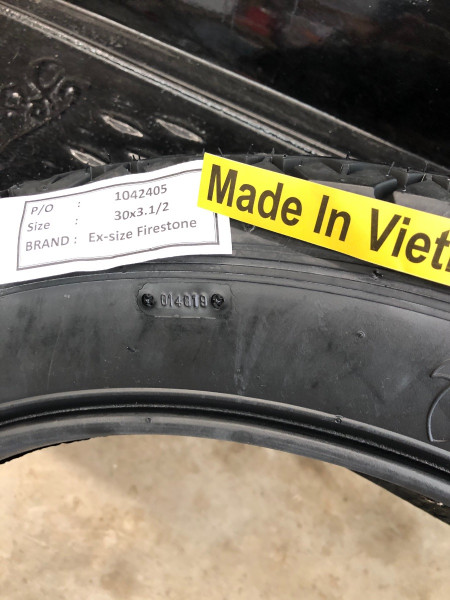

Today just put on a replacement Firestone 30 x 3 1/2 on the '25 touring, the rear tire had sat flat in the trailer for too long, and cracked the sidewall.
I try to jack stand the chassis to keep tires from doing that.
Anyway the new Firestone is a bit larger in tread width than the 1984 Firestones that are on the T, but easy to mount.

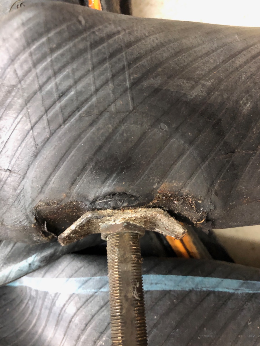

The flat tire also took out the tube, note the circle above and below the brass stem, it cracked the rubber from sitting on the valve stem, so the tube was shot. Replaced it with another brass stem tube from the shelf.
And for those that don't think moisture gets in your tire casing from the valve stem opening or from temp changes, hot to cold, note the corrosion around the brass stem and steel washer, caused by moisture inside the tire.
New Firestone tire

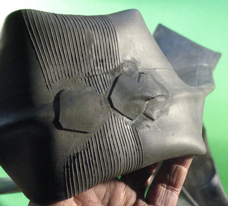

I'm not ready to trust the Indian (Custom Classic) tubes again. According to one of the guys in OZ (Allan I think) there was a run of them folded and packed before they were sufficiently cooled, and they tend to split. Being a slow learner, I patched one seven times before I figured out what was going on. Maybe those are no longer in the supply chain, but until I'm sure of that I'm sticking with the other brands.
Note the patches are all on the fold. Having to patch a split patch should have been a hint.
