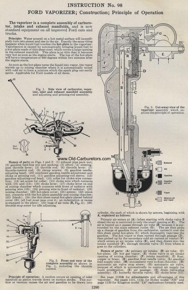

That is the automatic air valve set screw. All of my vaporizer carbs have one.
Ford says the air valve purpose is to automatically control air supply for maximum acceleration. The screw limits the air valve opening.
As near as I can figure it sets the maximum the air valve flapper can open. Screwing it in will effectively increase choke and mixture richness. Screwing it out allows less choking up to maximum air valve opening so a leaner mixture at full throttle and richer at less throttle.
I have never seen directions on how this should be set. I have just fiddled with it and if the car is running well left it alone.
I would welcome hearing a good explanation of how to best set the screw. Also I would like to know the proper screw length as my carbs have come to me with varying lengths and with lock nuts on some.
