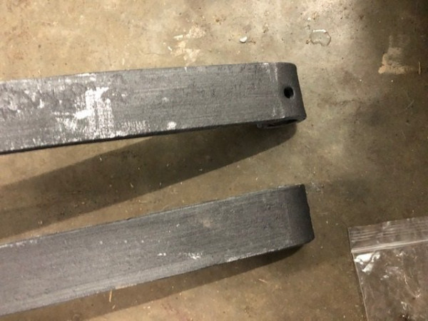

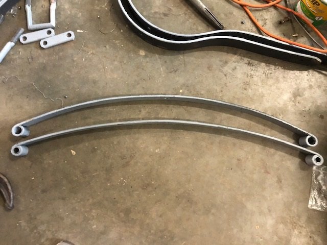

Hi, on the hay wagon to speedster project viewtopic.php?f=2&t=13134 the hay wagon came with what looked like a hodge podge for its front leaf springs including extra leaves. I had a set of early tapered leaf springs from my previous Touring project. So I took them all apart, sandblasted them all. Now I am trying to get a single useful set out of the two. I am putting them back together and rebushing them. So I successfully rebushed the spring on the bottom of the photo with correct new bushings from a new shackle set, when I tried to rebush the upper leaf in the photo the OD is far larger than the one on the lower. None of the new bushings I have are big enough. I suspect that the upper leaf in the photo is not Ford? The lower leaf in the photo successfully rebushed is probably Ford but is it early Ford?

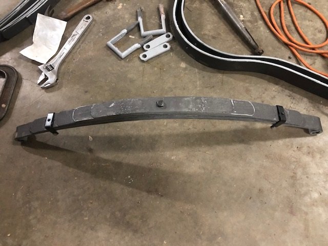

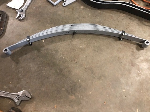

Here is the stack that I think is right for this, 7 tapered leaves. The sandblast place put slip plate paint on but they didn't understand my instructions very well and put it ll over the tops and bottoms even the parts showing.

Ignacio, on our Canadian sourced cars there is one extra leaf which you do not show. It goes directly on top of the main leaf, and is almost as long. It has clipped ends like the later springs, but most I have seen are a little thinner, as though they had clipped a tapered leaf.
Hope this helps.
Allan from down under
Posts: 4408
Re: Not Ford front leaf spring?
Post by Wayne Sheldon » Sun Jul 05, 2020 3:27 am
USA built Ts also had one longer leaf nearly reaching the shackle end.
