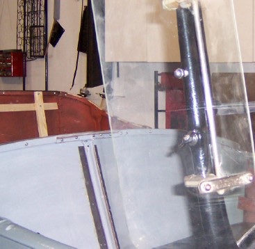

Interesting. Perhaps the storage was issue? Some plastics don't like sunlight. And interesting what plastic strip was used.
Have only knowledge of the FordWood strips, had the chance to remove the upper upholstery from the '27 to add backrest padding and the plastic strip there from 2003 was just like new.
The material is easy to shape with hot air gun, but if you do get aggressive with the heat, that could have an affect? You only need heat to bend and mould with clamps as you go.

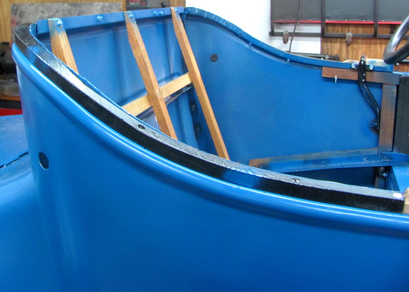

by John kuehn
I used the Fordwood tack strips on my 21 Touring rebuild around 5 years ago. Went back to the shop in my left over wood parts box and had the cut off tack strips left overs. They were in a box in my garage that the temp. Range is from 30 to 120 degrees Fahrenheit. Texas weather. As you can see in the pic I put a piece in my vise and took several licks with a hammer. No breaking this stuff and not brittle. This is my experience with the Fordwood tack strip after 5 years.

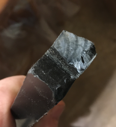

I've had the grandkids staying with me for a little over a month and I let this topic go into the bowels of the Forum. Here is the photo of a broken piece.
First, I have looked all over my shop for the rest of the broken pieces and I am concluding they are now in a landfill. What I did find is one half piece which displays a crack. The pieces cracked at the corner bend and at screw holes. This piece cracked where I had it lapped in the back of the seat. It is no longer bent to 90 degrees and has relaxed while sitting on the bench.
broken tack rail end.png (256.14 KiB) Viewed 5254 times
I am guessing some wil comment that by lapping the two pieces, I set up a stress riser. But it also cracked at the necessary screw holes as well as at the corner where it was bent with a heat gun.

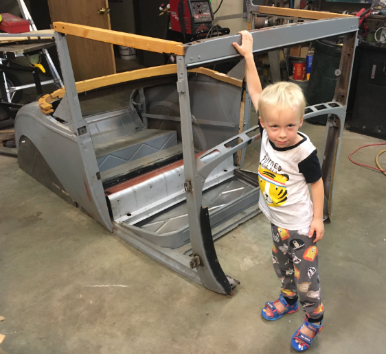

As evidence of the thoroughness of my search for the pices, I asked my grandson with better eyes to help me search. He left no stone unturned.
not upright.png (359.65 KiB) Viewed 5254 times

Your grandson must be from Krypton. He rolled that body with one arm. :o

by Oldav8tor
Tom,
Looking at your photo of the "broken end" what I see doesn't look much like the cut end of the material I used. It looks more like plastic. I wonder if we're talking about the same material? I have a test piece I cut and bent to learn how to mold the material that I'm going to hang up and see what it looks like over time. I'll let you know what I find in a year or so :?
