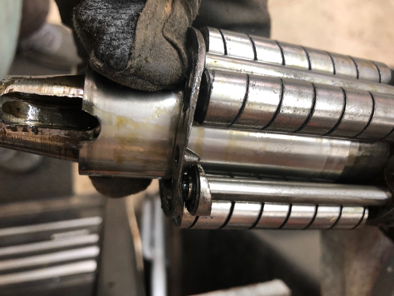

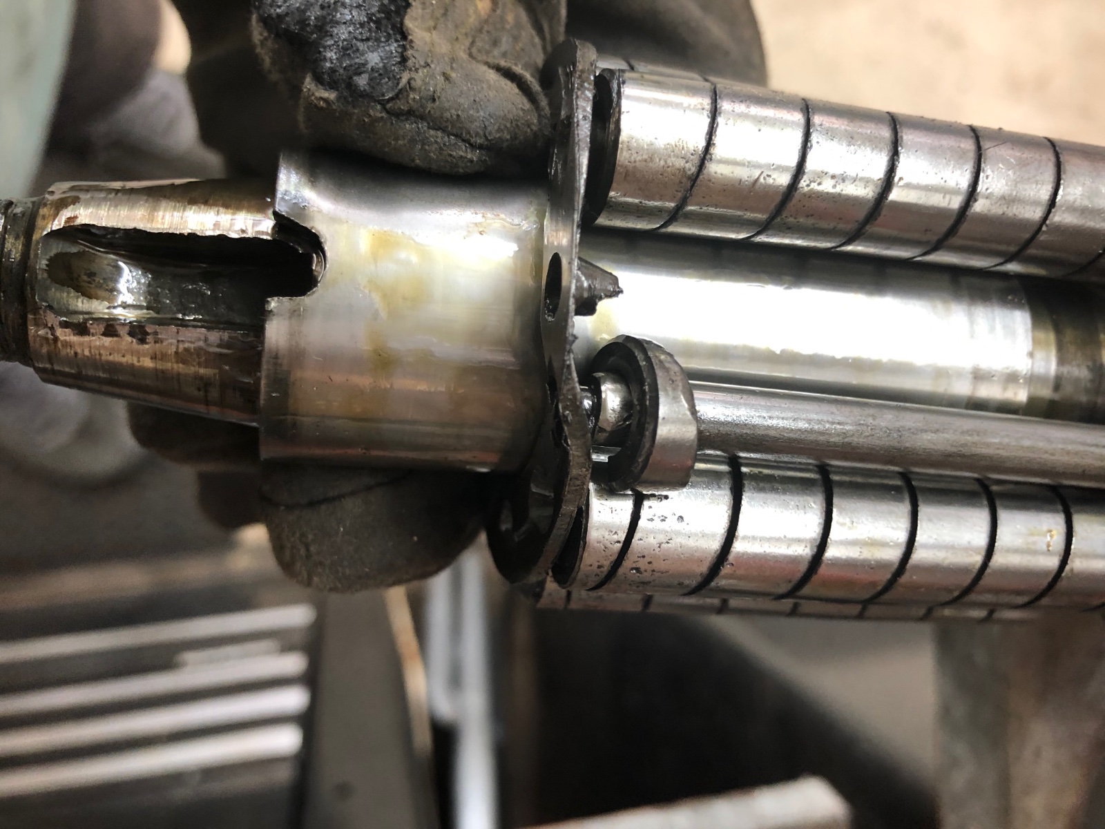

Took apart this one for clicking at the u-joint, after removing from the motor,. The Hyatt pinion bearing was busted, and that caused the sleeve to migrate down into the gear. Found the pinion gear loose on the driveshaft, and it moved both ways, with just finger twist, along with the pinion sleeve, note the excursion of that sleeve, from one side of the key way to the other :o
