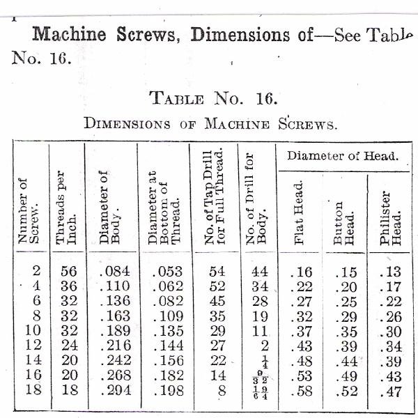

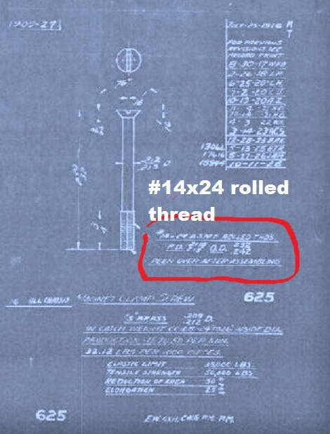

After crunching some numbers, charts, parts books and the famous blueprint I have come to this conclusion: All the parts books from the beginning call for a 1/4" screw displayed as .2 25/32 which converts to .206, a standard 1/4 24tpi would convert to .250. With the screws displayed in the parts books @ .2 25/32 and the standard 1/4-24tpi there is a difference of .054. That accounts for a very loose fit. A #14 is far smaller again @ .182 excessively small. The famous blueprint displays a number that can be interpreted as 14 or 1-4 or 1/4, the display appears to be 1-4 the decimal spec reads max .242 which would indicate this to be a special bolt. The 1/4" thread in the flywheel would be a true standard 1/4" @ .250, the special bolt at .242 would allow for some reasonable clearance about .008. I don't think there is a big mystery between #14 screw, the standard 1/4-24 thread in the flywheel and the special bolt, just forget about any reference to #14. The threads in the flywheel are 1/4-24 and have been that way from the beginning, the screws are special and also have been that way from the beginning with about .008 clearance. Some jobbers manufactured special oil paddles in lieu of the magnets and shipped with the kit 1/4 20tpi to re thread the flywheel to fit the kit. The. jobber has recently converted kit to 1/4 24tpi screws. This means that there are some flywheels out there that have been re threaded with 1/4 20tpi.

with all due respect, David, there is no good place to start to say where you have gone off the rails with this, so will simply post this and be gone. A #14 screw has a basic diameter of .242, regardless of thread pitch, and the Ford drawing says what it says, and that is why 1/4-24 screws will not fit either early flywheels or original starter rings. Only #14-24 screws will. At the time, they were not special, they existed, ASME spec'd and they were the original, correct screw as defined on the drawing (Ref: http://pages.cs.wisc.edu/~bolo/workshop/thread.html courtesy Jerry VanOoteghem). They are "special" now per ANSI standards only because they are obsolete for new design.

Scott I must admit there are many errors in my report, I was reading from the wrong charts. I understand the screws are #14 24 I have an original screw and that is what it measures. 1/4 24 is somewhat larger and would not fit. Some time ago I had learned that the screws were 1/4 24 and I chased the threads, now my flywheel is a clear 1/4 24. I thought I was just chasing the threads however I was removing material and enlarging the threads. There are some issues of concern firstly, a post above makes note about #14 28tpi? There is also mentions of using 1/4 24 tap to chase the threads, this is what I did and I enlarged the threads which now has a very loose fit. The next point, in all the parts books part number 3278 lists the screws as .2 25/32 this converts to .277?? This part number is used through all the series.
Reviewing the blueprint it is clearly a #14 screw, but what is this .2 25/32 = .277 screw in the parts book?
- Posts: 6805
Re: Brass Magnets Clamping Screws
2 23/32" LONG per Ford drawing

I feel so inept but but also enlightened I was so focused with the diameter that the length didn't enter my mind. The period in front of the description is there before all entries and I hadn't noticed that.
It does say 2 25/32 X 24 tpi. All the mystery is now cleared up. For my collection I am going to seek out a #14 X 24 tap, the catalog only lists a tap but not a die hopefully I can find one. My next flywheel will get chased with a #14 instead of a 1/4. Thanks for your patience with me.
