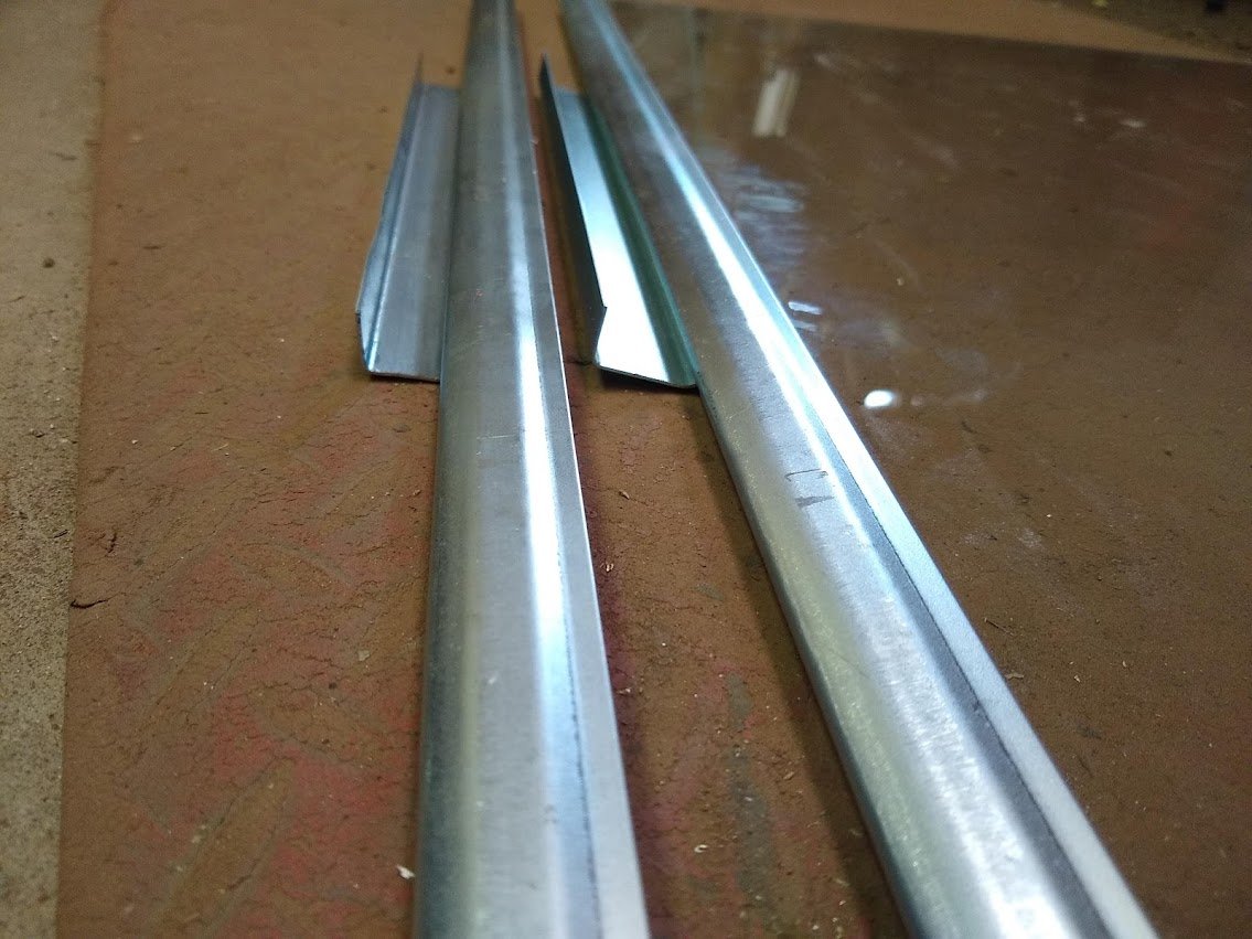

Hi, I finally got door glass for my 27 coupe, and and trying to get it to go up and down. I'm curious what the original channel looked like (mine was gone). Is the reproduction part accurate? it doesn't seem to trap the regulator arm "roller" in it.

That does not look right to me. The 26-27 coupe door is the same as the 28-29 model A pickup door. My experience is the model A door parts are correct and better quality than what most of the model T vendors sell.

I cut off the angle piece that was spot welded on, and moved it up about 1/8" inch, so it's parallel to the glass, and welded it back on. It seems to work now.
of course I cracked the glass taking the channel off....and it takes a long time for folks to get around to cutting glass, around here, so I'll probably just leave the cracked piece in the car for now.
picture shows modified channel on left, unmodified on on right

by jab35
Jim: The window regulator channel on my unmolested, unrestored '26 coupe with original glass appears similar to your modified part. The 'roller' is captive in the channel formed by the glass edge support and the 'L' piece. The 'L' piece is 12.25" long and begins 6" rearward of the forward edge of the glass. I took a poor quality photo that I will send in reply to a message sent to 6 zero 7-five 9 two-four 8 8 two. Best, jb
Re: 26-27 Lower Metal channel door glass
Posted: Sat Jul 25, 2020 12:46 pm
by Squirrel
Thanks for the picture, James. It looks pretty close to what I have, at least the part where the regulator and channel connect, works the same way. Looks like the 26 has a single lower stop in the middle, while the 27 has one at each end of the channel.
