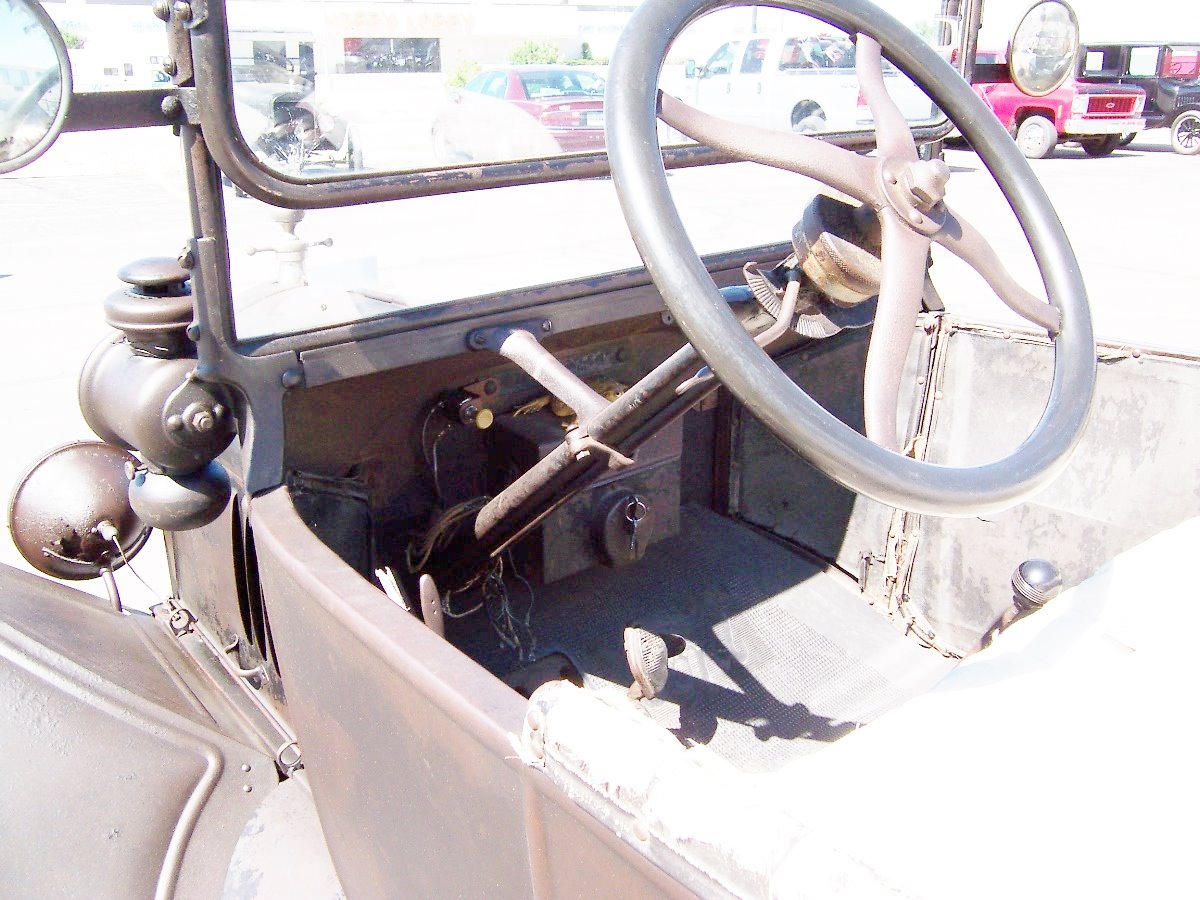

Several of the braces were avail early on, the APCO most famous. Could be had in the curved style for the metal dash, and early straight, usually without the horn tube notch for the flat wood firewalls.
My '23 cutoff came with this farmer made brace, forged in fire with split and added bracket under to wrap to steering column. Ingenious endeavor :)
