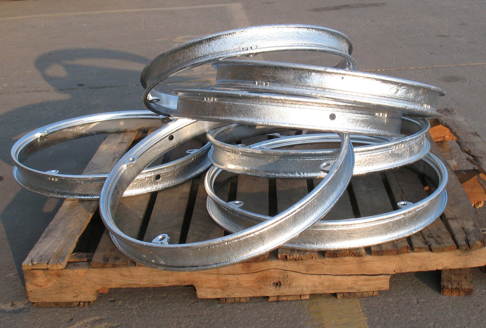

by Steve Jelf
I had my rims hot dipped at the Valmont plant near Tulsa. I prefer hot dip rather than electroplate. The Valmont plants nearest to you are in Ontario and Chicago.

I like the way Steves hot dip rims look. Did you have to sand blast and clean them up first, or did the galvanizers do that as part of the process?

How long do they look like bright like that? I assume over time they lose their luster sort of like a boat trailer does.

by Steve Jelf
galvanize | ˈɡalvəˌnīz |
(often as adjective galvanized) coat (iron or steel) with a protective layer of zinc: an old galvanized bucket.
Coating with zinc is galvanizing. Galvanizing is coating with zinc.
There are two types of galvanizing: hot dip and electroplate. Hot dip is exactly what the name says. The object to be plated is dipped in melted zinc. Electroplate is exactly what the name says. The dissolved metal (zinc) is deposited on the object by an electric current.
Yes, the zinc loses its brilliant shine over time and becomes a light metallic gray.
Modern galvanized roofing nails you buy at the hardware store are electroplated. Their zinc coating is very thin and in a few years they become rust spots. Galvanized shingle nails my grandfather used when he was building my house ninety years ago were hot dipped. Most were unrusted and I was able to use them over.
Here's one of those shiny rims eight years later:
