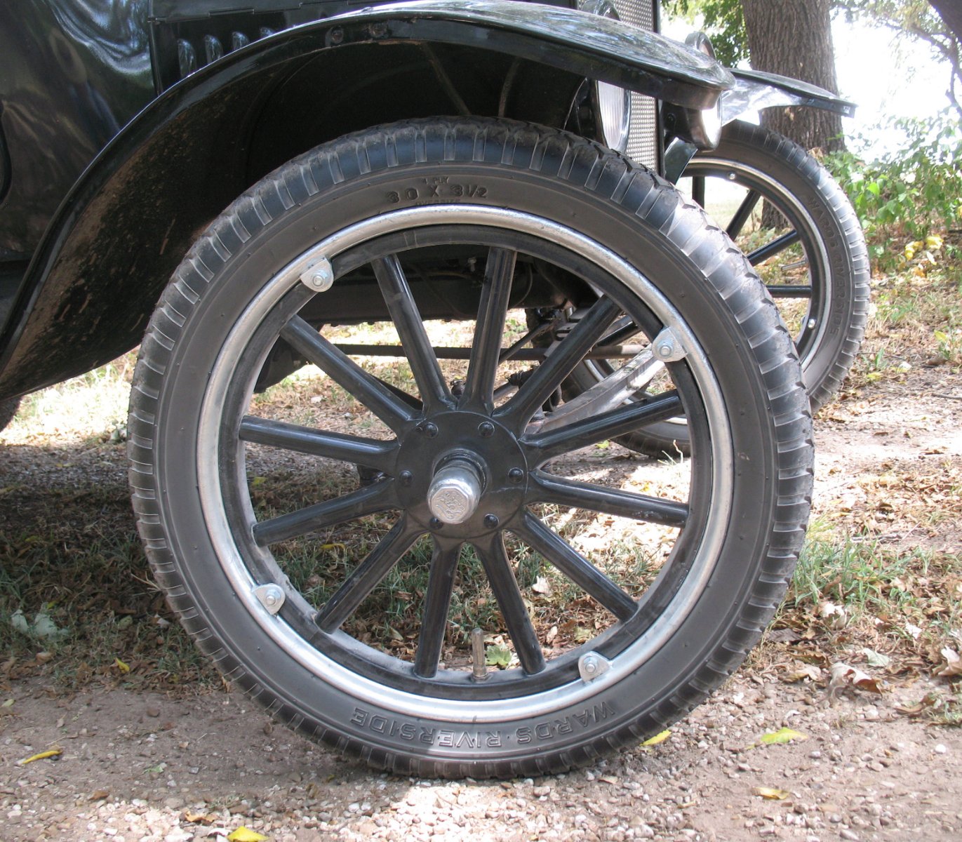

by Steve Jelf
Paste wood filler to fill the grain, then appliance epoxy enamel. It needs no primer.
This was eight years ago. They still look the same.
