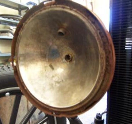

by Vic_alberta_Canada
This is the lights before restoring, also the bulkhead mounted regulator.
